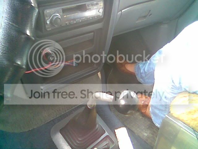

that shifter begs for a Hurst T bar handle

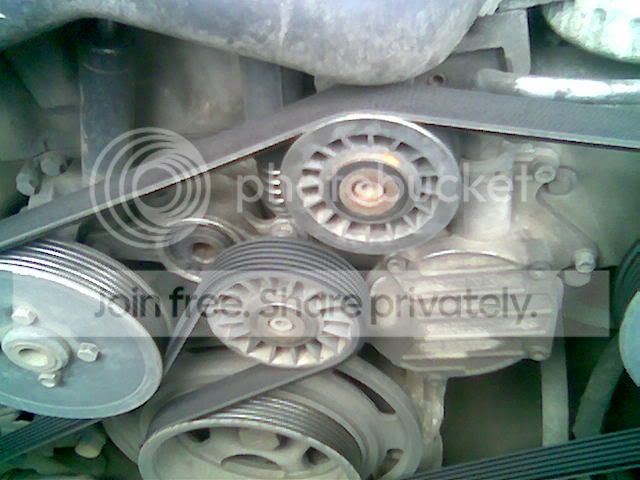

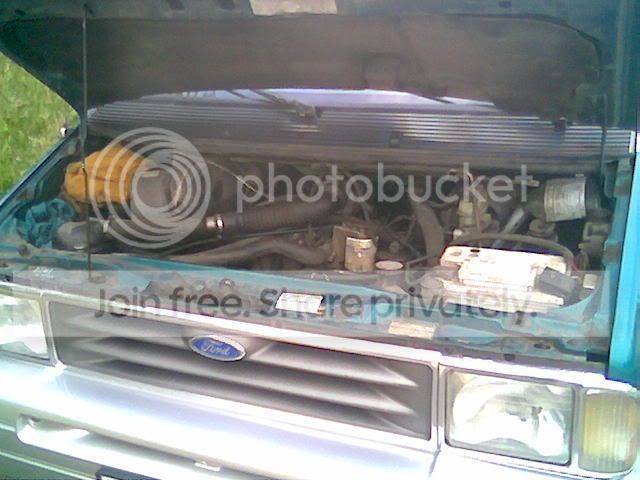

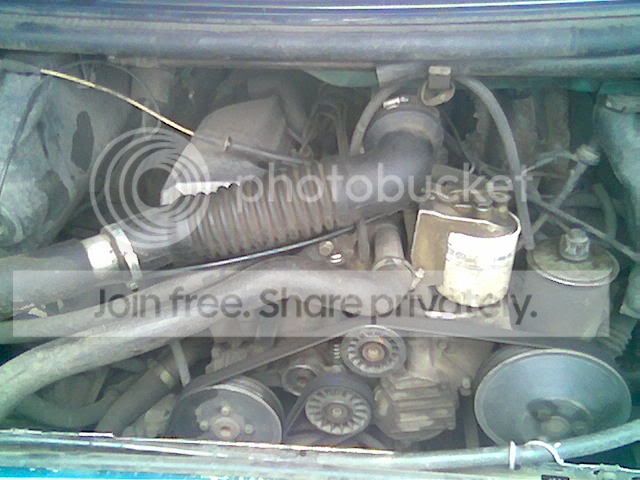

It is 2.4 R4 Diesel. It is engine of short Sprinter, so there is only one turbo, on engine, passanger's side. Intercooller is under the radiator, on place of tranny cooler, electric fan is beyong the grill, so you can not see it from under the hood. You can see PS pump made by ZF, water pump, AC compressor, vaccum pump and tension rollers. There is a fuel filter (white) under the hood.
Oil pan was modified. It was to wide for aero, so 2 pises of metal were cutten out from sides, and pices of alluminium were welded in. The engine was taken in through front with grill removed, but with air intake removed. It was a real surprise, when we understood, that there is no room for intake, so engine ran without turbine and air filter. My friend had to cut pices from air intake to install it!

turbo must be right next to passenger's left foot?
can you hear the turbo spool up and whistle on high boost?
