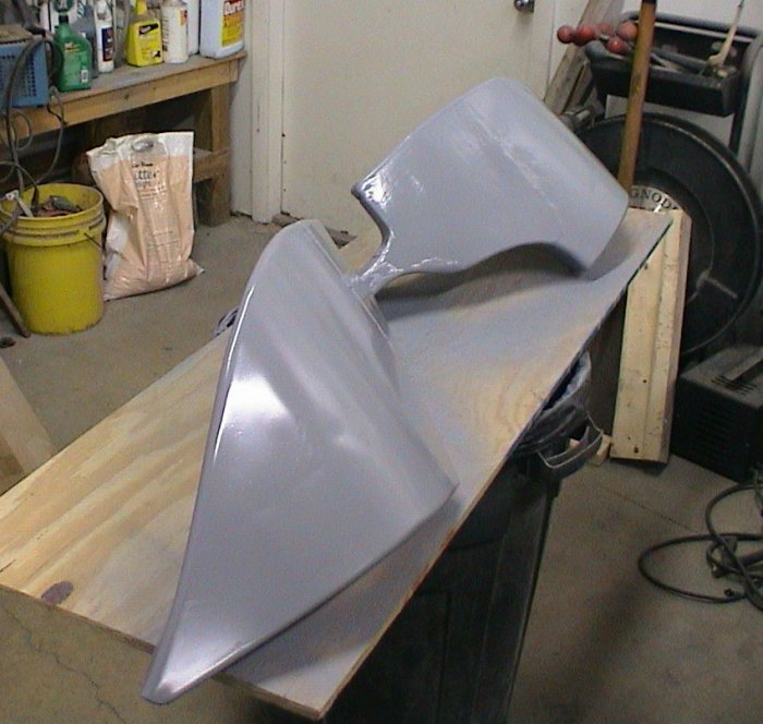

Finished all the metal patching.
During the week we wired brushed rust and applied POR-15 rust encapsulator to the underside.
This weekend we stripped the remaining paint, the little left, and the surface rust, a lot left, and got the parts in epoxy primer.
Next week, if we have time, start filling, sanding and priming.

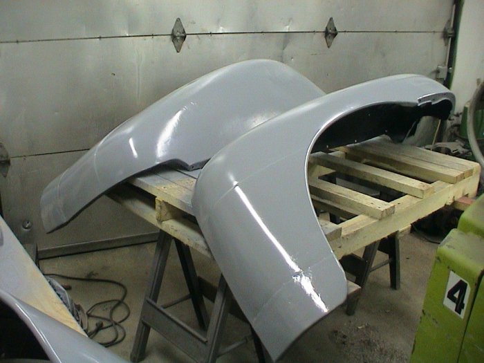

Finally after working almost non-stop for the last two months I took some time out to work on my fenders this weekend. It's been nuts at work, business was just rolling in and I wasn't about to turn any of it down. I grab it when I can because I have been in some real lean times.
Anyways, after working on the fenders Saturday and Sunday I finally got the fenders filled and back in epoxy primer. Tomorrow night I am applying sand and fill primer. Then the blocking starts.

Looking great, Bob! I sure wish I had all steel, in that shape! Are you doing the painting too?

Yeah, I do all my own work when possible. I can't afford to farm it out. I'm going to use tractor restoration paint from the farm supply store, gallon of paint, thinner and hardener -$60. A lot cheaper than the acrylic urethane I used on my F-2. I have used this paint on other projects for the last few years and it holds up really well. I already have the firewall of the F-4 painted with it and it's almost the exact color as my F-2.
