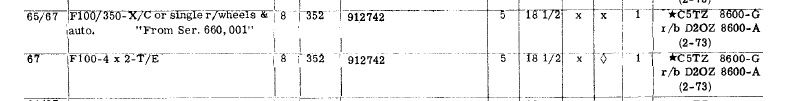

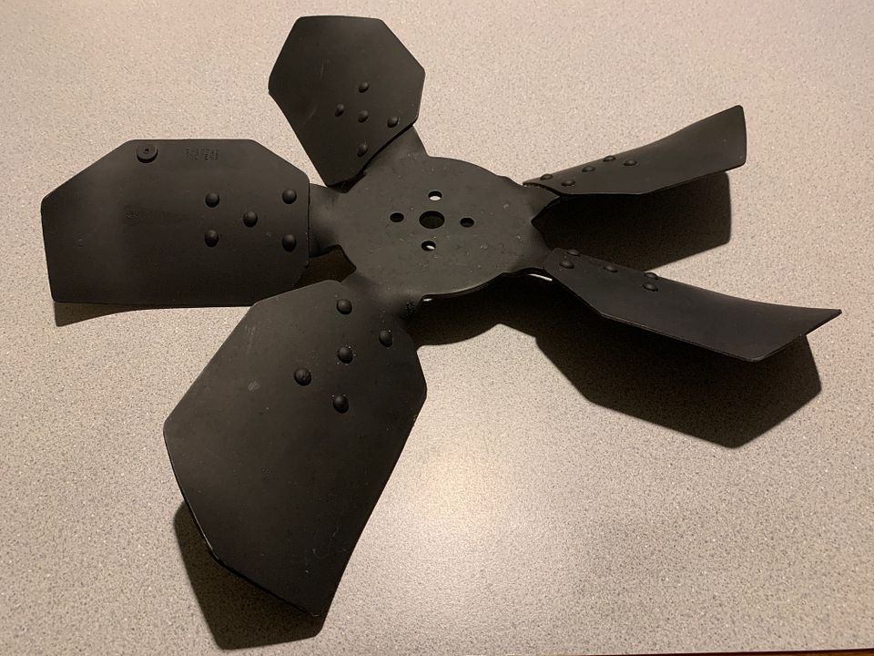

Just a little bit of additional information I thought I'd add. Some of the 1965/67 F100/350 series with 352 and automatic transmission used a 5 blade fan. The ID markings on them are a little different but is noted in the master parts catalog. For 1966 there was even a 6 blade fan that was used with dealer installed A/C. I think @66v8baby is running one of those. Of course, it doesn't really matter in this case since the truck being discussed is using the electric fans.
912742 - this one with a date code of E66 or May 1966. My 1966 F250 Camper Special is a June '66 built truck so fairly late in the production year.
