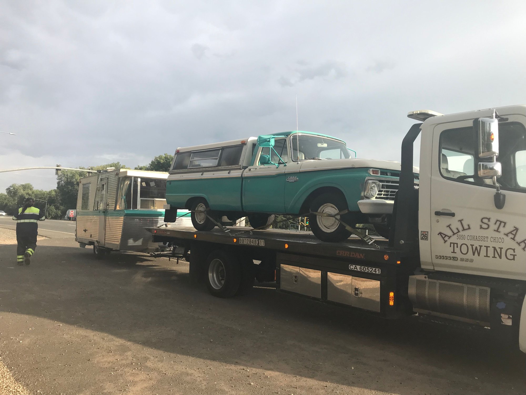

My 66 390 ( newly rebuilt) automatic still runs on the hot side of the gauge when pulling* my 3800lb vintage trailer. I have a newer aluminum radiator with dual fans…installing a g3 altenator, new thermostat 160…all in attempts to keep the truck from running hot while pulling. Would an aftermarket trans cooler be a good idea as well? And if so, which one should I order.
im about ready to give up on this truck that I really love. I bought it to use as my “vintage” tow vehicle about 10 years ago. Extremely nice looking truck in original paint, and interior. Custom cab. The altenator belt was missing once I got her home and we were able to check things out. So frustrated after doing everything I have done to this truck to make it work. I was pulling on flat Hwy when this happened…

Awesome truck and trailer combo!! Don't give up, if she's runnin hot, there's a reason, just need to figure it out.

Do you have a shroud on the fan? I don't think the 160* thermostat is going to help. It will open sooner but once the engine has been running a while, it is still going to be hot. Is your gauge accurate? I would install another temp gauge to see what it's reading and then try running without any thermostat to see what unrestricted flow does.

How is the temp when you’re not pulling the trailer? Can you install an accurate temperature gauge? My truck has always shown to run towards the hot side of the stock gauge, summer or winter, even after re-coring the extra cooling radiator, adding shroud and a seven blade fan. Does your truck have the extra cooling radiator?
I’m told the original gauge is known for being inaccurate. I drive in the very hot San Joaquin Valley of California. I’ve learned to just ignore that needle parked nearly all the way to the right toward the H. Is the needle all the way into the H, or just to the left of it?
That said, being the cautious person I am, I’d not be pulling a 3800 lb trailer with a half ton, automatic truck - though many others do so.You’re also probably running your AC at the same time, no? This is probably exacerbating your problems.
