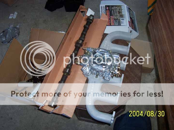

I used the same carb, and it seems to work ok, but soon will be swaping this in :
Old Sep 1, 2004 | 09:10 AM
desperado_18_2000's Avatar
desperado_18_2000
Joined: Jan 2001
Posts: 2,357
From: S. Mississippi
Nice looking bumpstick and carb/manifold.
I've been searching for months for an intake for fairly cheap so i can swap to a 4v.
0270 post some pics in your gallery when you are through with your upgrade.
Good luck!

Yeah.... Hopefully after harvest here I will get the thing together and working. I have efi manifolds on the way... and plan on some head work... not sure how much.... see what the shop thinks. Not going with bigger valves, thats for sure.
