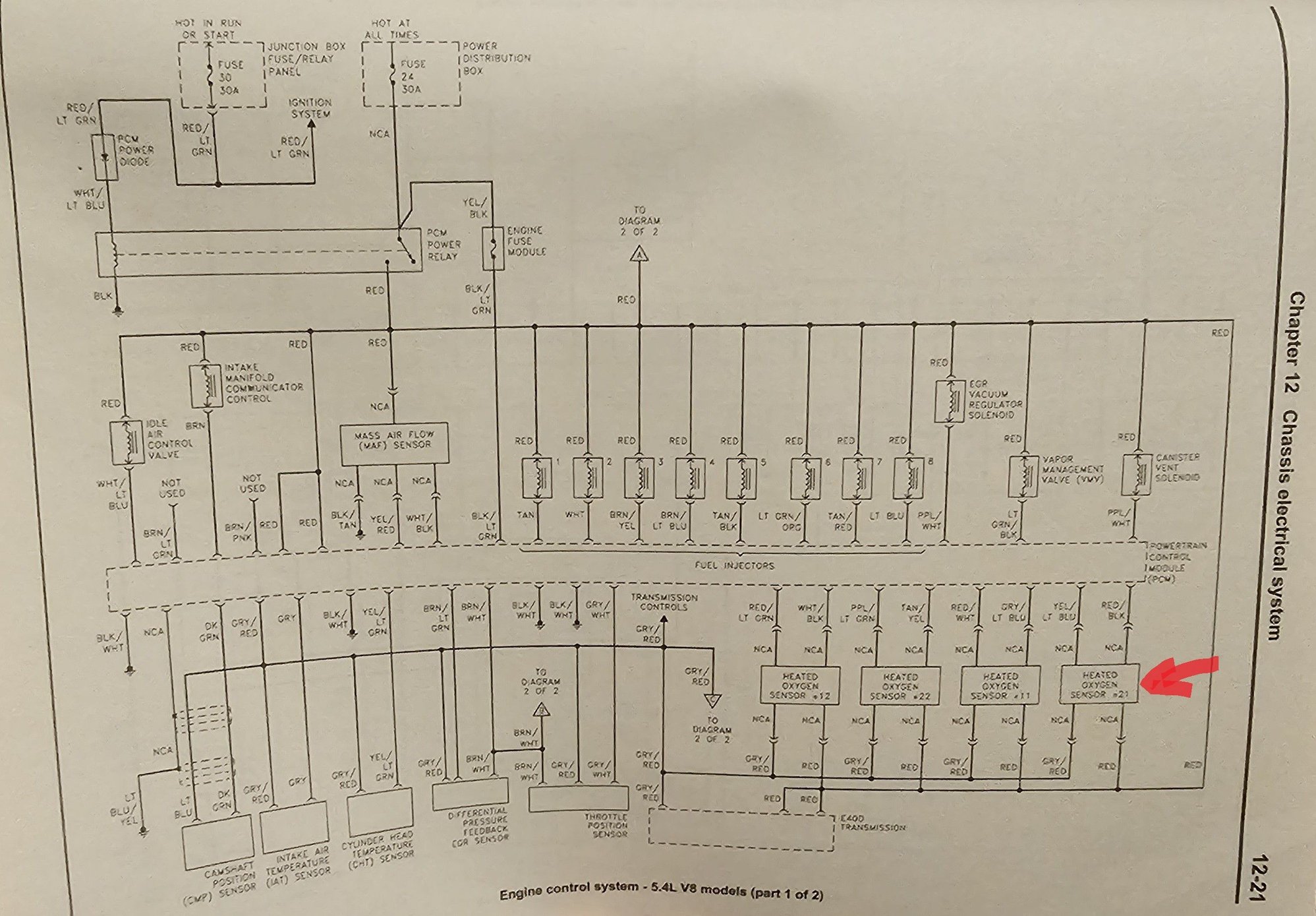

I have shorty headers on whit rear muffler delete, on this bank exhaust manifold doesnt have any leaks, i have used bosch 15717 which shoud be oem sensor, i will have a look at the wiring for heating system of that sensor the last job that i did on that truck was replacing valve cover maybe i have damaged the wiring because wires go around it im just quite bad at electronics, so they are 4 wires on sensor itself on the sensor 2 whites(heater),black(ground) and grey(voltage)??
So if im right i need to measure voltage between grey and black wires?
And amps between white ones?
By looking at the picture i understand that 2 wires shown on schematics go directly into the pcm on the firewall, what about that two bottom wires?
