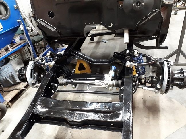

I've don one frame swap and can say it was successful but I would never do it again. You are constantly figuring things out . When you decide one thing you have to think of what it creates 3 steps forward or you'll end up doing things over. I kept the original frame for my F100 pickup and it was a much easier build. For the Mercury M350 I'm doing now I kept the original frame and used the aftermarket for the suspension.
Not sure if you have plans on a lower stance or to keep it at stock height . A Crown Vic will lower it a fair amount so better think of what to do at the back end as well..either way you decide, be prepared to

I had a custom cross member made and went with a lowered stance..

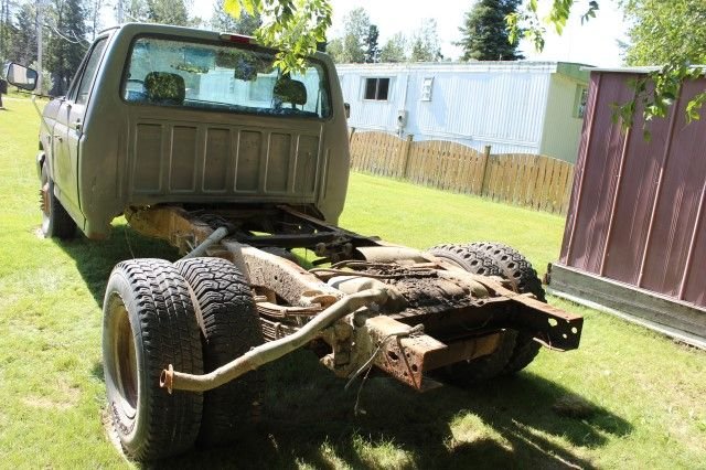

Mine was a single wheel rear end too but used a 1996 F350 cab and chassis DRW

On my Crown Vic I installed a 2x2x3/16 square tube under the front curve of the frame to give me a 3 inch drop.
It gave me a good stance without being a lowrider and made a great spot to bolt the Crown Vic to the chassis.
