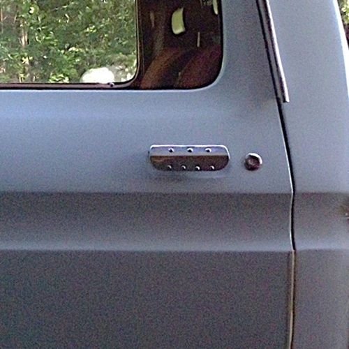

Might get 6 hex socket head SS screws, same length. Maybe bevel the lower half at the ends, to match the angle of top half ends, in reverse. Gonna take them in the shop and add a 3/8" wide strip across the hidden side at bottom to let a person's finger tips grab for the pull open part, better than just slick as is. We'll see.
I'll maybe dress them up sometime, but for now, they work (I mean opening is near totally effortless now). I was gonna use the pitted OEM ones, but then I do have another set of new ones in a box, and these on the truck had one little pit on the passenger side one. Really these are an easy grab, and those 3/16" screws are stainless steel and there are ny-lock nuts hidden. Hardest part was getting the bend straight length wise (didn't really need the lengthwise bend, but it's there now and It does pull the lower edge inward some, in line with the body) and the same angle on both after I got them cut out on the saw, longest time was spent polishing the 1/8" x 2" x 5-3/4" aluminum. I know they are maybe a hair longer front to rear than need be, but that's an easy fix if I decide to change as those screws allow for easy R&R. Also, being aluminum, easy repolish. I don't anticipate it setting in a car show, so if they get noticed ... it'll be out on the highway or in the parking lot at Lowe's, or a gas station pump isle.

I rounded the lower corners 1" radius, added a 3/8" wide, 1/4" thick piece behind the lower edge to aid grip when opening. I used 4 rivets to secure them and the 1/4" thickness let my counter drill slightly larger and the pop rivets are about flush on the back side.
I don't think 1 in 234 drivers will take notice.
In my driveway trials afterwards, I found these extensions to do might near exactly what I was hoping they would do.
I know they don't look big enough to do a whole lot, but they probably halved the effort required to pop the door latch ..... and the start point being lower with the included angle make for better geometry. Works very well to just hook finger tips under the edge, maybe to first joint of fingers so tips end up far enough to far side of strip, then just pull straight out horizontally, all in one motion. No pushing up is even needed. Going bigger would likewise increase travel at the hand in a bigger arc, this is a super compromise in my book. Wife loved it and that is OK too.
One last up close, the blue reflection is that of a covered car with a red plastic carry thing setting on the trunk.
The 1/4" high lip will be a help with gloves on too.

Makes sense on halved effort; you doubled the leverage.
Those look pretty darn good, and I bet the non riveted version cut down and polished with torx pan heads would never get noticed.
Im tempted to do this on mine for my kids. The 4yr old can’t reach yet, but the 7yr old seems to struggle just a bit, and I’ve always wondered what possessed ford to put a lift handle on a 4x4 truck.
Nicely done!!

Thank You for commenting. The shorter one is, the more benefit they'll get. I would guess Ford used them on the trucks because they had them, or at least the new look.
I was going to attach the hidden strip on the back side with J B Weld, but even as confidant in it's powers of attachment, I could imagine a failure over time even though I have no real reason to. I have plenty of stuff to try. Once a set is made, the mounting screws & holes laid out, be a good rainy day in the shop making a revised design. Those two outer screws are 3/16" just 1/2" long stainless with a ny-lock nut hidden, the center one is 3/4" long and since it goes through the center has a washer between the ny-lock nut and handle face. They really did not need the bend, might work better for the 7 yo and soon the 4 yo having the lower edge already out some. My early testing used a flat piece, was fine.
Looking back and forth between the two, I almost wish I had stopped without rounding, etc. .... so might yet be another set like in #7 in the making. No pop rivets, just test J B Weld to bond a grip strip out of view.
