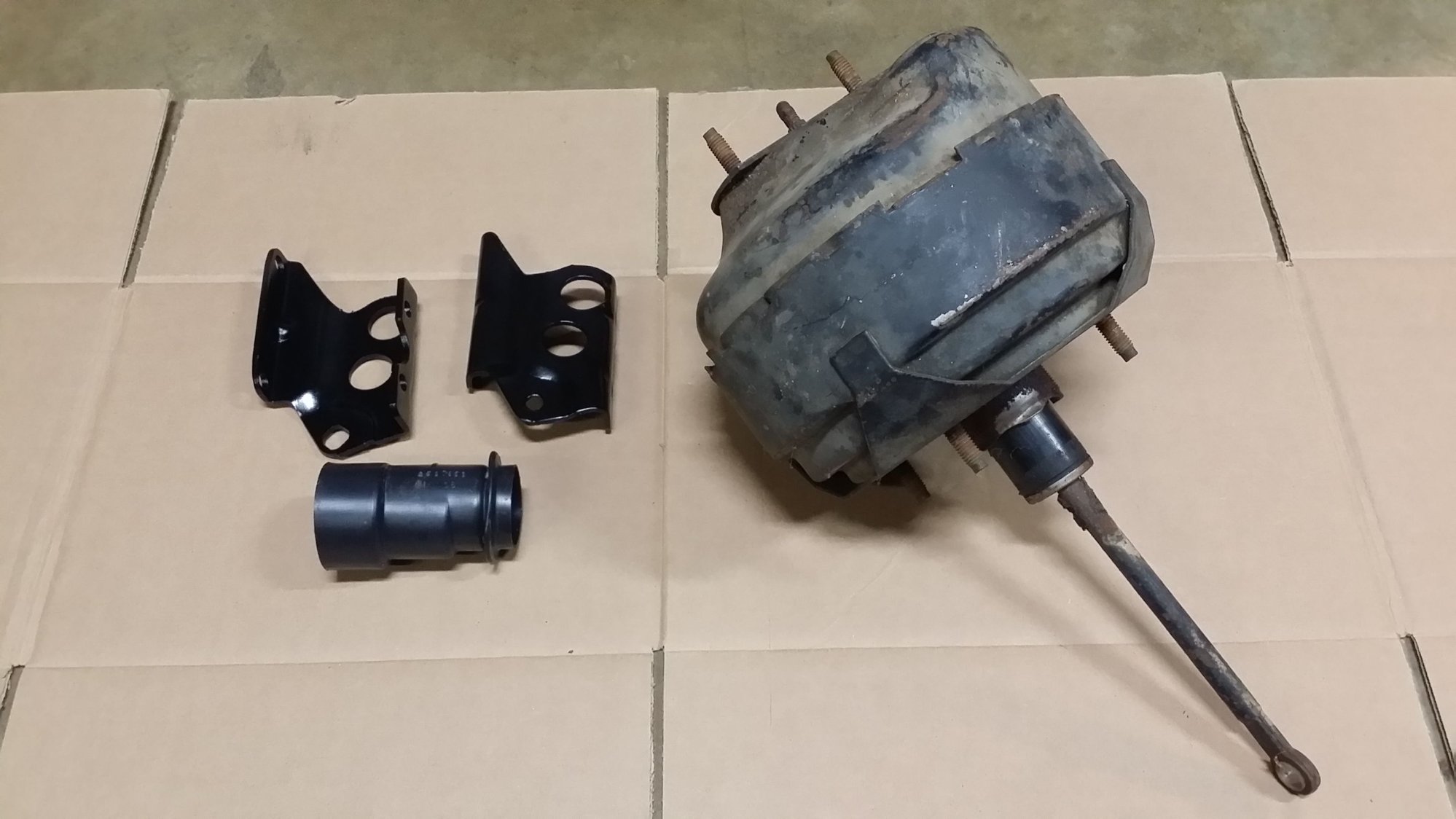

Also note that the NAPA brake booster replacement does not come with the mounting hardware, or the brake pedal rod extension, so don't turn them in with your core. There is also a plastic boot that goes next to the firewall that you want to keep, as there is no source for them except a junk yard. Here is a good picture that shows the brackets, plastic boot, and the pedal rod extension (still attached to the booster).

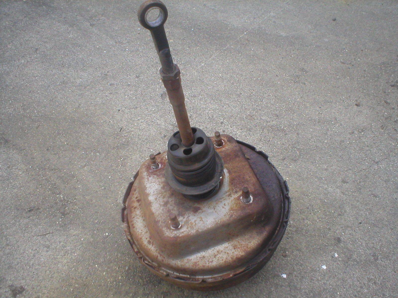

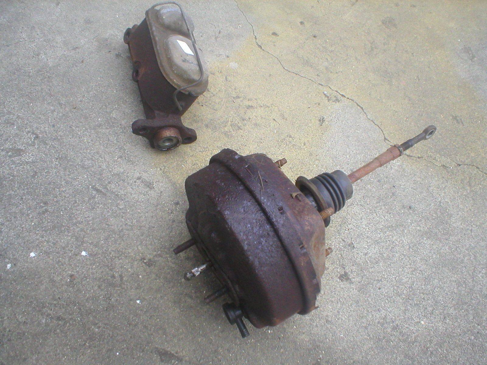

Here are some photos. Not sure how to tell if it is original. I think my first choice might be to send it to be rebuilt as suggested. I figured out the GVW is the maximum truck and cargo/human weight combined. It seems camper specials have different brake parts which are harder to come by, and you have to figure out what models and years might have compatible parts.

Do you know if yours is original? I posted pictures of mine and am thinking just having it rebuilt.

Are you asking me? If so, yes, mine is the original booster from 1979.
It’s the one that is shallower than yours, but of a notably larger diameter.

GreenF250, Do you know if yours is original? It looks different than mine. Maybe if yours isn't a camper special is why as I think non camper specials might be different. I posted pictures of mine and am thinking of just having it rebuilt for a sure fit. Just wondering if mine is factory

The picture I provided with the booster, mounting brackets, and plastic boot is not a picture of my booster, I think this booster is for a Dentside truck (1973-79) as it does not have the adjustable rod. I don't know for sure if my booster installed in my truck is the original one for sure, but I believe it is. Here is another good thread that talks about a 1971 F250 with disc brakes and is a Camper Special. If you look in the thread it has the same part number listed as the one in the NAPA add. The thing about the bumpside boosters is it has an adjustable brake pedal rod vs the dentside not being adjustable. The one thing about getting one from NAPA or O'Reilly's is that the core that was turned in may be from a dentside truck, so you never know. To make sure you get the right one, it might be best to send yours out to get rebuilt. There isn't much difference in my truck vs your truck, as you should have a little more beefed-up spring as it is 8100 GVW. I have the same problems with finding parts for mine. I would change out your soft brake lines if they are original to your truck, as they may look ok on the outside, but they get bad from the inside. I also recently found that Inline brakes make the hard lines for our trucks as well. They make them in stainless steel and OE metal.
