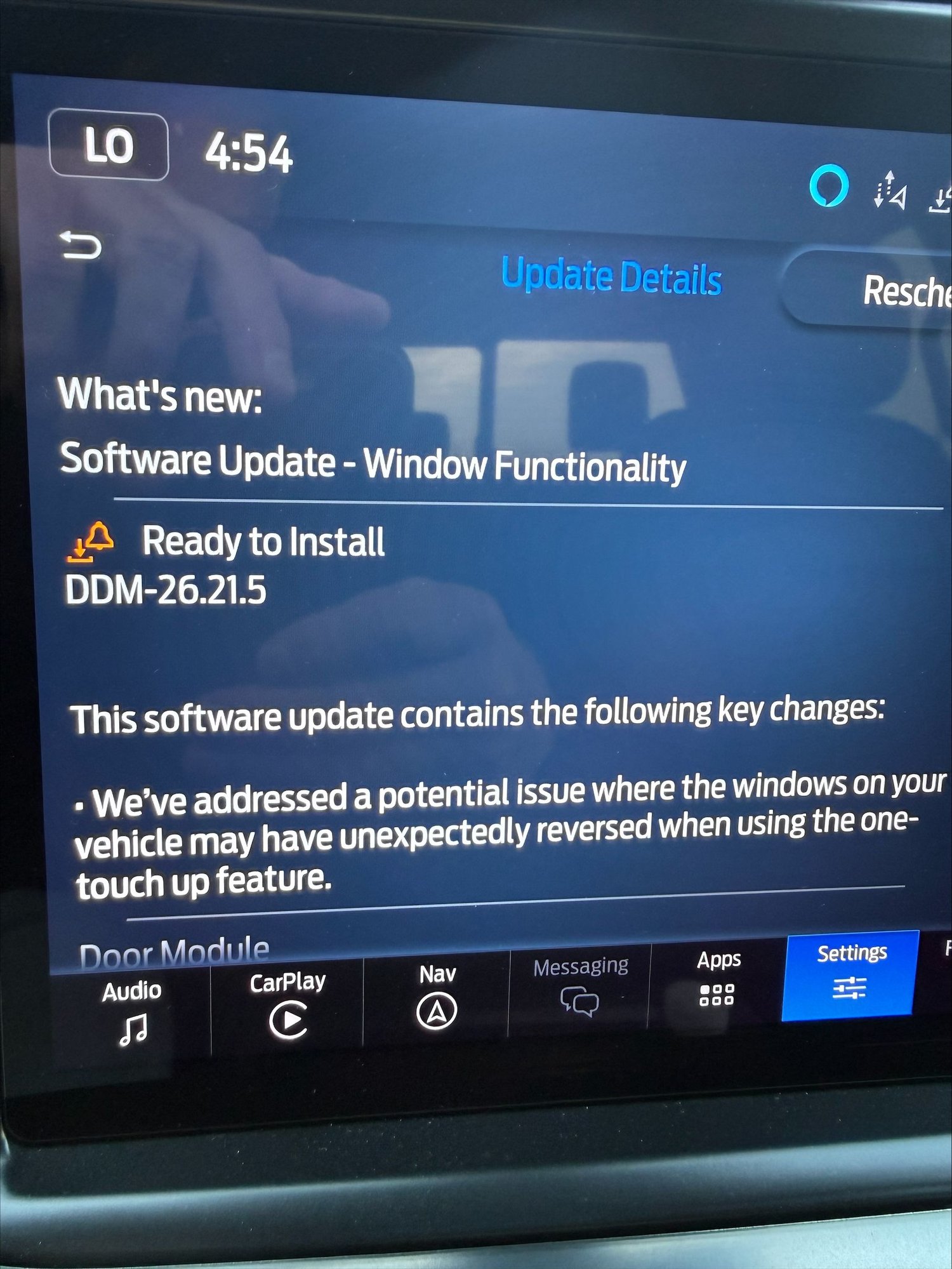

I've never experienced this window issue personally in my 2026, but I've read about many others having issues. Looks like a fix is rolling out...?

You'll get 2 of these, DDM for the driver door module and PDM for the passenger door module.

I've had it happen a couple of times on a 2023. Found a relearn procedure online somewhere and used that. It worked.

Mine WASN'T doing it until this spring, when it started doing it. When it does bounce back, it doesn't want to re-learn the 'up' closed position, until walking through it a few times.
Just did it again yesterday. No rhyme or reason to it doing it.

My '26 did it a few times when I first got it. Did the re-learning thing, and was good after that. Just did the update last night.

I got the OTA on the door module last night and no problems yet. I remember when I was a Cadillac Tech. and the programming in the dealership started back in 2000 and it was a nightmare at first. The first ECM I had to program would not program and bricked the module. I called techline and was told to keep trying new modules until I got one to program and I thought expensive but got one to on the third one. This OTA stuff is awesome. Steve
