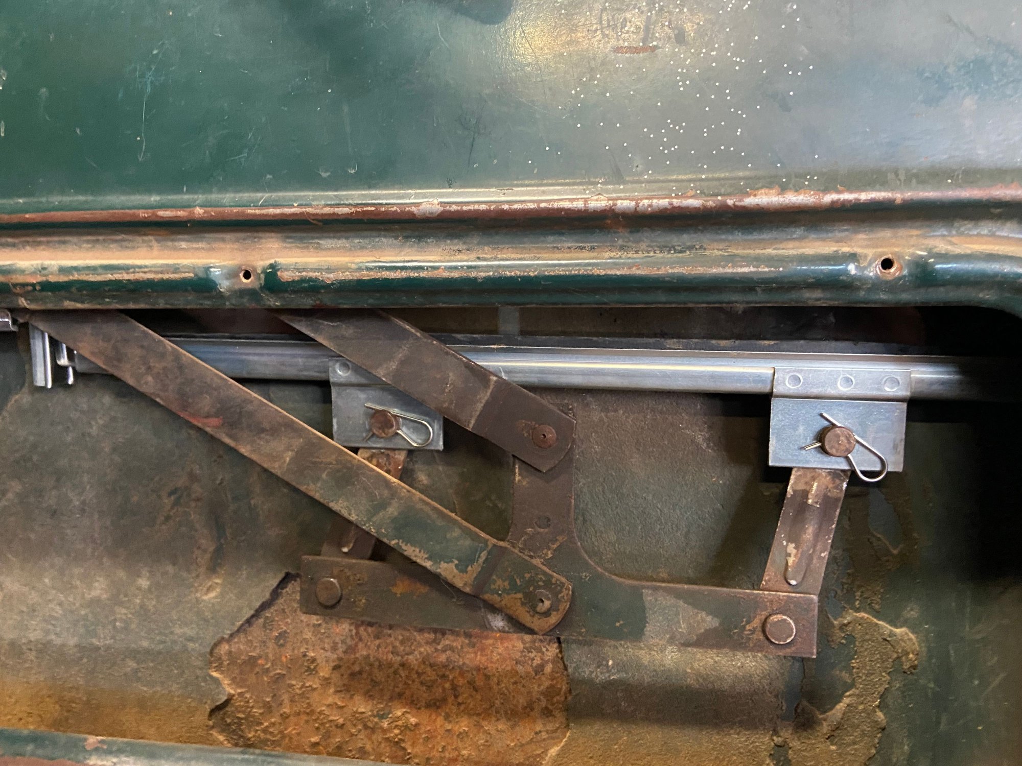

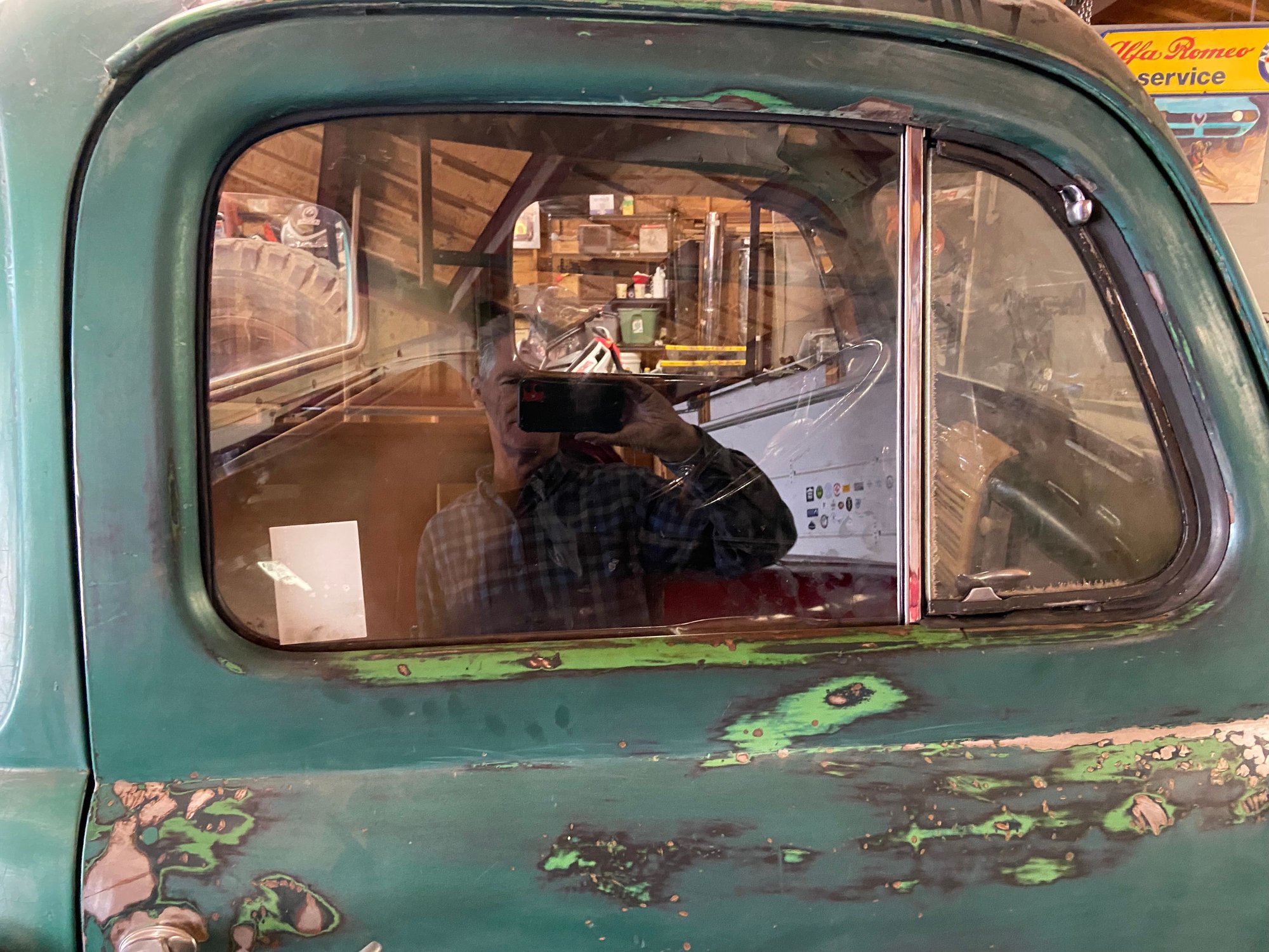

I finally got around to replacing my passenger window which was broken when I bought the truck. Cut off all the silicone a PO used and installed all new weather strip.
Had issues with the vent window and the 16th/in tape. No way I could get that to go in and I didn’t want to break anything. So I ordered thinner tape. A bit frustrating at times but straight forward. Now on to the drivers door……

Please share the secret to getting the glass installed. I am struggling trying to get the glass into the door of my 51 five star.
I just can’t seem to get the glass to fit into the bar and fuzzy channel.

Glass goes in from the bottom of the door. . Front channel bar is left unbolted at the bottom, raise the glass up ensuring it is going into both channels. Hold the glass up, I used a wedge of wood. Now install the bolts for the front channel bar loosely then lower the glass and attach it to the winding mechanism. I then raised and lowered the window noting the position of the front channel bar and when I was happy with the location I tightened the bolts.
Hope this helps.

That’s what I have attempted-its almost as if the channel frame is at a weird angle, Might just be too tight with the new felt channel and the tape I have in the bar?
did your glass go in the channels freely without objection or was there a bit of a fight?

The hardest part was lining it up with the channels. As you say the angles are weird. I put it in the back channel first, moved it about half way up then as the front channel was loose I was able to get it in there.

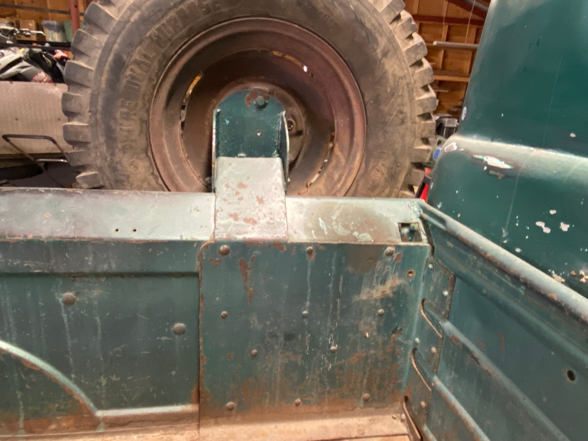

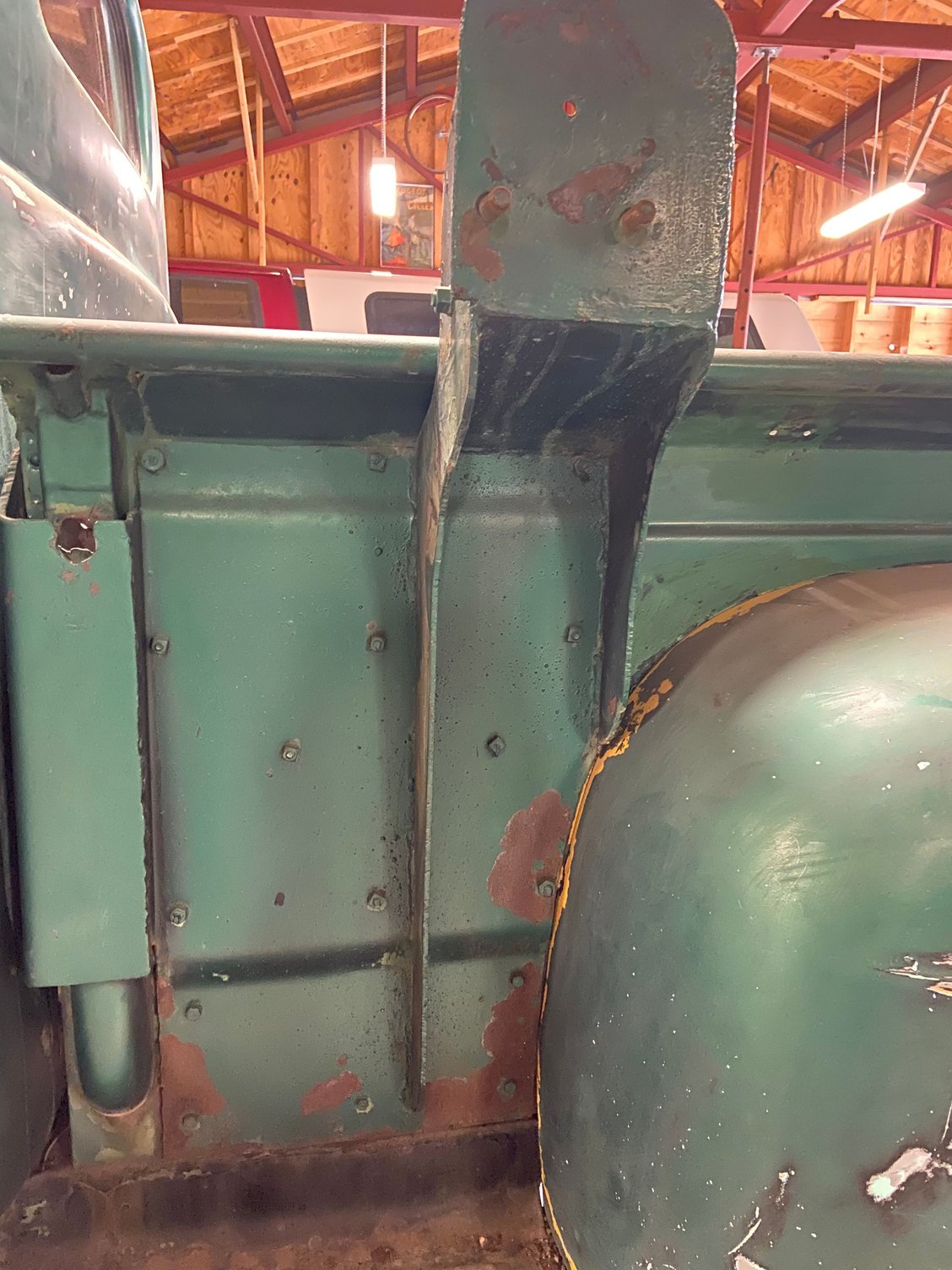

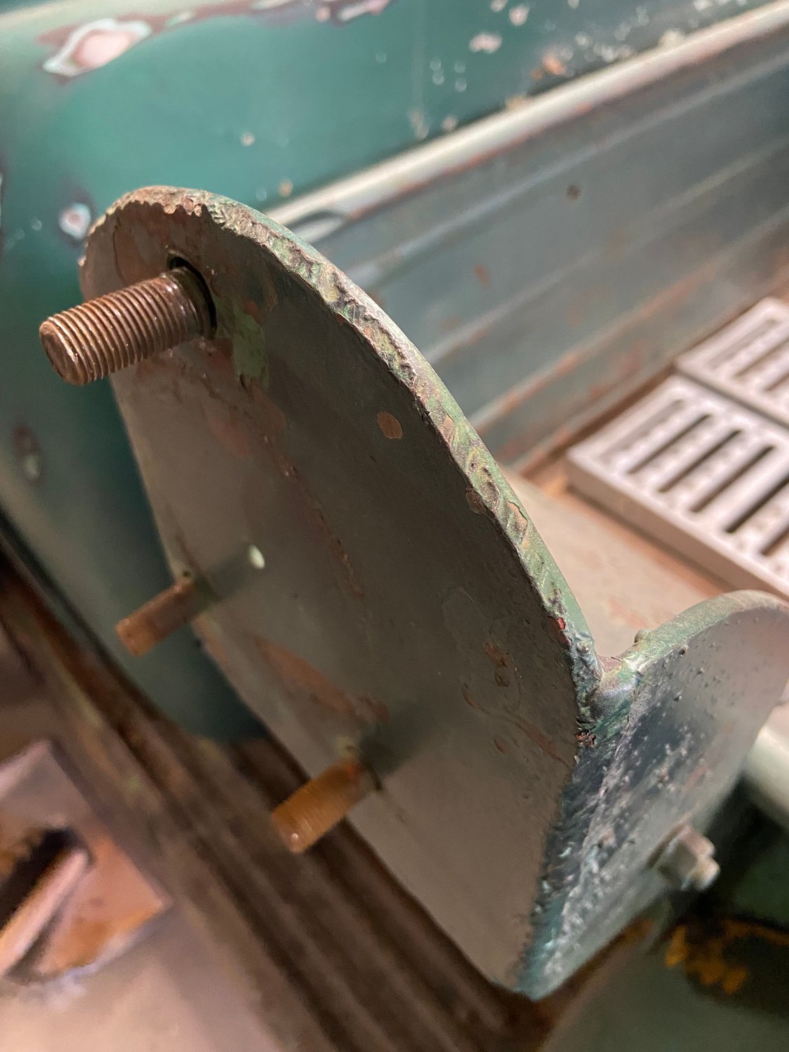

Interesting solution your spare tyre fixed at body side and not at botton.
Please photo details.

I believe it was homemade a some point judging by cuts. However definitely not under built.

Holy cow, the guy that built that was serious. That's not going anywhere.
