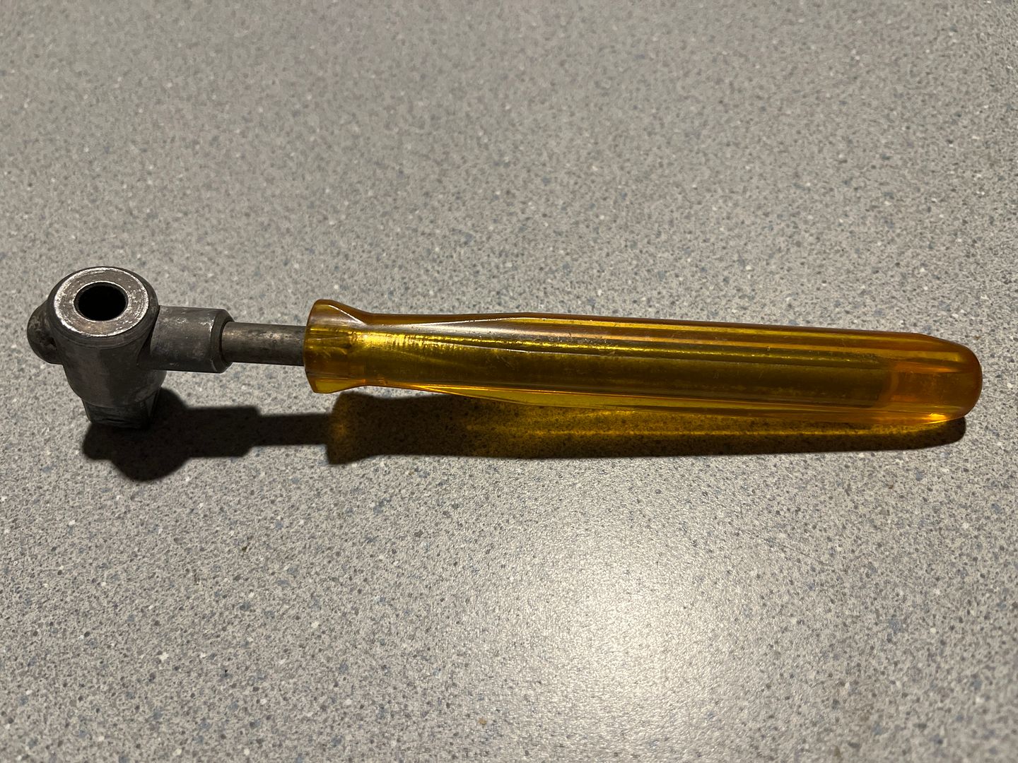

MX COM only has a front band and a rear band. No intermediate band. The rear band is the low/reverse band, and the front band is the 1-2 shift control. The later C4 and C6 have intermediate bands.
There is a hole in the floor with a small cover on the automatic trucks that is used to adjust the rear band.

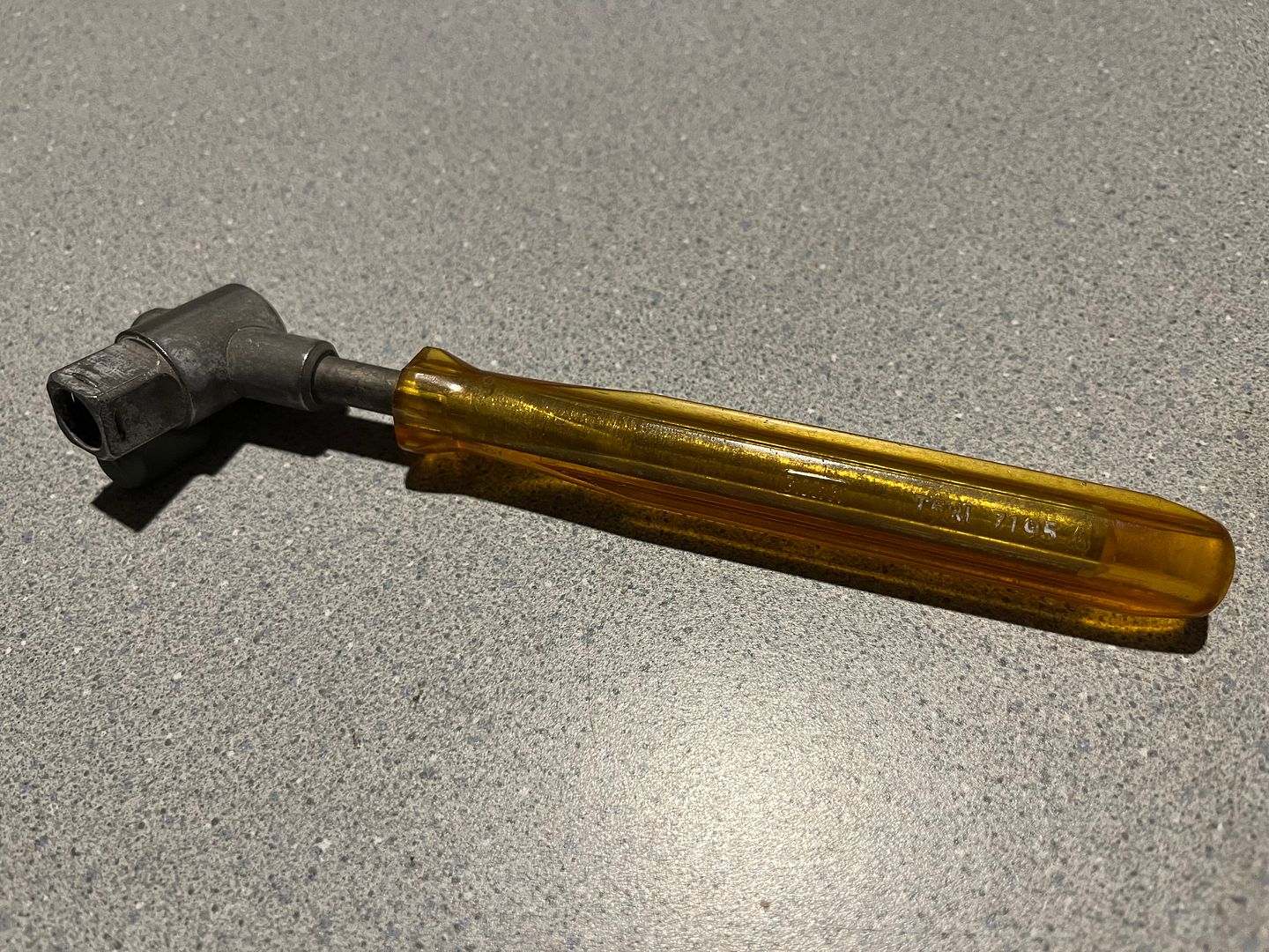

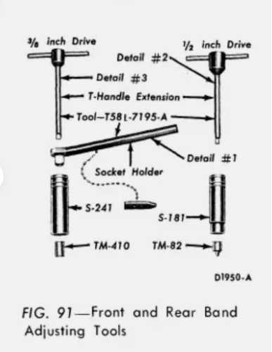

There is a specialty tool used to make the adjustment - the T58L-7195-A shown plus a torque wrench, T-handles and some sockets.
Pictures of the FoMoCo tool T58L-7195-A - this one with a more comfortable handle.
