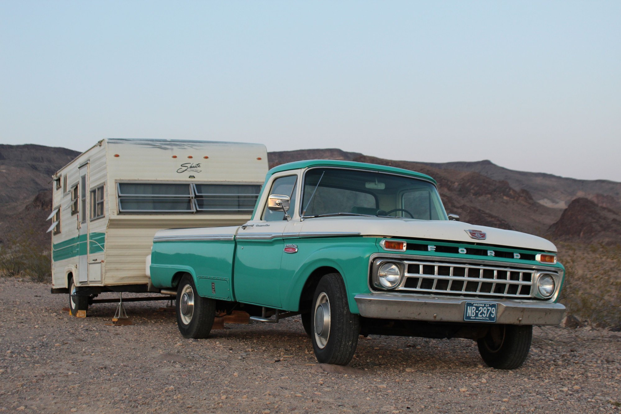

Have been periodically posting updates in other threads showing the rebuild of our 1977 Shasta M1750.
Having tons of pictures, figured the time has come to start it's own more detailed thread.

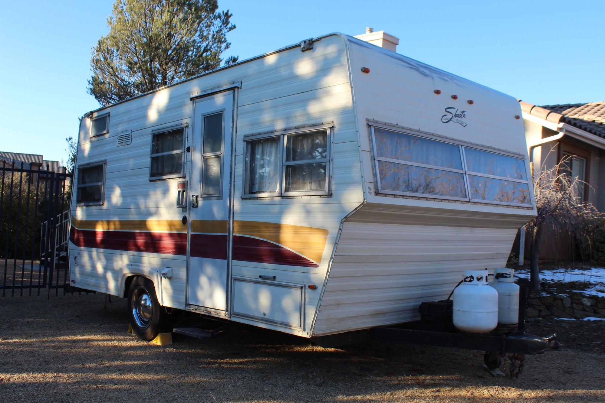

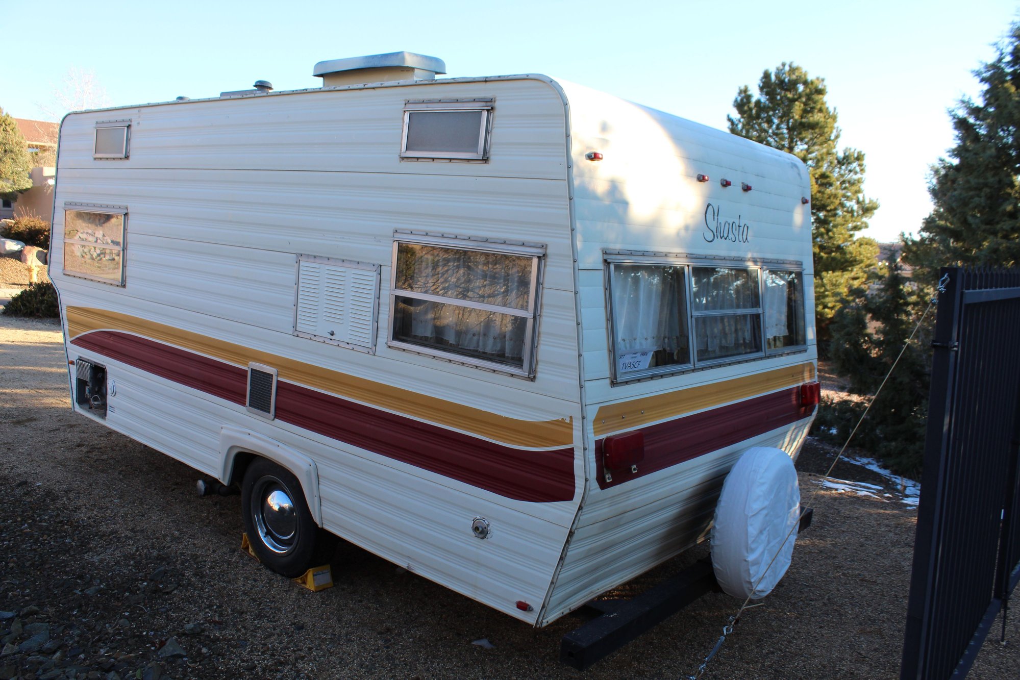

We took ownership in January of '22 and planned to do a bit of updating to make it roadworthy and more comfortable for me and the wife. Wasn't looking to do a major reno and wanted to keep things within a tight budget. Just wanted something decent to drag around with my '65 3/4 ton. Boy were we in for a treat.
Here it is the day we brought it home.

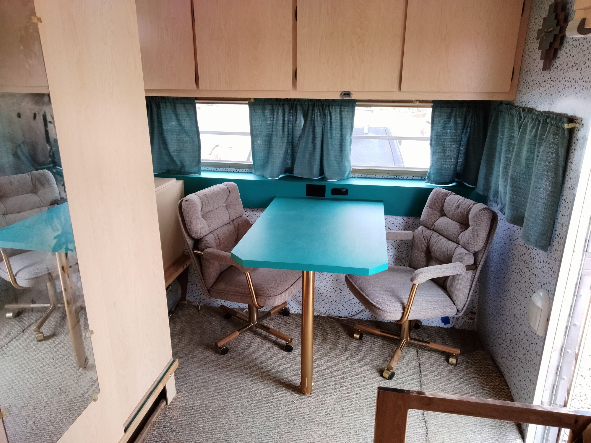

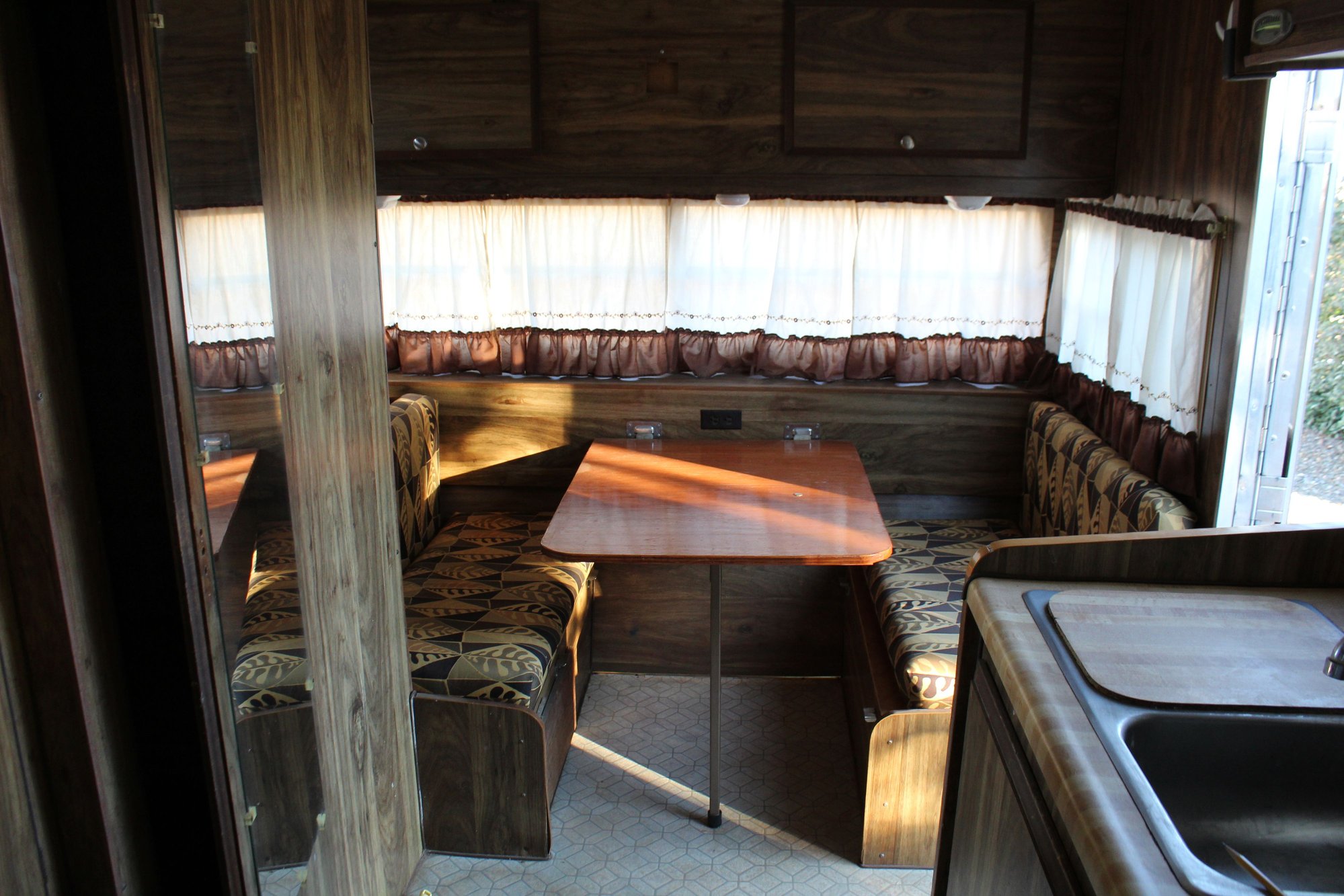

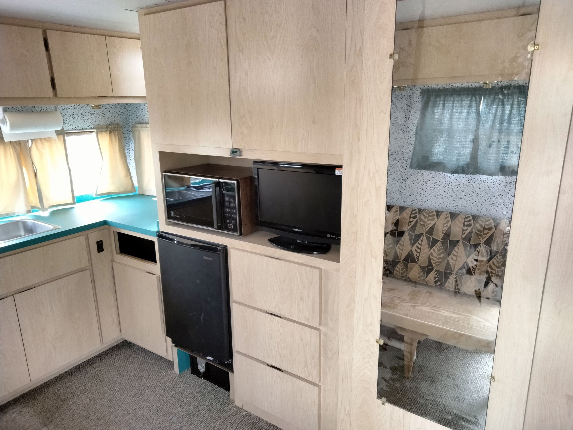

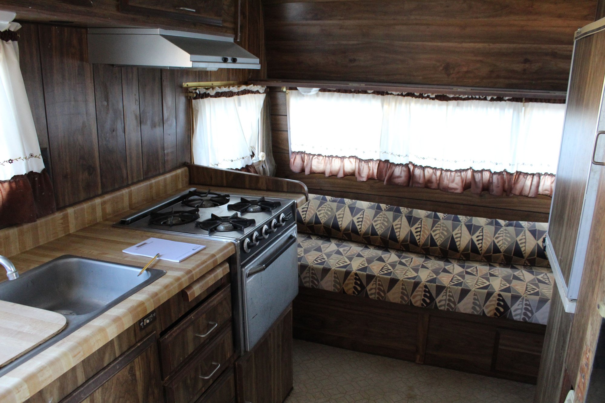

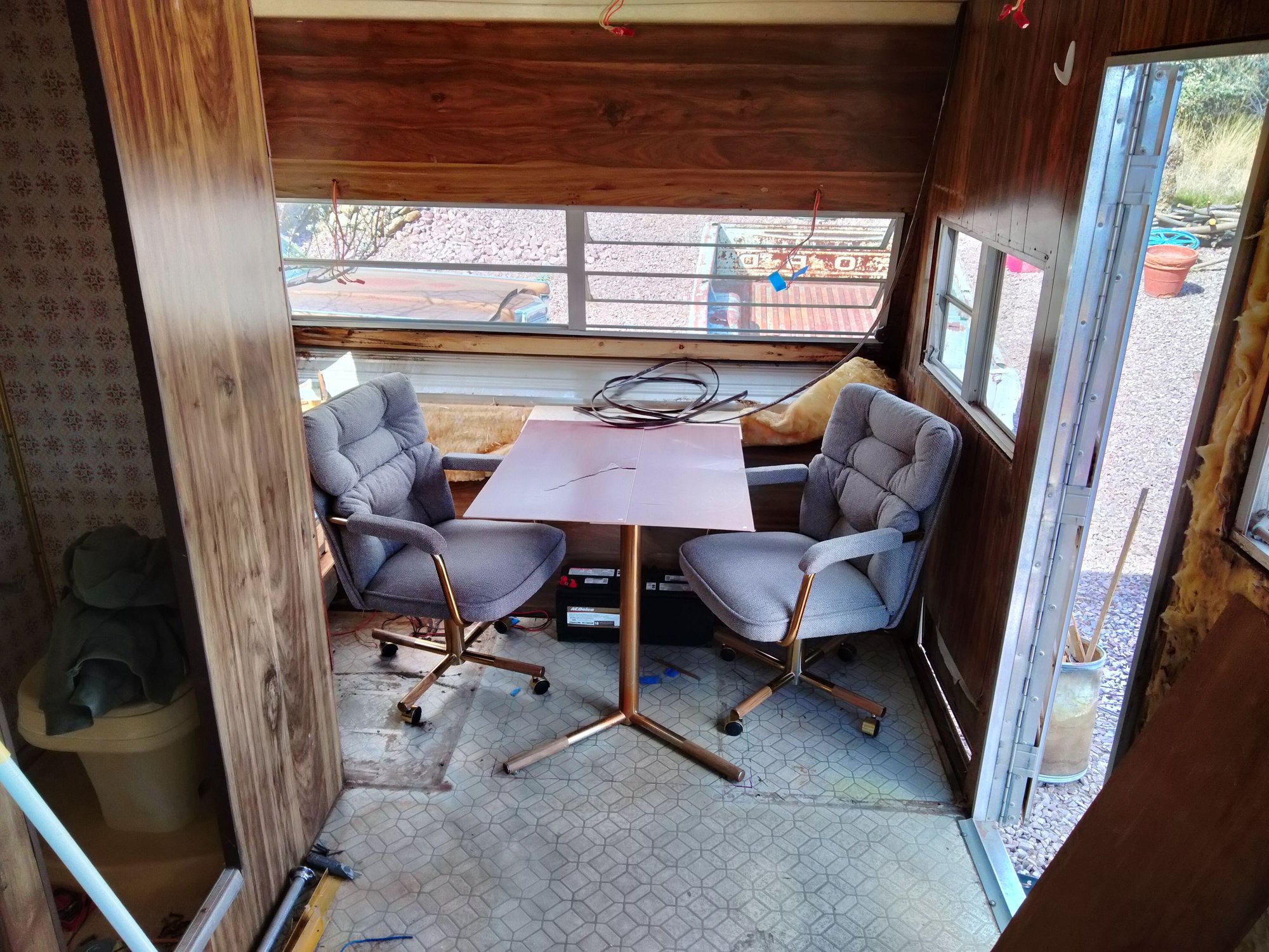

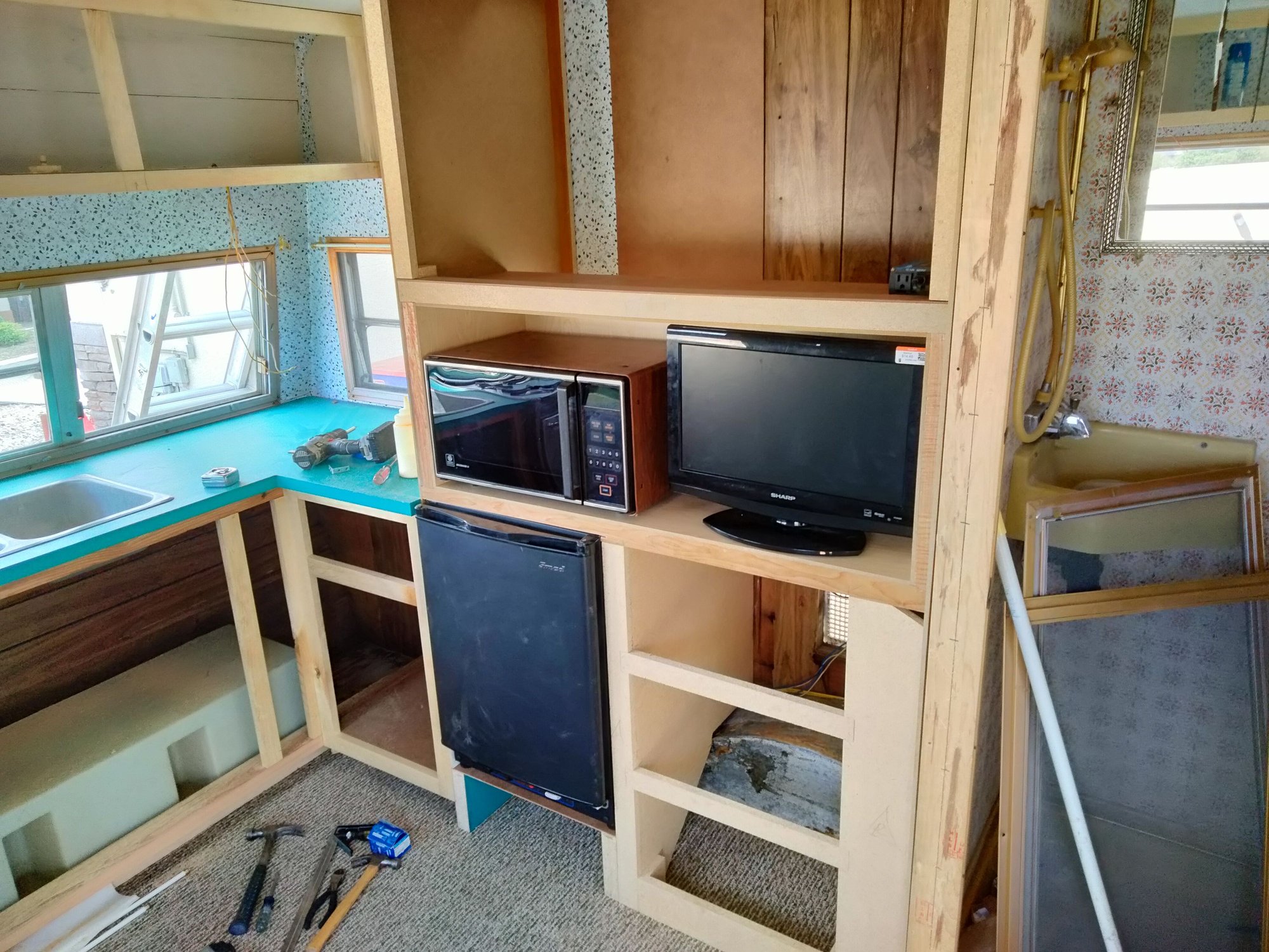

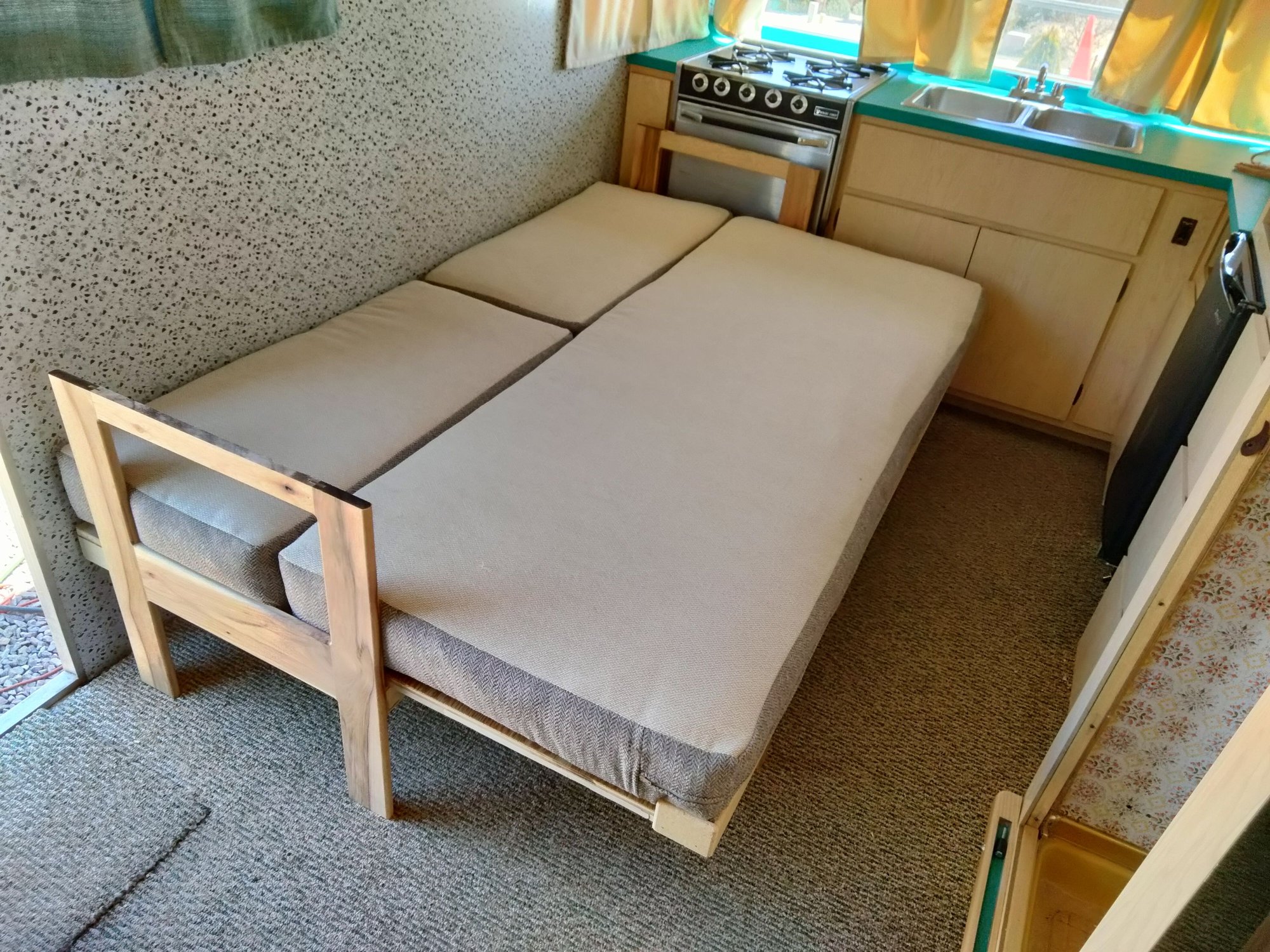

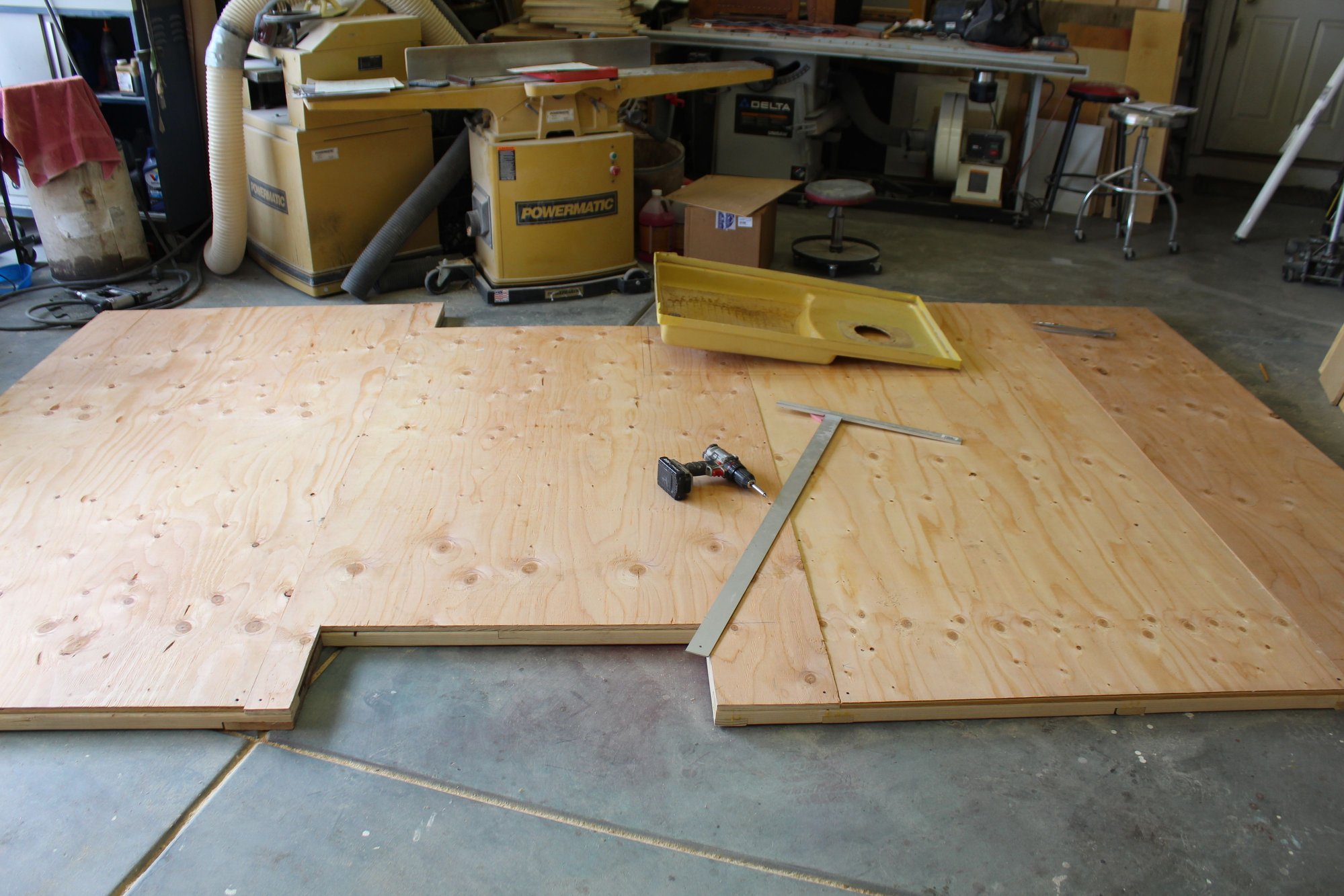

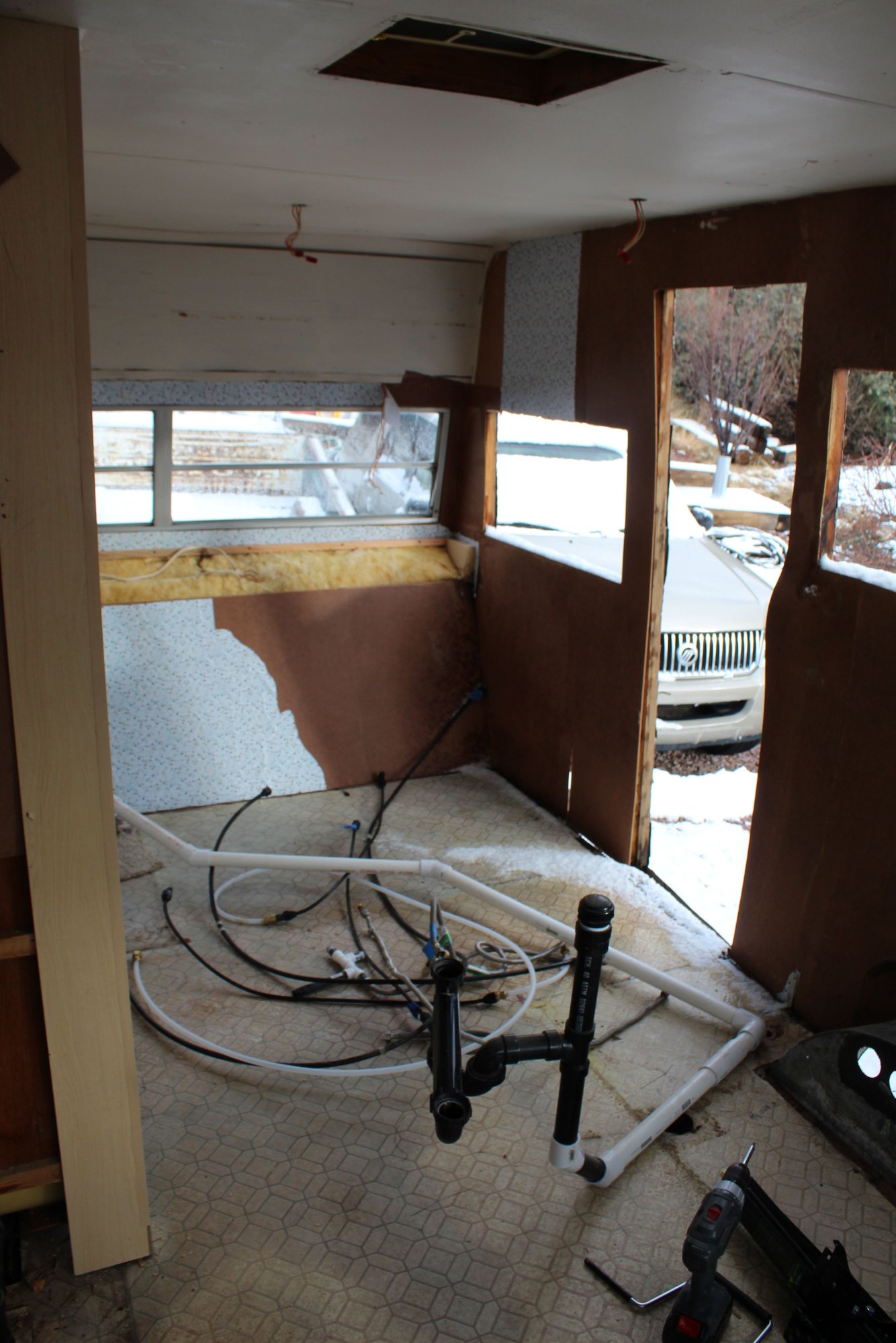

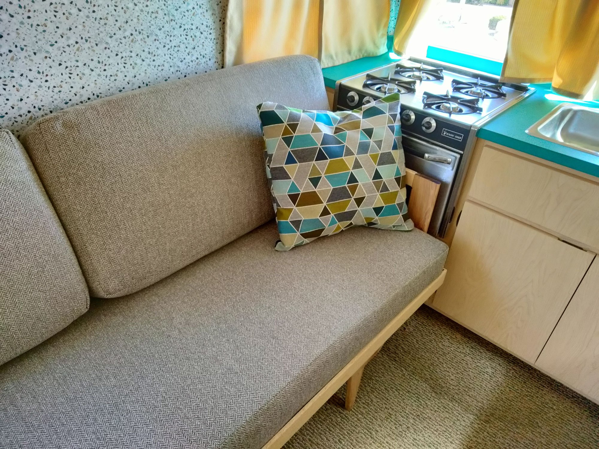

Original floor plan was designed to sleep 6. Our goal was to make as comfortable as possible for 2. Began by juggling the floor plan to maximize space. Decided to move kitchen to the rear. Went with a table and chairs in place of the built in dinette and added a convertible couch for sleeping.

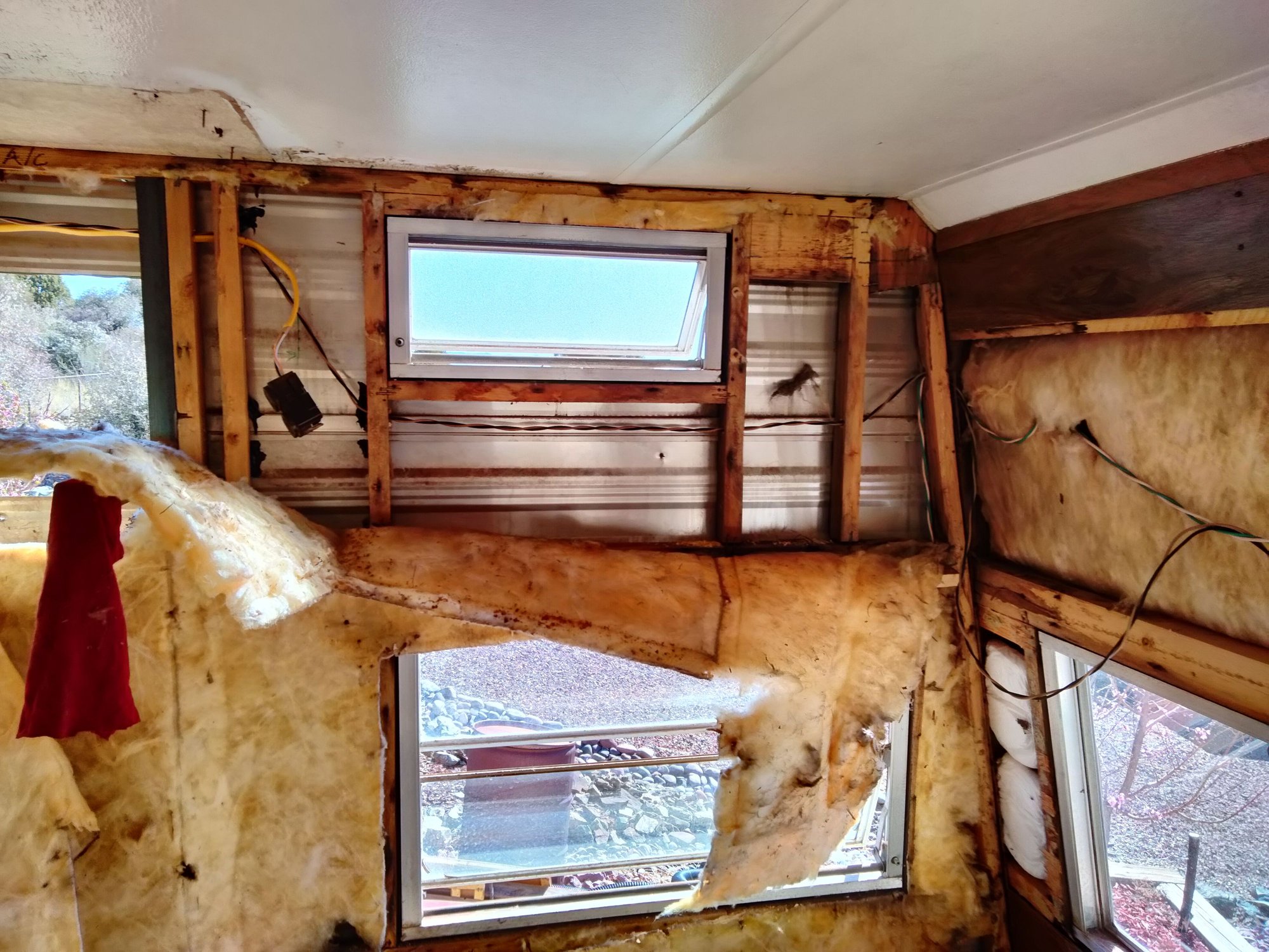

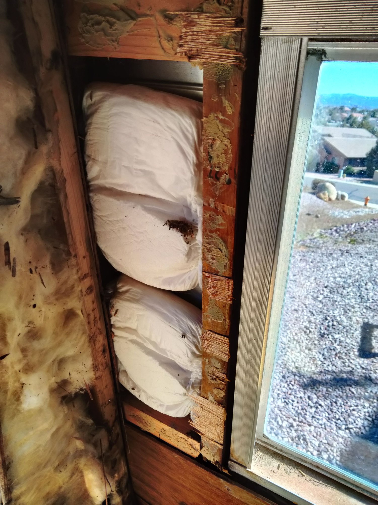

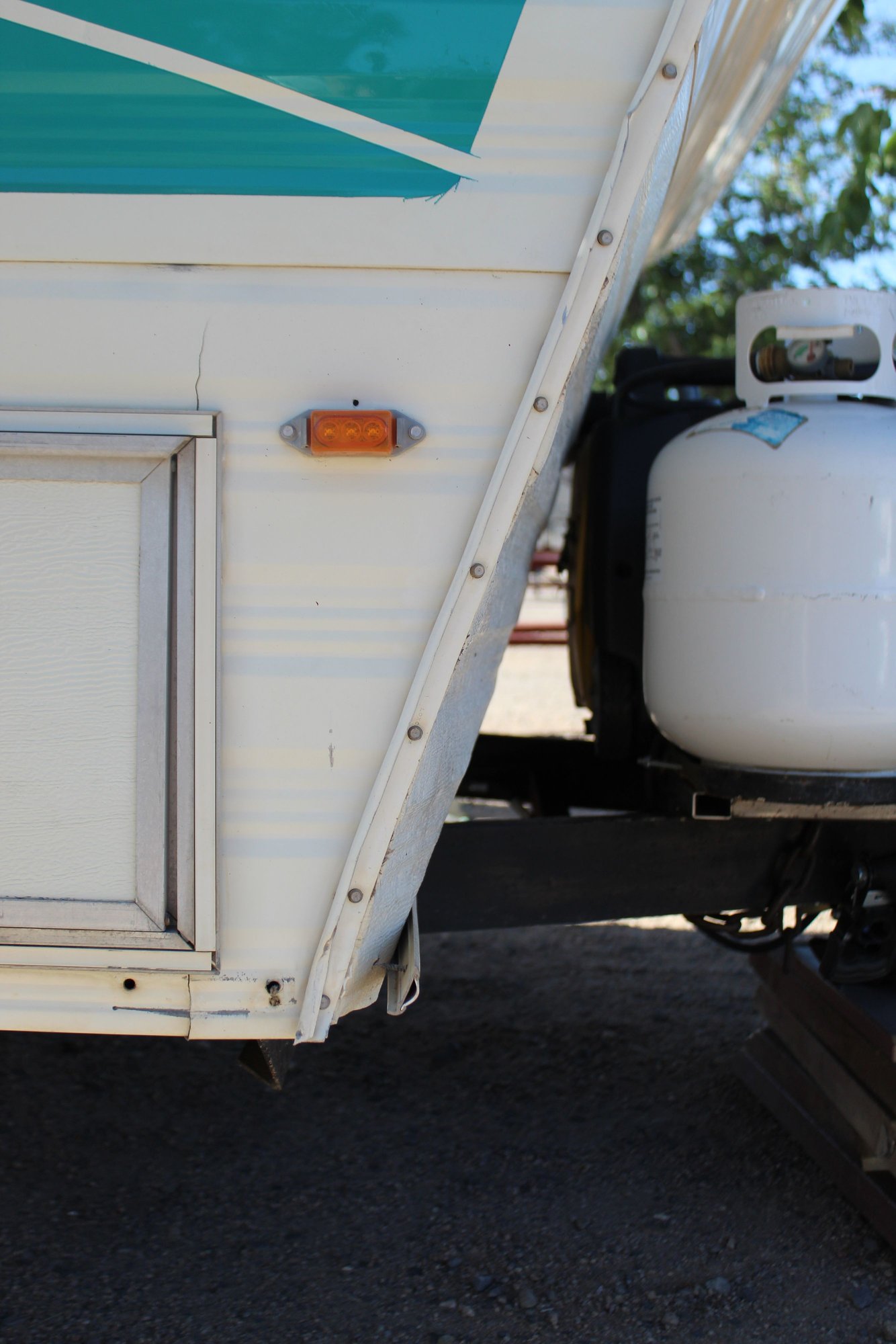

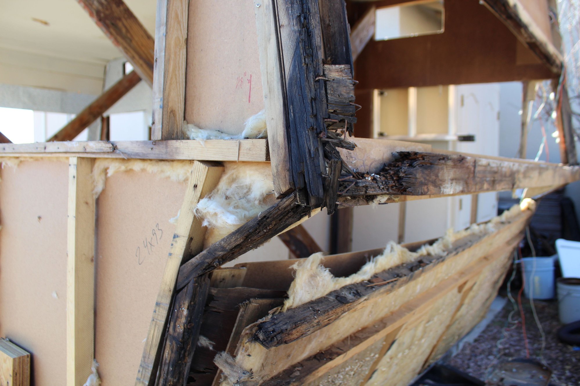

Whether it was built better or not than today's rigs is questionable. I've worked on a few of my friends' newer Rvs and agree that there ain't much to impress. Having said that, we uncovered quite a bit that left us scratching our heads. Even if it had been properly maintained I would question the realistic lifespan of the Shasta. Basically, a bunch of sticks butt stapled together and not much else. At some point the original assembly line clowns must've run out of staples or were pushing too close to quittin' time, 'cause we found a number of places where the framing was just along for the ride as there were no fasteners at all.
For grins and giggles, I wonder if this was factory specs or an upgrade

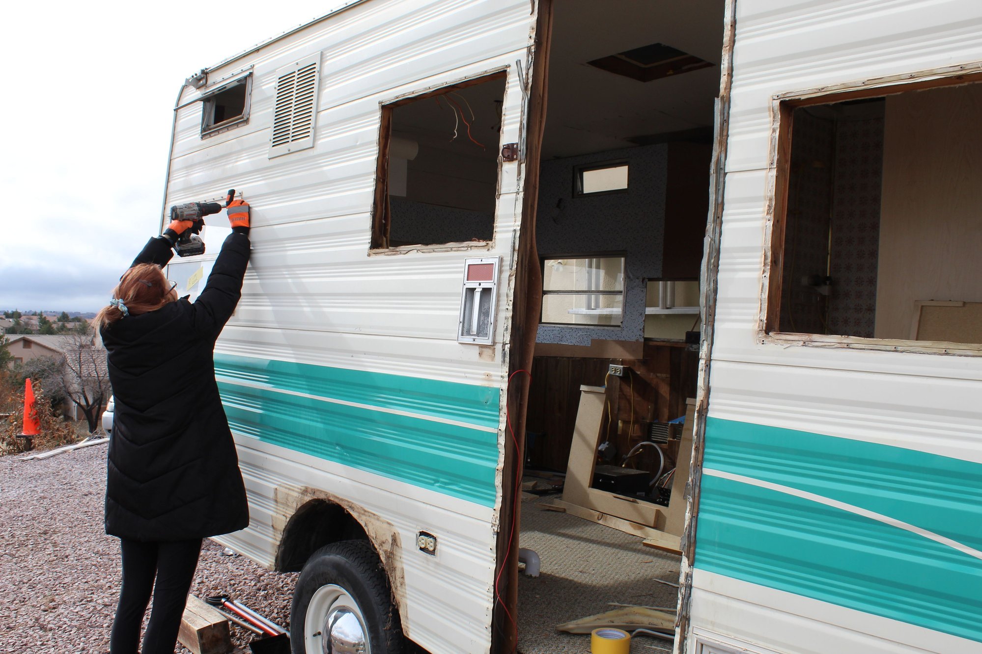

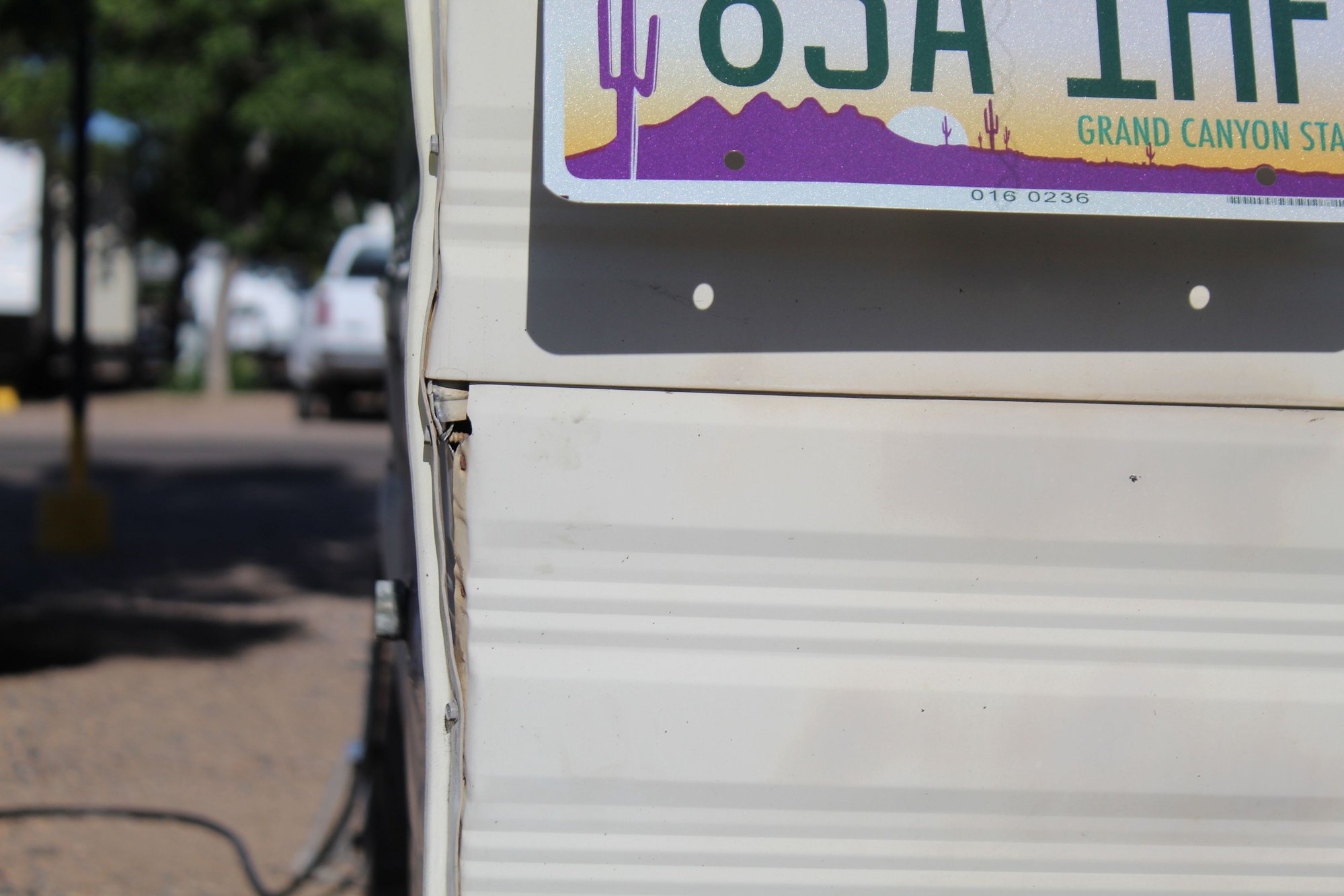

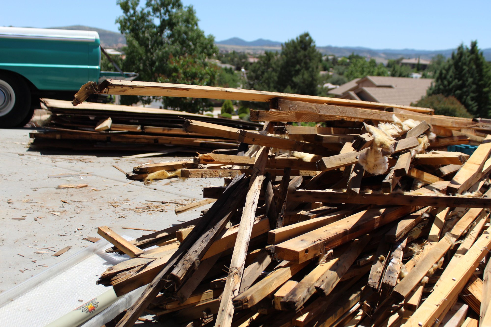

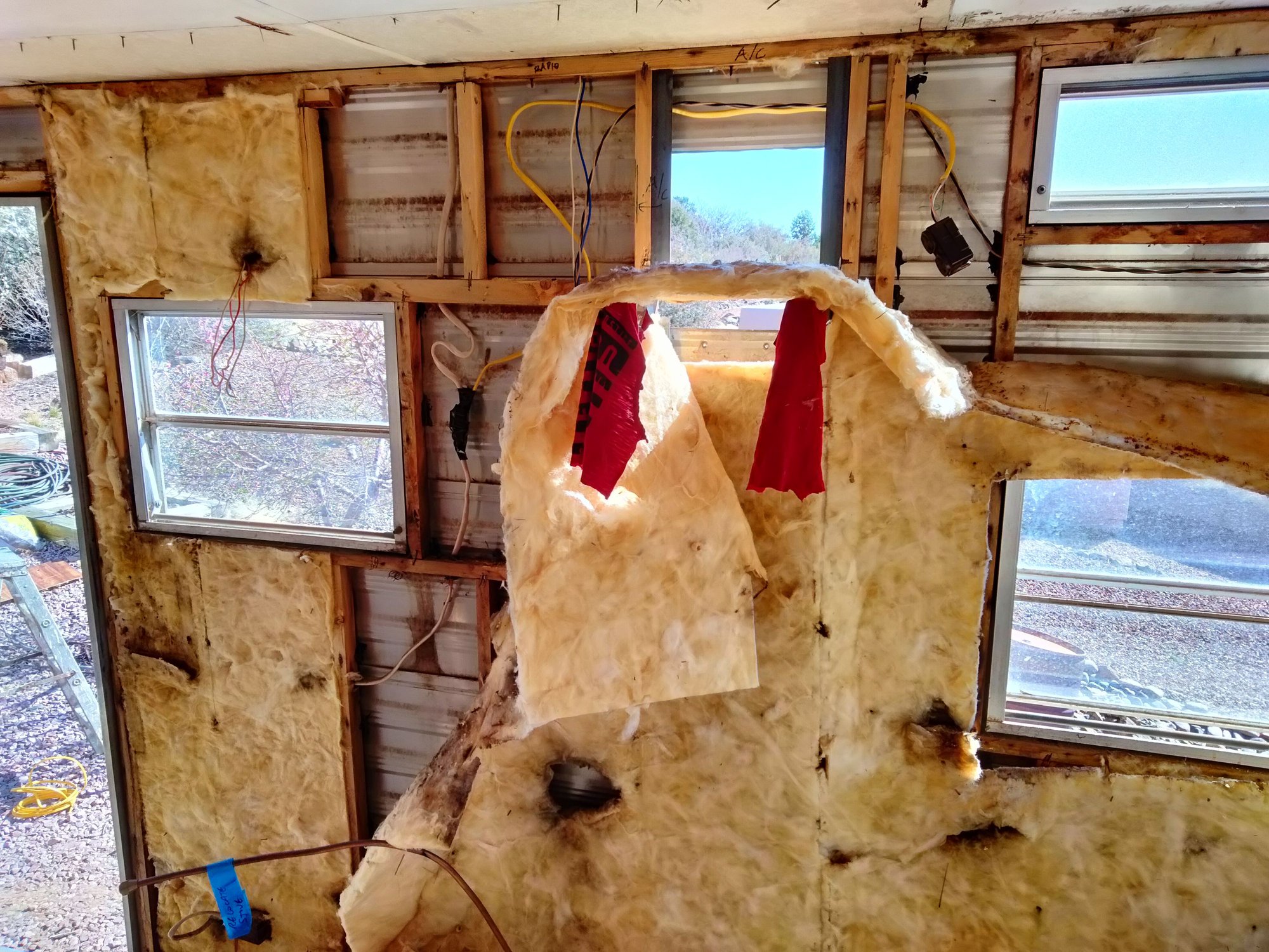

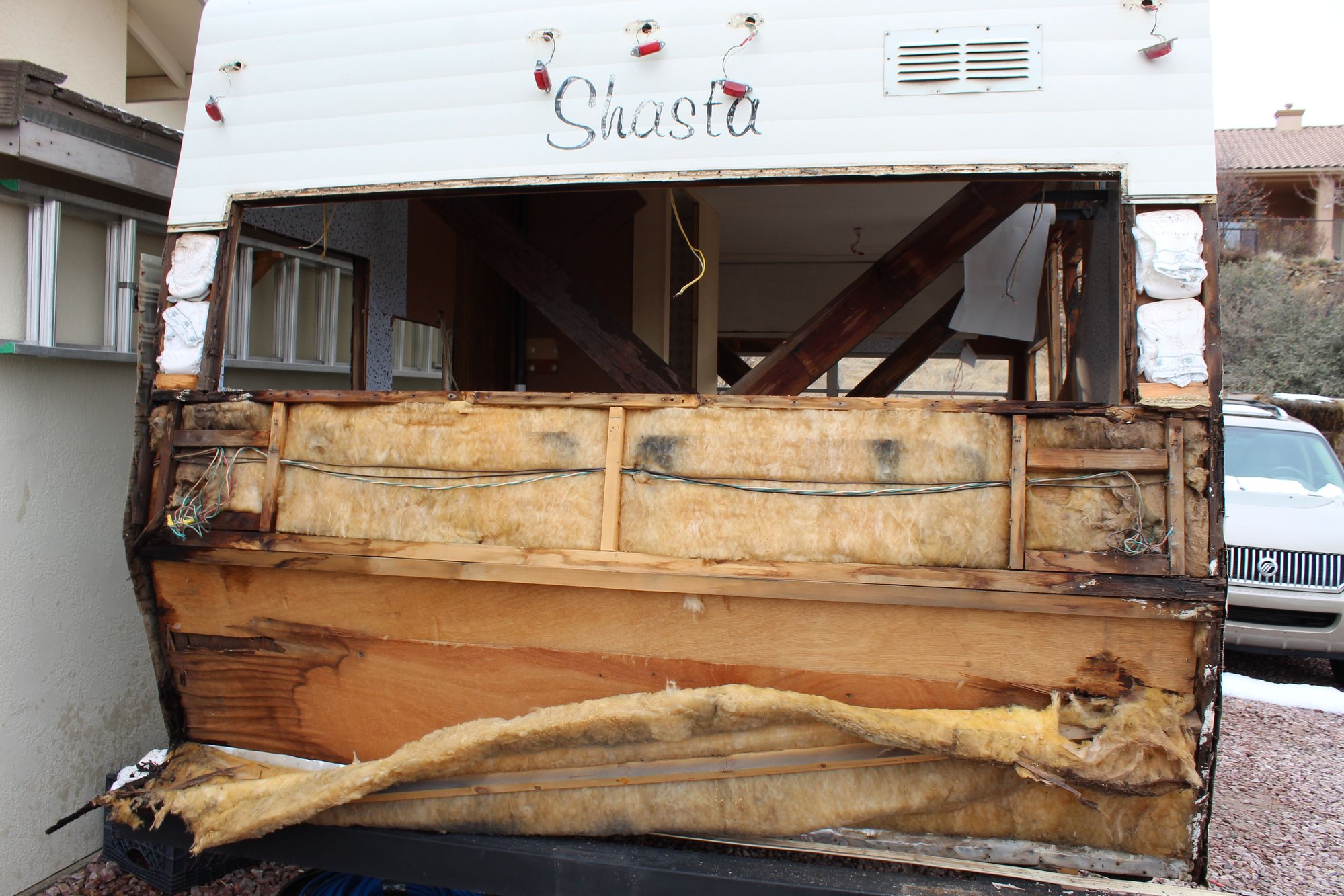

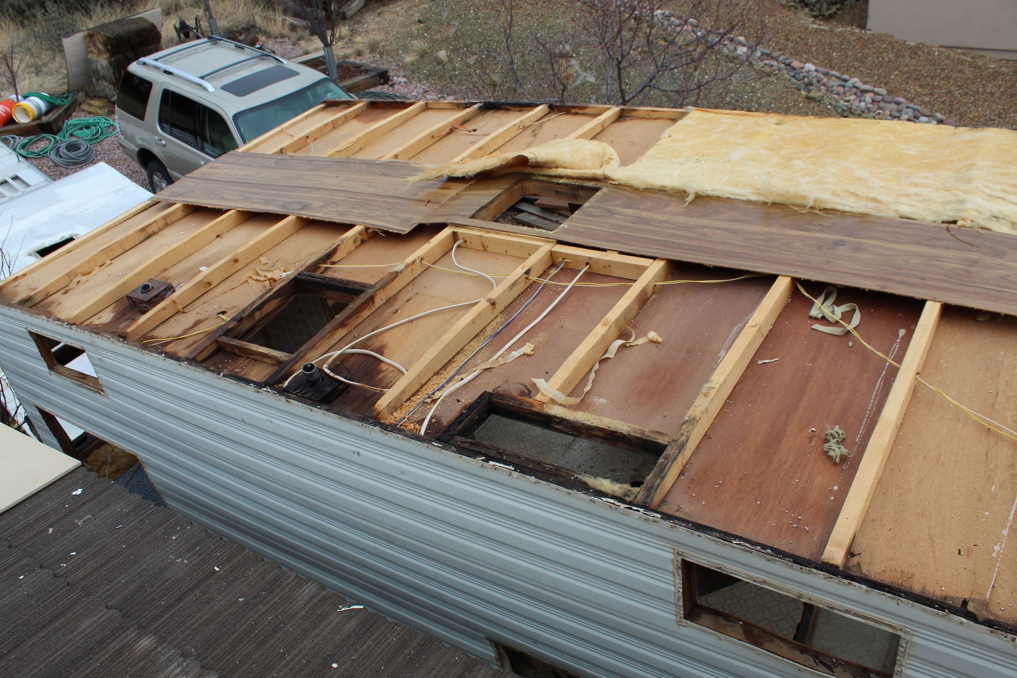

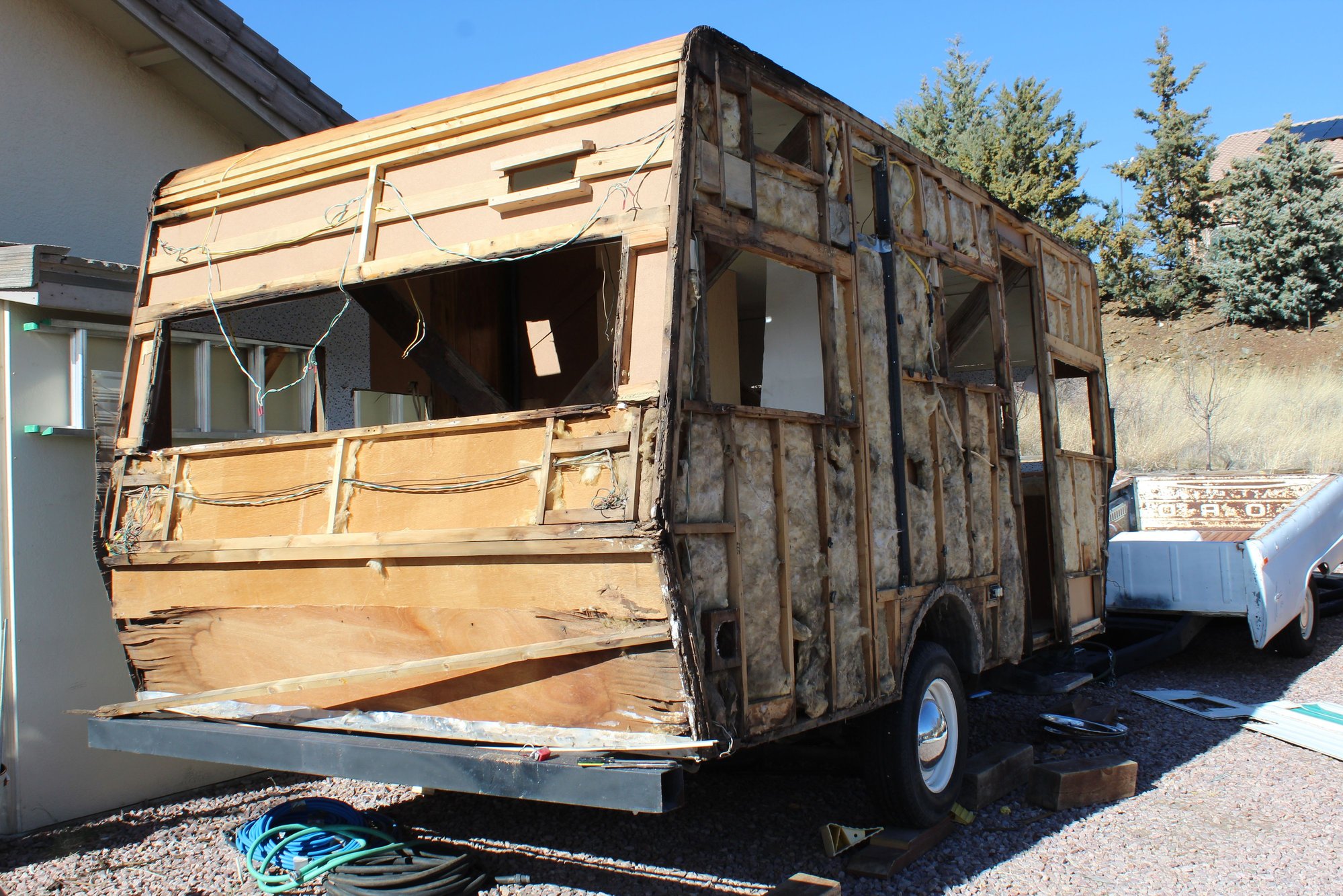

So, looking back on its maiden voyage, there were definitely signs that things were bad. Wallpaper started to pull, screen door wouldn't close right, screws mysteriously missing etc. Kinda fixed things along the way but to no avail. About a week into our trip I think I finally figgered out what was really going on. It was literally twisting and sagging and rattling itself apart with each passing mile. The rear was shearing sideways while the front was collapsing under its own weight. It slowly became the Shasta Disasta!
We rerouted our trip and did minimal driving, slowly making our way home. Took measurements each day to record the daily movement.

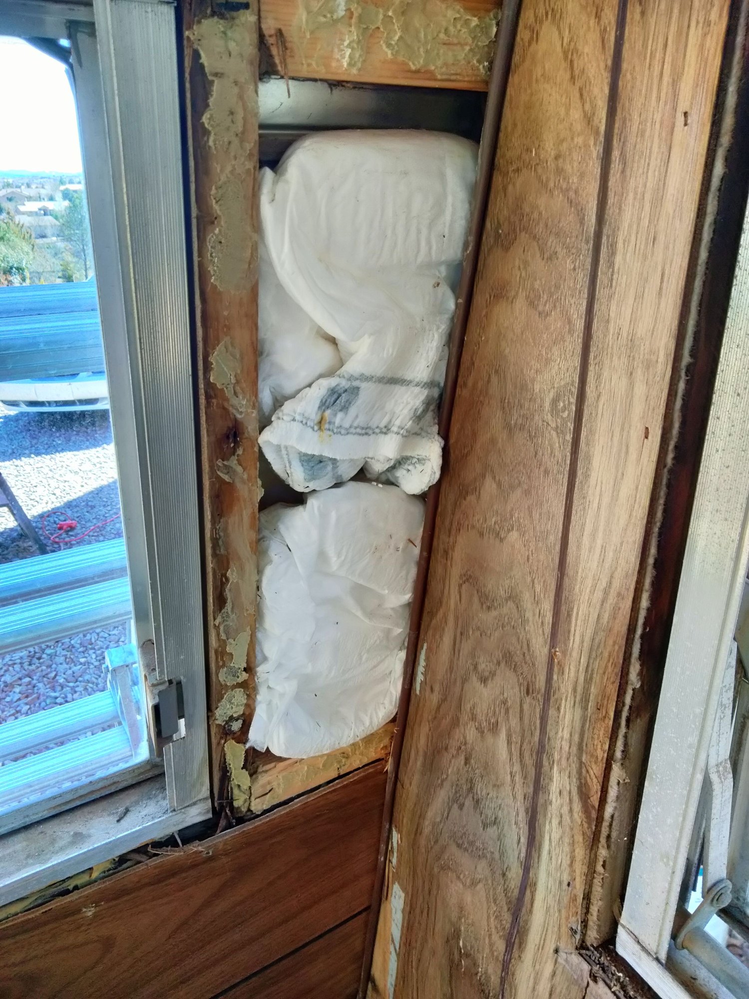

almost all RV frames are like that. They don’t rely on the strength of the frame, but rather use the entire box structure to get the strength needed to be stable. That’s why RV frames generally make terrible foundations to build from for other purposes (e.g. car trailer etc.)
looking at the picture of the walls, that explains why it wasn’t stable going down the road anymore. Looks like lots of damage to the wood structure.
rebuild the frame to good as new or better and it will last another lifetime.

Agreed. I've built houses and I've built cars. Rvs are neither. Thinking otherwise was my first mistake. My second mistake was changing the floor plan. Combined with the wood rot, there was zero chance it would all stay together.

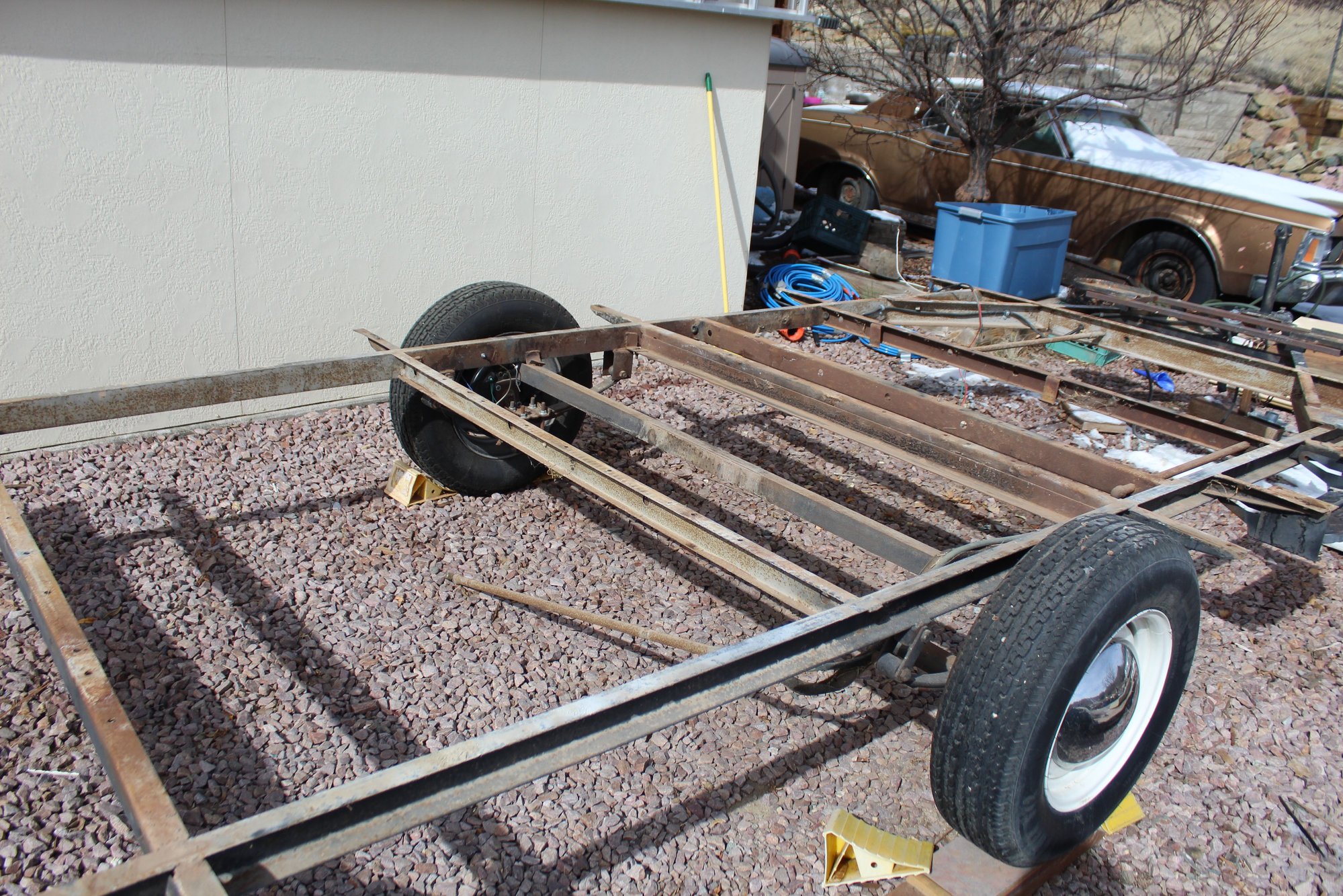

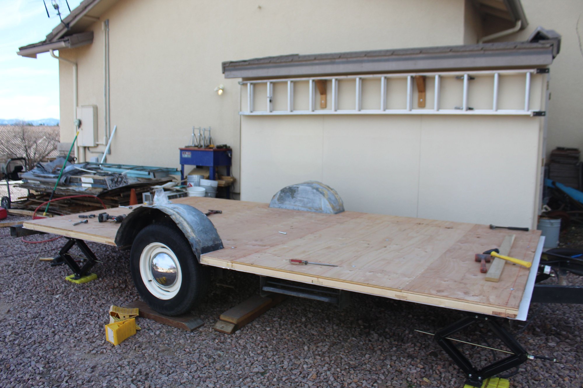

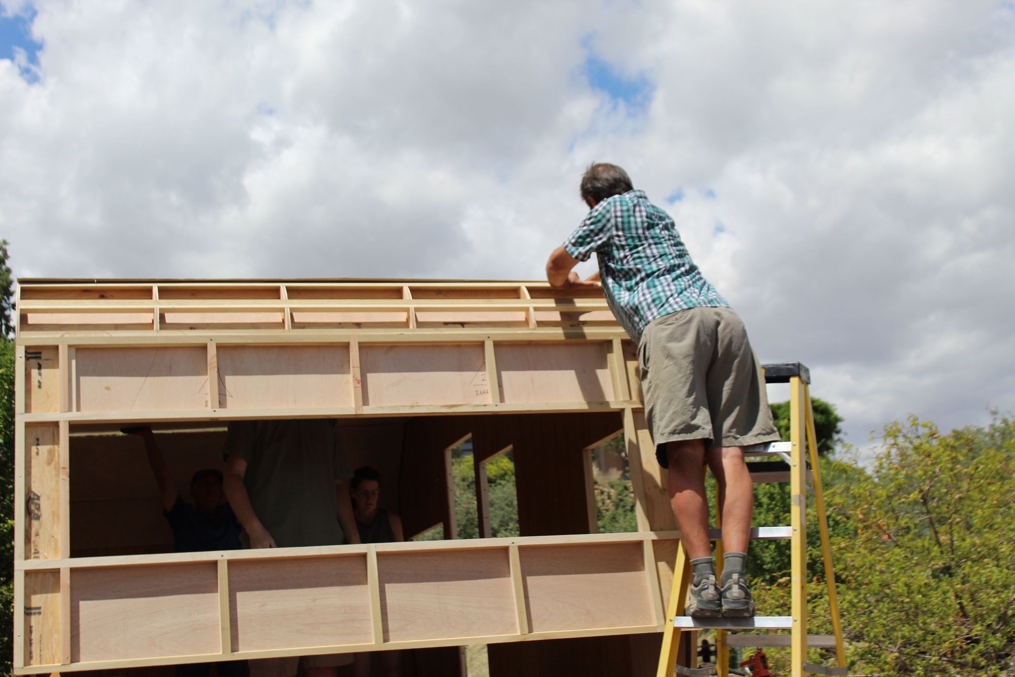

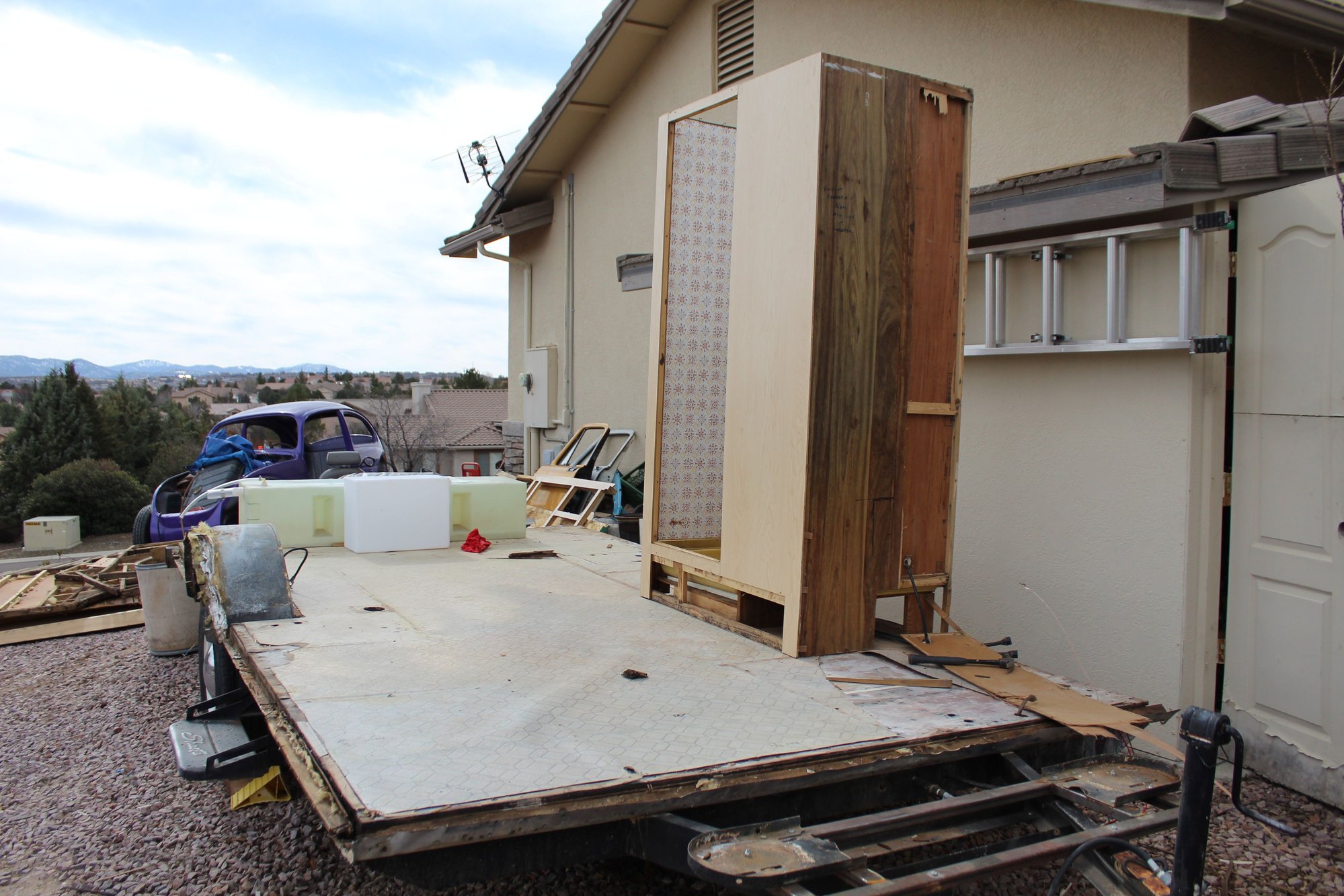

There's no turning back now. I've taken my lumps and will use what I've learned to rebuild. Better, stronger, faster. Well, maybe not faster.

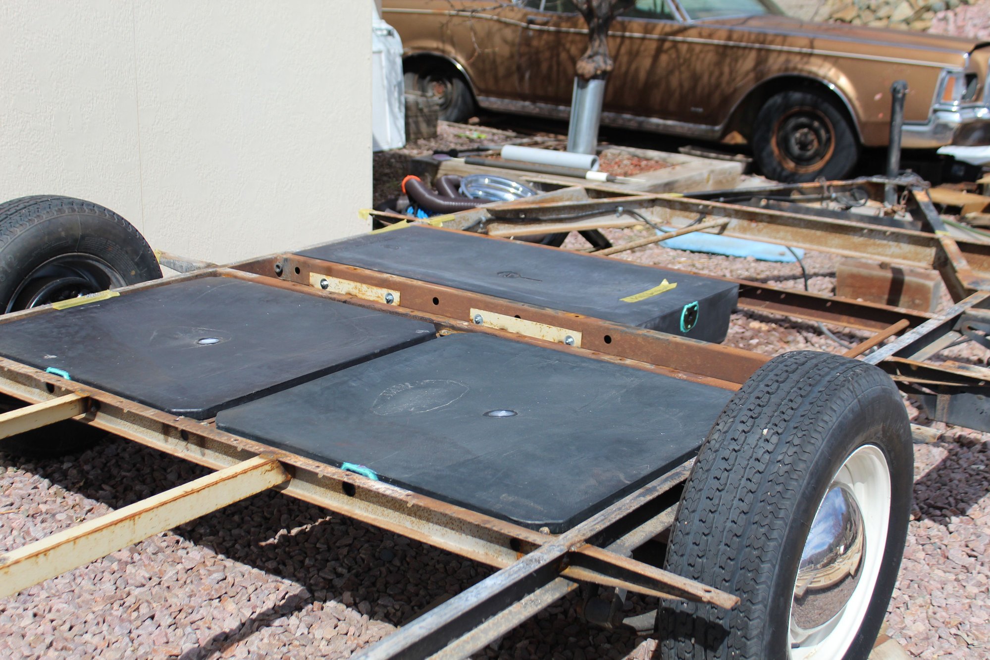

With the frame stripped bare I've replaced all tanks and added a few extra supports based on the new floor plan since there were a couple spongy spots that I wanted to eliminate. Original floor was 2x2 sticks butt stapled with 1/2" plywood floor. New is 2x3 sleepers with 5/8" ply. All half lapped, glued and screwed. Also, old walls were screwed to outside edge of floor. New walls will sit on top of floor.

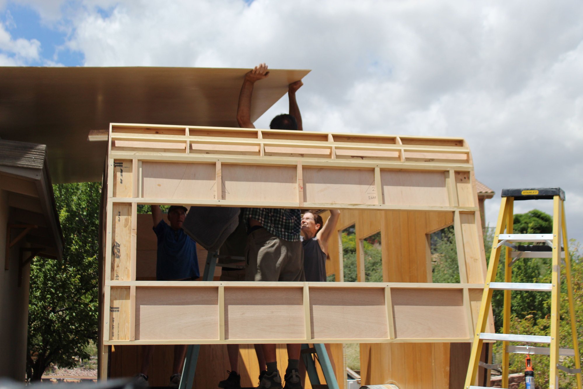

For this to work and for me to be happy I have 3 main things to focus on;
1-It must be stronger and only parts that will last another life time will be reused
2-Reduce weight without sacrificing strength
3-Completely customize for our needs but equally important to retain vintage look and feel

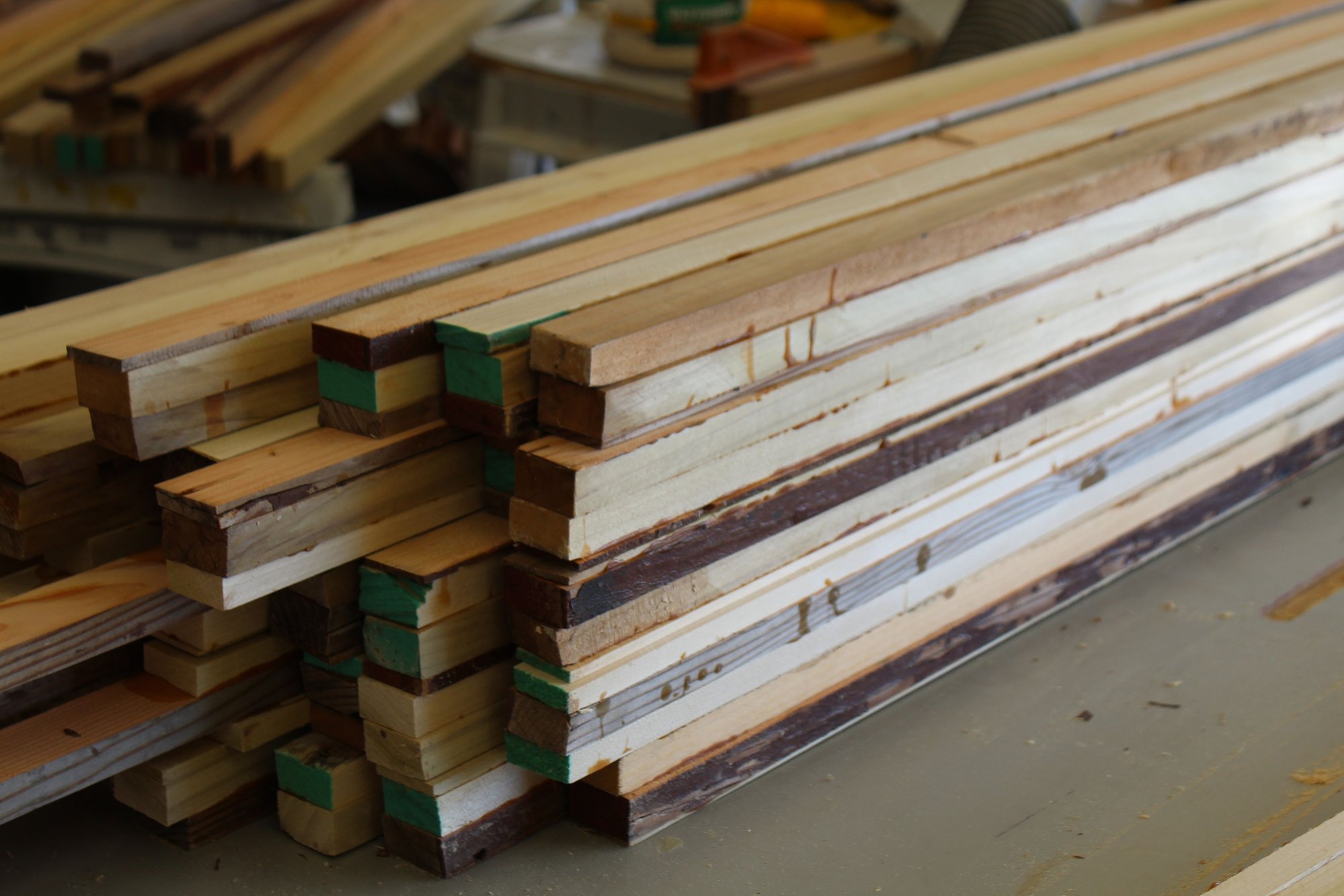

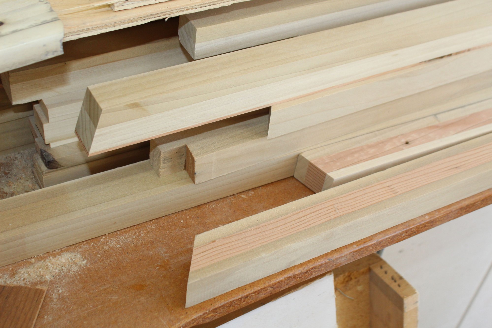

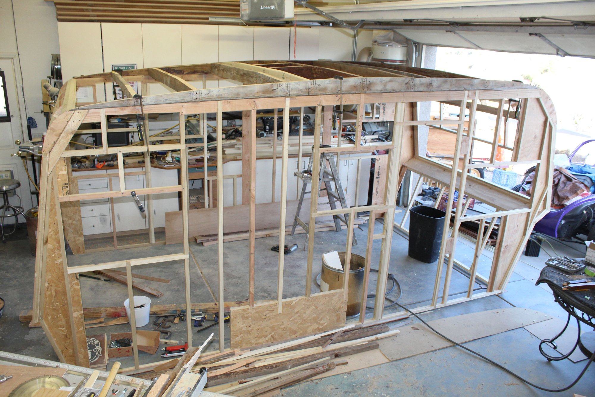

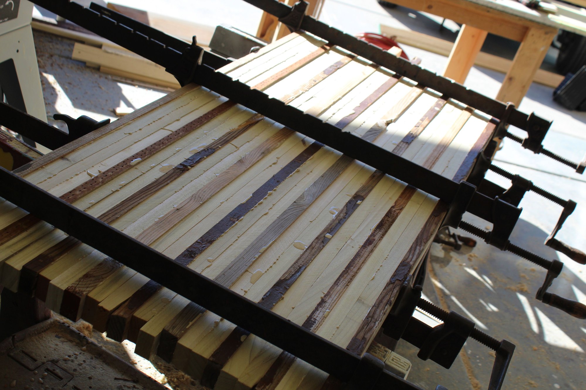

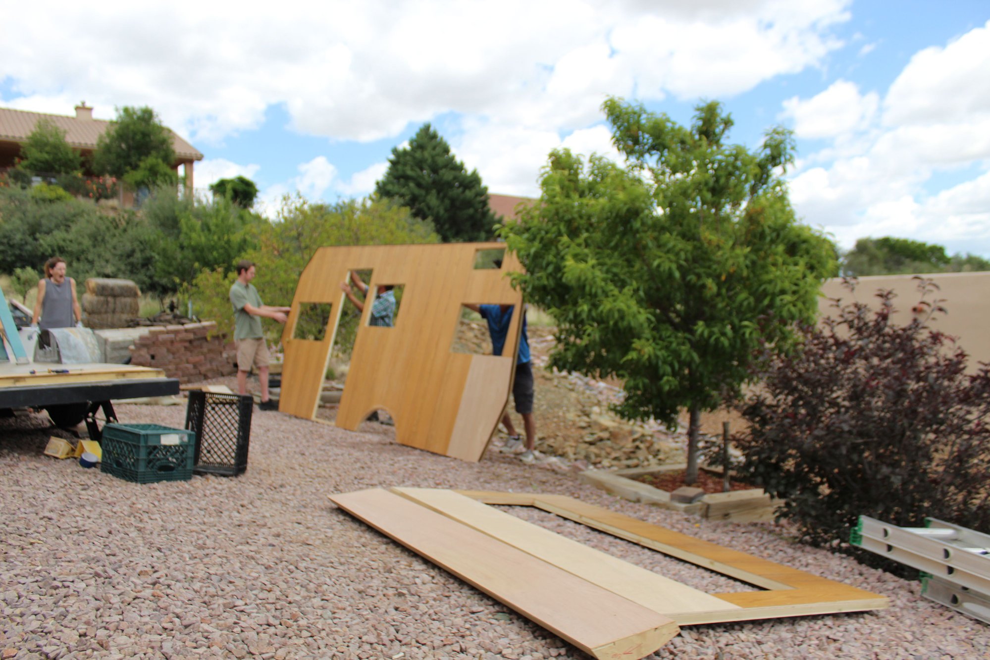

Walls are fabbed from mostly leftover cutoffs and scraps, gang glued then ripped and milled. As a woodworker by trade, makes for very stable, strong sticks since only 1x1-1/2 finished. Plywood shear at all corners. Again, all joints half lapped, glued, screwed.

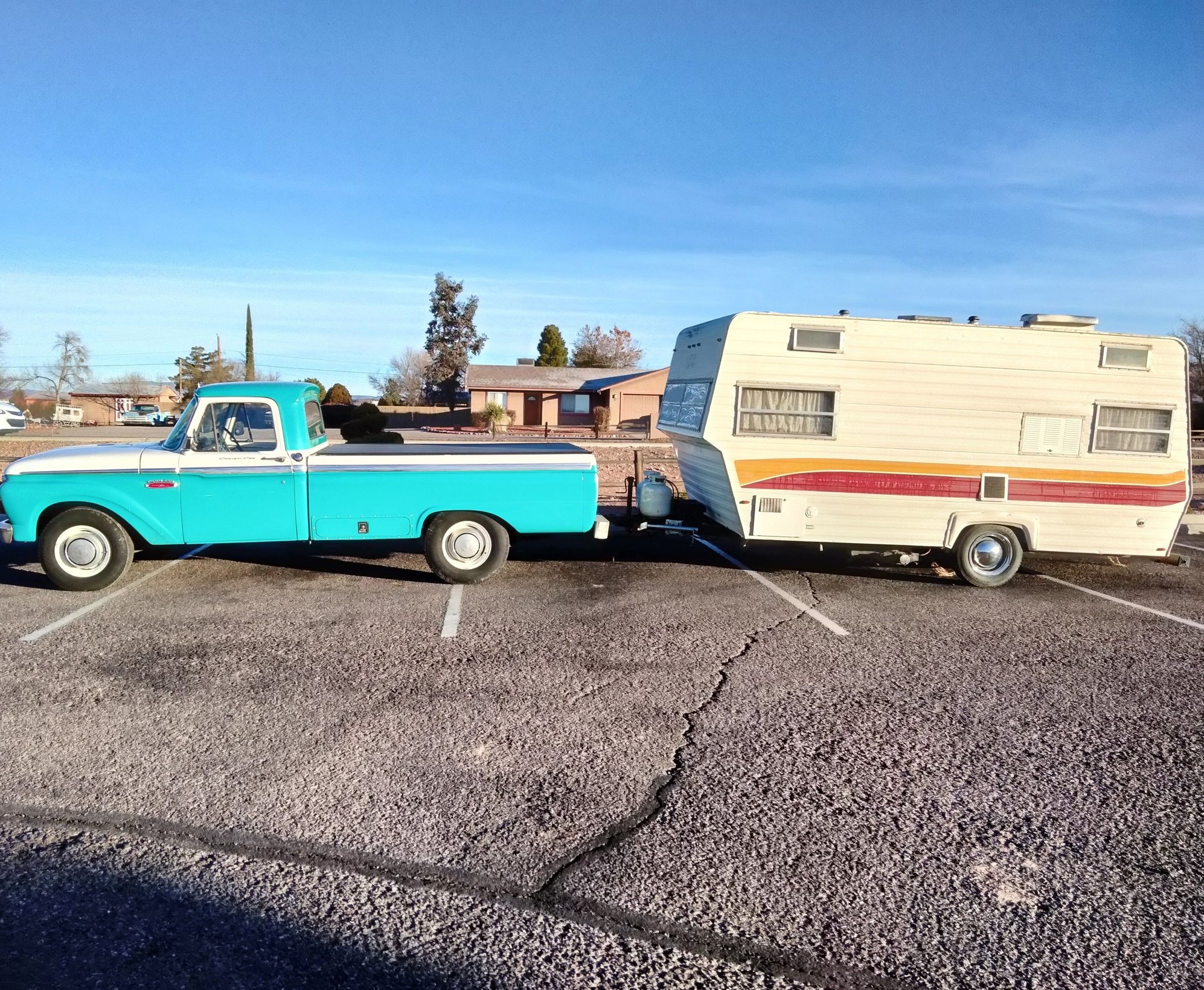

Truth be told, I was never really a fan of the boxy shape this Shasta had. Combined with the interior design, it just screamed 1970s. I always liked the older, 60s style. Plus the older style would look better behind my '65. So, some changes.
