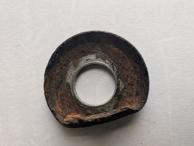

When replacing the rear shocks on my 1952 F2, I found one of the cup washers was damaged sometime in the past and the PO just put it back on that way. I have tried all of the auto parts stores and specialty fastener places in my area and everyone recognizes what it is, but nobody has a source for them. Since these shocks have no metal bushing , I think using a cup washer like the original would be required as opposed to a plain flat washer. Any recommendation for where to get these would be appreciated. Thanks in advance.

Photos added to the original post. 0.5" I.D. 1.25" O.D.

You can make one with a washer, socket and a ball peen hammer. It will turn out better if strike the ball peen with a rubber dead blow.
Some shocks only come with flat washers now.

Ford Part 7HC-18039-A. Not necessarily available separate sale - included with shock absorber.

Thanks to everyone for their replies. It looks like I may need to try straightening the one I have or make a new one with a flat washer and some fabrication techniques.
