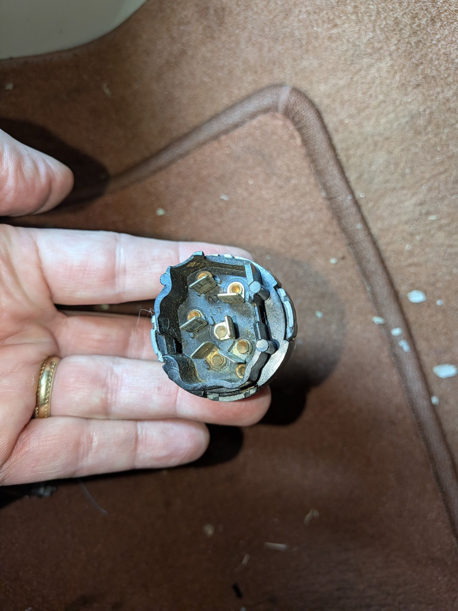

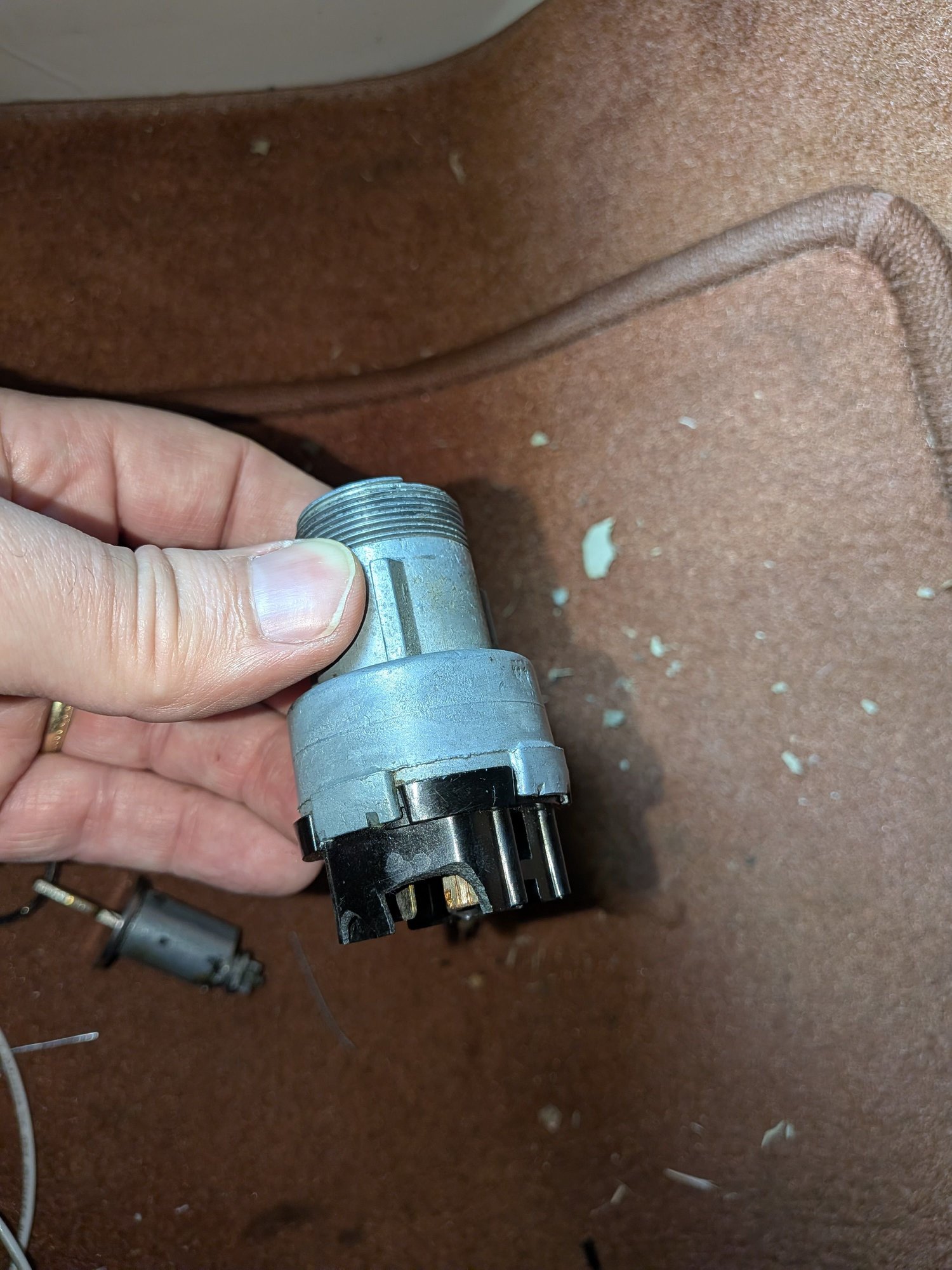

I’m installing a tachometer and want to pull power from the ignition switch. I was looking around for a pin diagram but none of the ‘64 diagrams matched my switch.
I did, however, find a diagram that matched my switch but it’s for 70-76 trucks. So it seems I have a later ignition switch. Can anyone confirm from the pics that that’s what it is?
I did figure out which pin is the accessory pin. Would that be the correct pin to get power (not the tach signal) to the tach? I have the battery disconnected while I work on wiring so I can’t probe the wires at all.

What kind of tach that takes 12v?

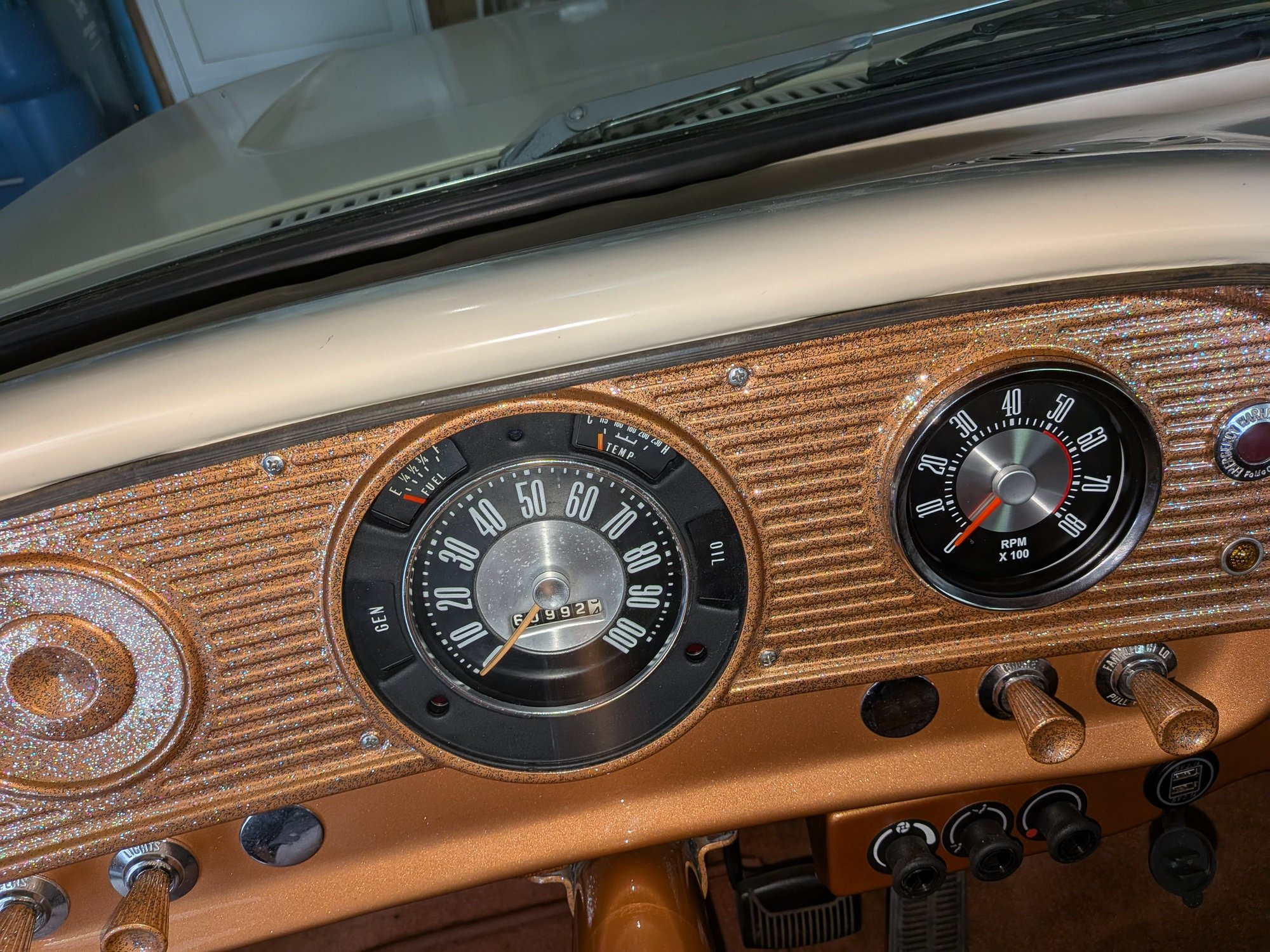

This is the “Bronco” tach that matches the font of the speedo pretty well. I got it hooked up. Tapped into the accessory wire from the ignition switch. Works just fine. I put a fuse on it just in case.
I do have a later ignition switch for some reason. Doesn’t really matter.

That tach does look good in there, nice match. You can buy small bottles of fluorescent orange gauge needle paint, then all of the faded old gauges will match the new tach.

That does look good. Now I don't want to be rude, but could you please post some more photo's of the rest of the truck. The dash seemed to be just a teaser.
