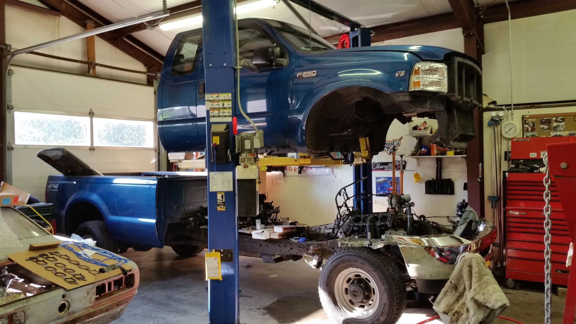

We just put in a new Ford crate motor yesterday; it took a few days. It was 6.8L V10 in a F5500 2009. It is quite a job and the motor was supposed to be new from ford and looked like it. We paid $8.5K in the Peoples socialist Republick of California. It started on the first turn of the key and is running smoothly. You can't go wrong with factory parts (once you get the correct one)).
