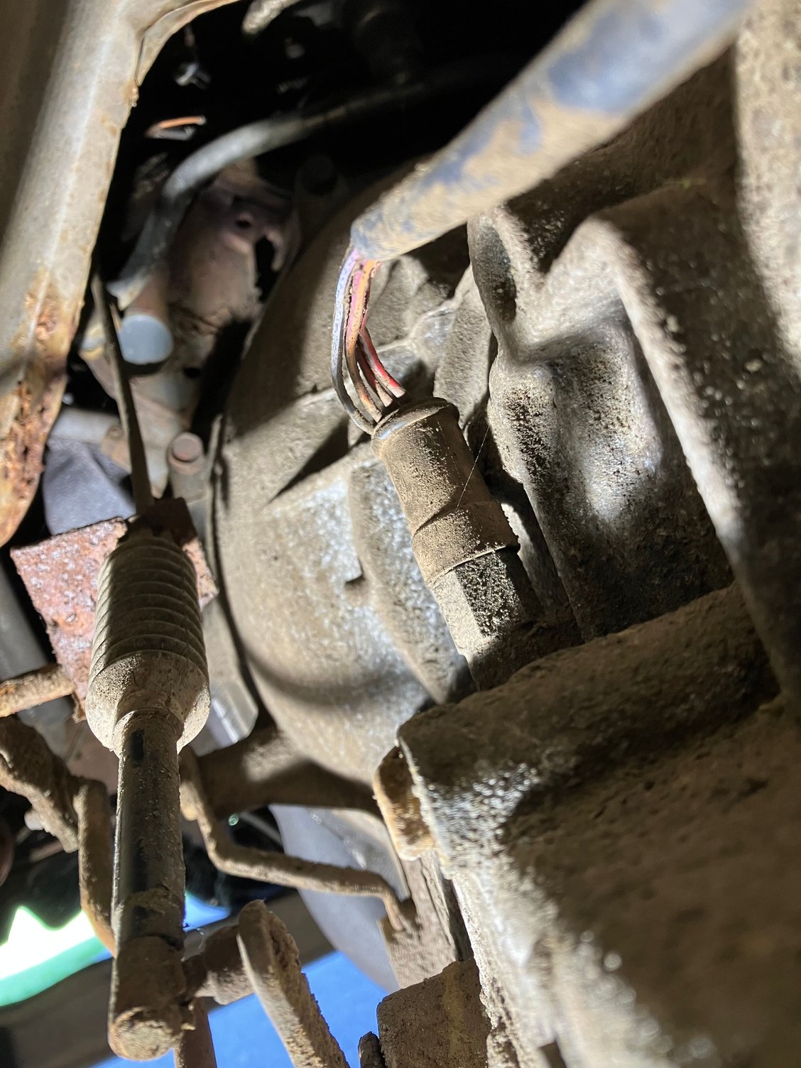

Max Capacity's Avatar
Max Capacity
Joined: Jun 2013
Posts: 5,691
Likes: 1,174
From: Tolland, CT
Sorry, I went back out under the truck and those are the only wires going to the AOD.
I did kind of clean the four wires so theyh are easier to see. She wants to get the grill going now so I'll be away for a few... I'm not sure where the NSS is on my truck... I'll check Gary's site when I get time.

In post #5 that is the NSS in the photo I took. From what I can tell... ?
https://www.ford-trucks.com/forums/1...ty-switch.html
I would say that is the NSS also.
If you were to pull the wire plug off it looks like the "switch" uses a wrench to unscrew it from the transmission.

My reverse lights are working now.
i first verified the NSS was bypassed by confirming I could start the truck in gear. Afterwards, I snipped the two wires for the backup lights from that harness with 4 terminals. I then spliced it with the wires from the connector I attached to the transmission.
