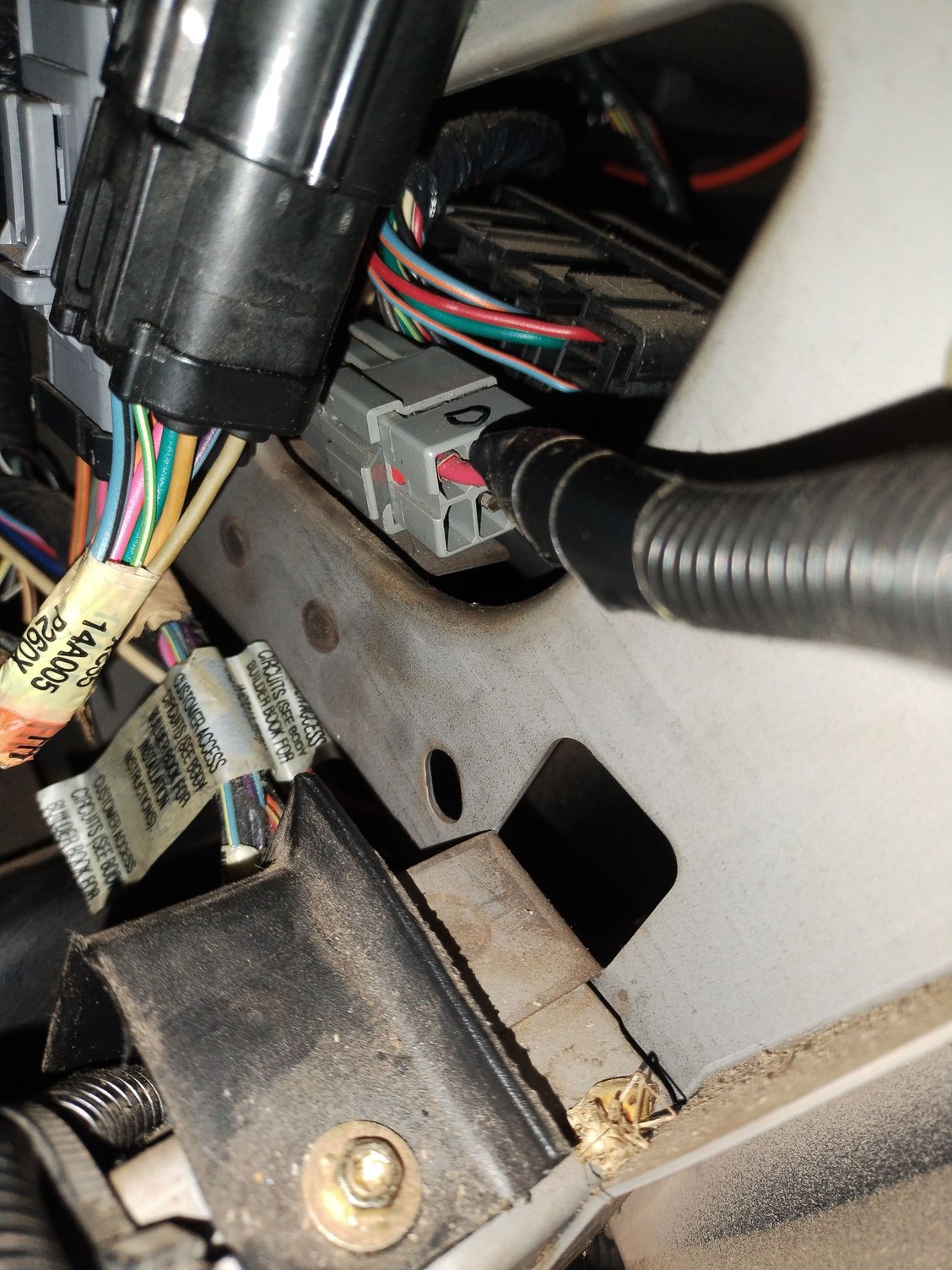

Trailer Brake Controller
I can get my hands on the plug in to my brake controller but I can't unplug it. I am only getting 6 volts at the plug to my trailer. I need to disconnect the controller to test it. it looks to me like to take the center portion of the kick panel off you have to remove the dash. I have the drivers side kick panel off but the plug is on the right side of a hole in the frame of the dash. I can put my hand through the hole but can't release the clips on each side of the plug. Any suggestions? This pic is from the drivers side

Get up in there and pop the Christmas tree clip holding it to the dash support/ metal bracket.
