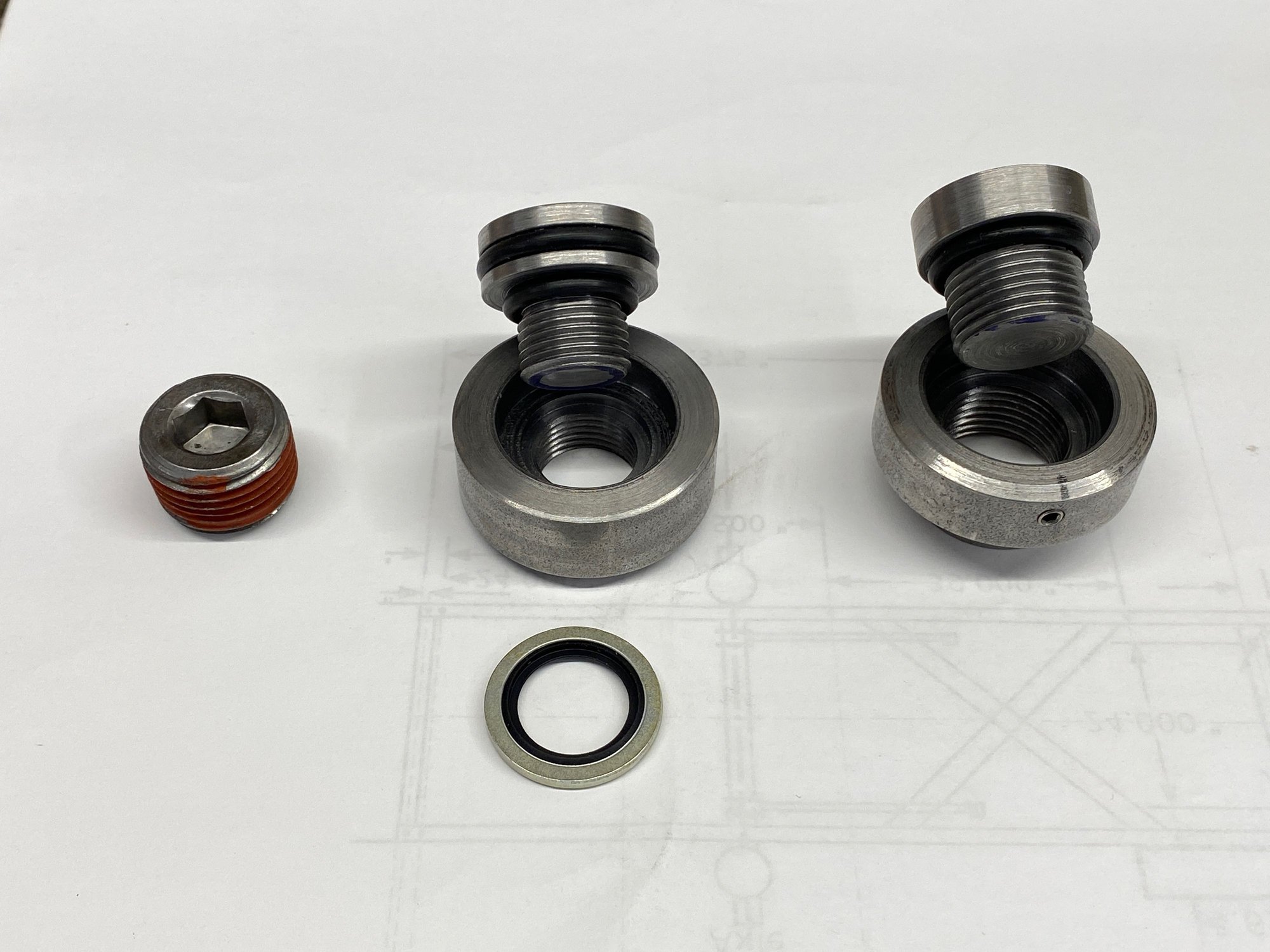

I added one to mine. The housing is thin like 1/8"-3/16" which is not enough meat to put in a large drain plug. Gear oil is heavy and does not flow real well so you want to use a large plug. I would recommend a min of 3/8" NPT, 1/2" NPT better. They sell drain/plug kits for this to weld in. I made my own using o-ring seal, so I don't get any seepage when using Syn gear oil. I used the 1 on the right. Requires a pin spanner to remove as less as loosen the allen locking set screw.
