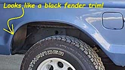

Today I was gonna put all 4 pcs new fender opening trim I've had since 1997 on. Each one has a few short washer head sheet metal screws in a bag, #6.
Well, I found that the right front one had oval holes that were located where the screws holding my fender liners were, but the oval holes were a bit big and the washer head screws actually didn't secure them too well. I got the rt frt on, took a pic, and decided to revisit after I look for more better fasteners. I think I'll maybe add a few screws through round drilled holes. I debated whether to try putting the trim between the body and the plastic liner, but today I put the trim over top of the plastic so the plastic liner was captured between the trim's mount lip and the fender lip.
Anyway, I zipped the screws out and put the trim back in the box with the other three until I get screws I want .... and I'll decide if I for sure want them on the truck. The set was $84.95 in 1997, so not a recent purchase.

I've got the trim pinching the liner, with washer head screws.

I did take all the screws out of the liner to try inserting the lip of the trim in between it and the fender, but then the trim seemed a little shorter from end to end ..... but it does fit better as you describe it, I guess since it is a slightly tighter arc.

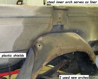

Back at the rear, we put my long stored new bed sides on, new inner arches too that span from bed side to inner bed side which are solid themselves. After we did so, I used cardboard funnels I made to pour a pint of "Iron Armor" bed liner down the middle standard hole where it ran down to the welded & 3M bonded joint along between the arch and inside of the bed side top of fender lip. I had also reached up with brush and mirror to spread it whole length of joint and cover the arch top surface. I reused the original plastic inner splash shields after finding dis-satisfying fit of those long held J C W plastic tubs. The bed rails are covered which includes the standard holes. There are NO holes in the rear fender lips, so there are not likely any rust concerns.

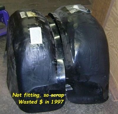

Was in the early years that I thought fender trim and those plastic liners were a great idea and that I bought them then. Was in 2022 we put new arches in with bed sides, and they are well weather proofed now. It was in 2022 that I attempted to install these liners and bright trim the first time, but I never got a good start, didn't even take the trim out of packaging then.
Looking at the last picture, had I seen it so well shown, would not have bought those tubs. In 2022 was still go9nna use them in place and not use the OEM ones but by then knew the OEM plastic flaps were really a good fit with the metal arches. I had previously viewed the metal arches as just support for the bed side, but really they serve as great splash protection for the bed sides hidden side too, and mine also have bed liner on them, over any paint.
