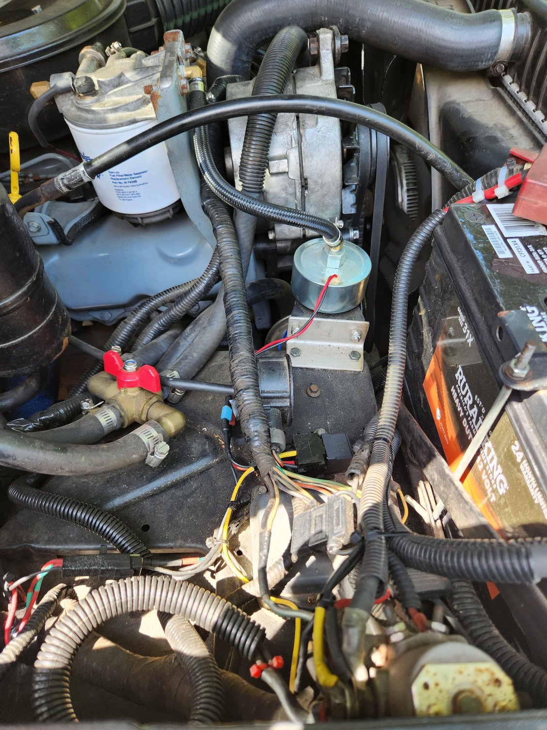

I bought the Facet and it is beyond excellent.
Yellow goes on B+ lug on starter solenoid
Black ground
White ties into harness to lead that powers fuel solenoid on IP.
Red/Blk pair connect to pump
Inlet is 1/8" npt x 3/8 90° barb
Outlet is 1/8" x 3/8 45° barb....45° works perfectly
Another 3/8" 90° barb on filter head (cant remember pipe thread size)
​​​​​​Hose is 3/8 AN-6 braided
Clamps are fuel injection style, not worm clamps
Standard Bosch style relay and 10amp fuse
Mounted on L bracket right next to corner of metal tray on top of fender liner. Relay mounted there also. It all just fits and will allow fuel to drain down without getting on anything if I need to clean strainer.
The only caveat is I now have something electrical that could conk out, so I'll keep a spare on board. Facet is more reliable than the crummy mechanical we're getting nowadays anyway...
BTW throttle response seems a little snappier as well.
