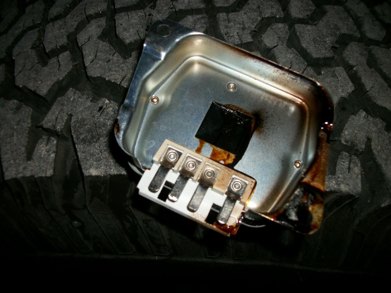

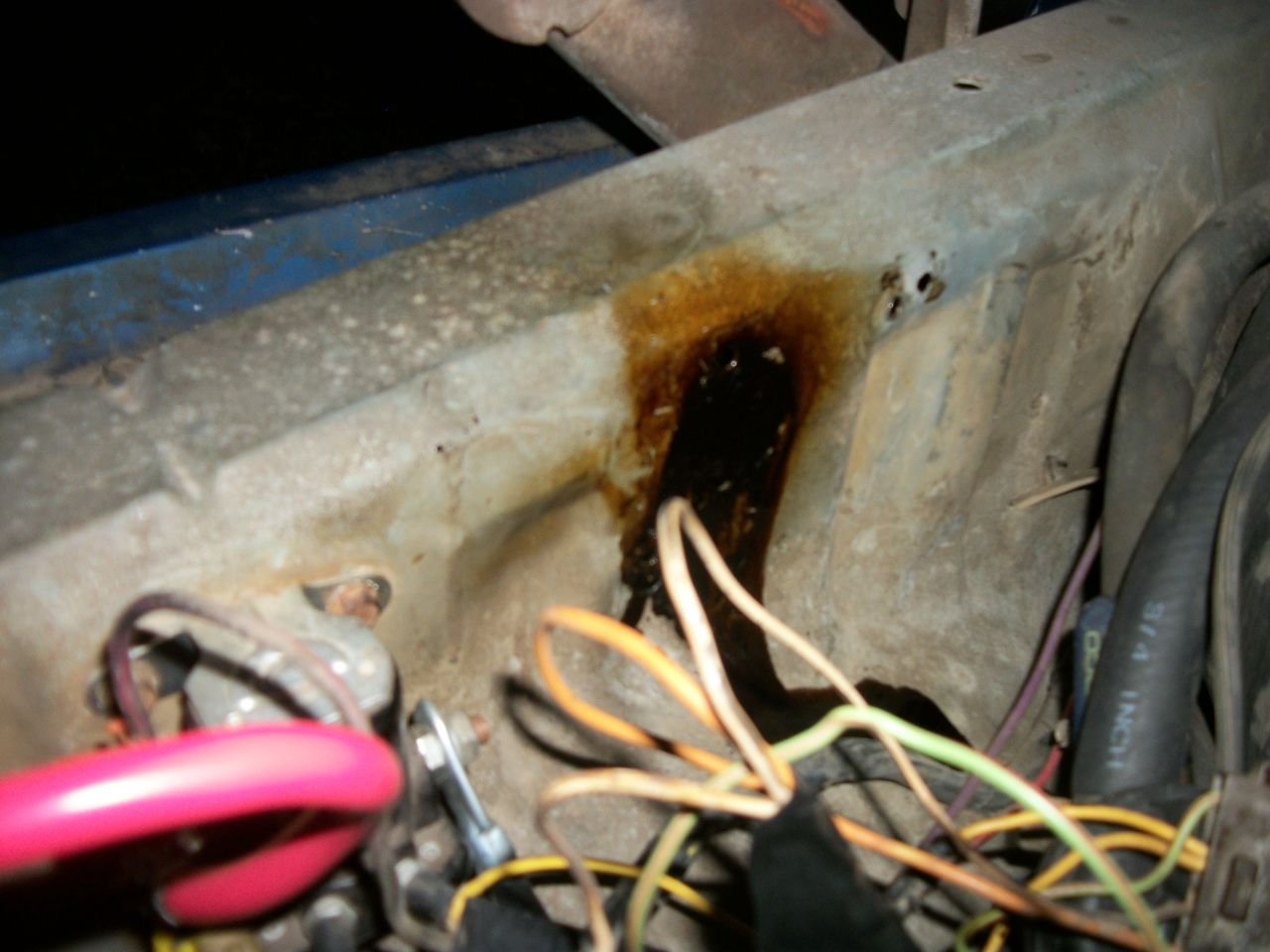

Well I do know from 1st hand experiance, that when you use the one piece molded negative (lead clamp and wire cable as one) battery cable and it intermittently works. It can cause wild fluctuations in your alt gauge when driving down the road and cause for a difficult time to trouble shoot.
And that issue (of lack of sudden internal connection, when the truck was idiling) in my buddies drive way, cause the black material inside the voltage regulator to melt and make for a white smoke show, to the point I though the truck was on fire. And that material in the VR stinks like crazy.
I managed to find the originial issue by luckily having the hood up with door open and the dome light on. I was doing a wire wiggle check and noticed when I pushed and pulled on the battery cable, that the dome light came off and on. Wala bad connection that LOOKED ok from the outside.
I now have battery cables that the lead connection is clamped to the cable end.
