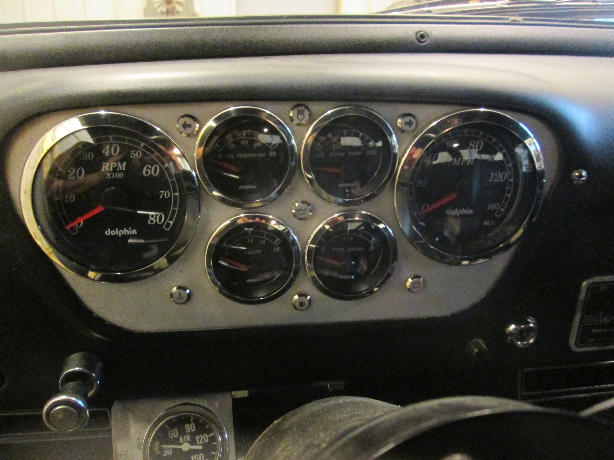

I bought a set of 6 of these gauges about 3 years ago because they were cheap. I thought I would give my opinion on how they work after 2 1/2 years of use.
The water temp, Oil PSI, and volt gauge have worked flawless and accurately the entire time. The gas gauge is total garbage.
The tach works good except sometimes if you do not let the tack get completely booted up and let the tack swing to full scale and back before starting up it will not work and the only fix is turn the truck off and back on and then it will work.
The GPS speedo is the most accurate spedometer I have ever had, it is dead on but it sometimes takes it a couple miles to get booted up and a really annoying thing is the odometer only shows a display when it is GPS connected and it will not GPS connect inside a metal building so say you can not read the odometer when it is in a building. Also does not work in a tunnel..
Then I have black face gauges and in bright daylight I have a very hard reading the gauges and the LCD odometer reading is invisible on a sunny day but they are all very easy to read at night.
Bottom line is these gauges are just not pleasant to use and I am going to replace them with auto meter.

Curious how the Autometer treats you. Our dashes don’t have the recessed area that provides shade like a newer car, LCD displays are hard to read in the sun. I have a convertible, that I can’t read the radio display in the sun for that reason. My truck has the old analog display for the gauges and speedometer for that reason.

Are these analog gauges and what model ? pictures ?

analog, except the odometer
