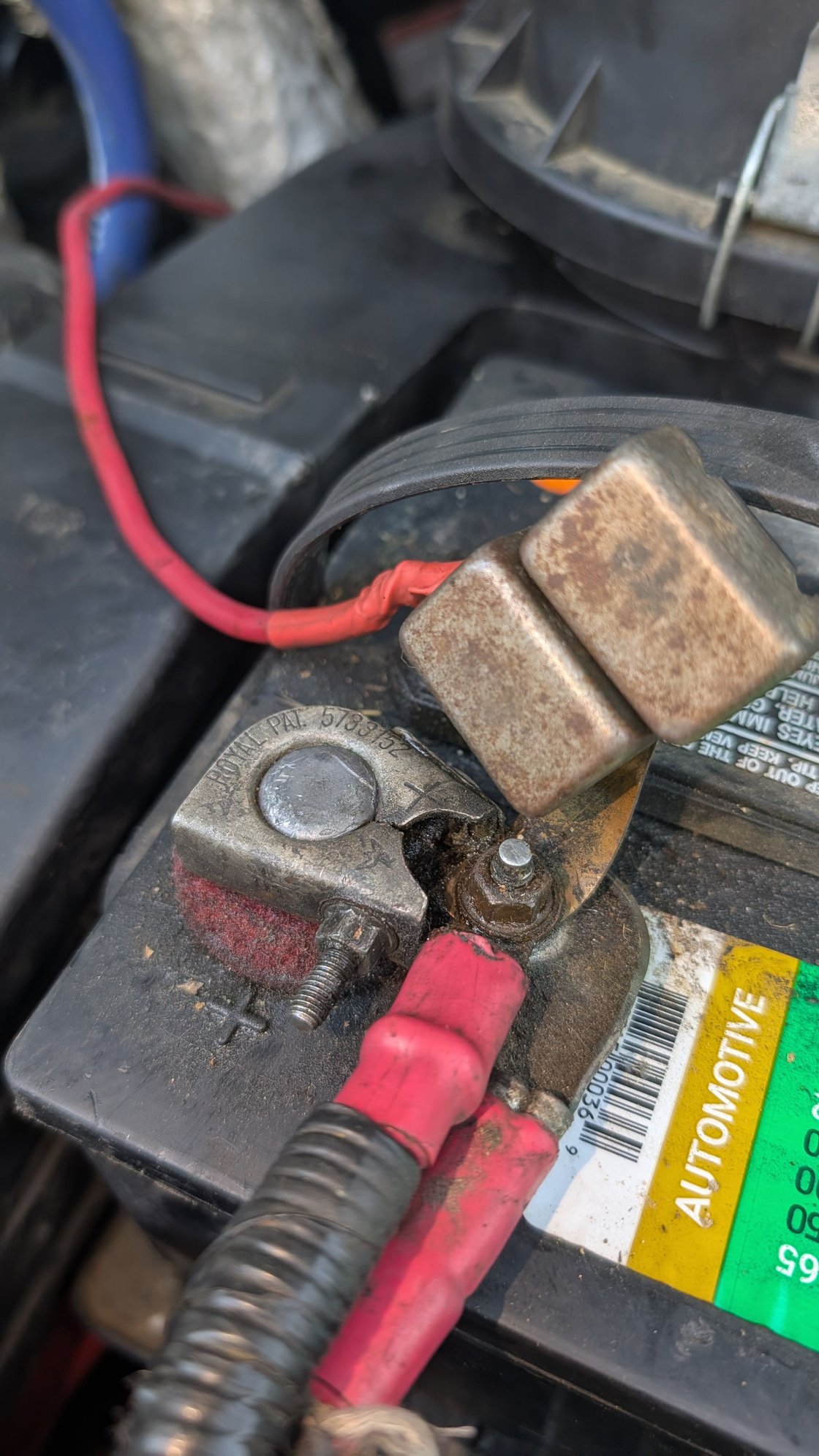

I took these off to 2 things (fuses?) to clean the contacts. The underside of each of these have a copper base and a regular metal base. I lined them up. Copper on one side, regular metal on the other.
Is that correct or irrelevant?
I'm pointing to the base in question.
Also does it matter under which nut this small red wire goes?
Thx gents.

Those are auto reset circuit breakers. Doubled up at that. What is it powering? I would replace with a simple fuse if it were me.

It is not recommended to put two breakers (or fuses) in parallel as it does not reliably double the capacity.
If I’m seeing correctly, with the bus strip attached to both terminals (+ to + and
- to -) of both breakers (parallel) you could attach the wire to either screw on that bus.
But I agree with the above post, to replace with a single breaker, at the required amp rating.

Agree with everyone advising to just go get the correct rating circuit breaker for the load and get it done right.
Here's one at NAPA for less than $5.00, rated at 40 amps and has mounting tabs for a more secure installation just for an example. I use them all the time for protecting the charging circuit on auxiliary batteries so a deeply discharged battery doesn't overheat the alternator.
https://www.napaonline.com/en/p/BK_7823116
Copied, pasted from a Google search on the polarity of those circuit breakers:
A 12V auto-reset circuit breaker is wired in-line on the positive (red) wire between the battery and the accessory. The "BAT" (or "LINE") stud connects to the positive power source, while the "AUX" (or "LOAD") stud connects to the device, protecting against overcurrent by cycling power until the overload is removed.

Ok so then this is not factory? I'm quite surprised because this was a company truck and they didn't add anything to the truck.. Unless it was tow hitch related...hmmm....
Need to run down that wire.
All this time I assumed it was factory... Or installed by Ford dealer.
Thx for the advice

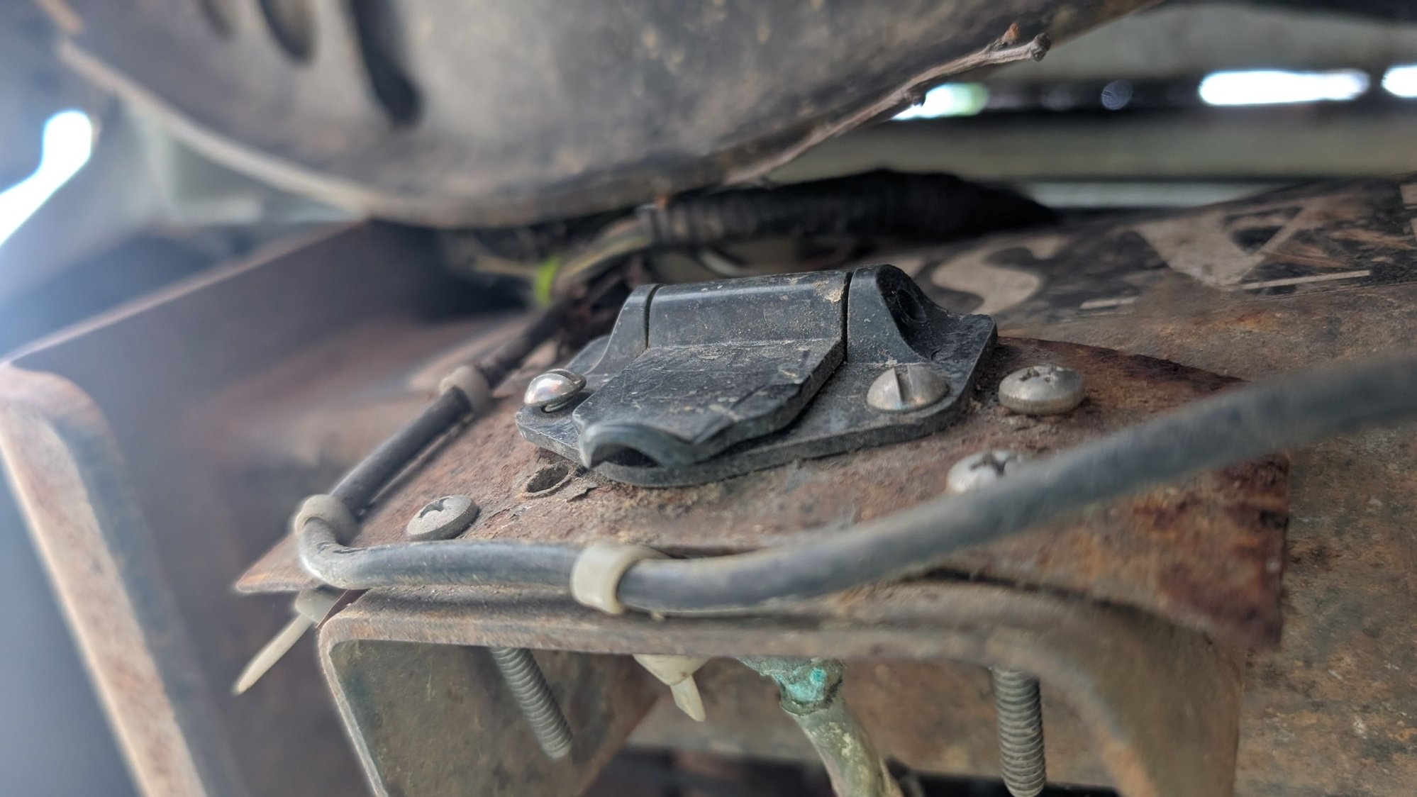

I chased down the wire...it ,looks like a retrofit 2 pin hitch connector Ive never made use of. It so rusty Id be amazed if it worked.

That’s pretty good size cable….. I ran something similar to my truck bed
with 6AWG and a 60 amp breaker by the battery for my Victron 12/12/30 DC to DC charger to maintain my 280AH LiFePo4 battery in my truck bed camper.
almost makes me wonder if yours wasn’t for a pull behind camper or work trailer with its own house battery
