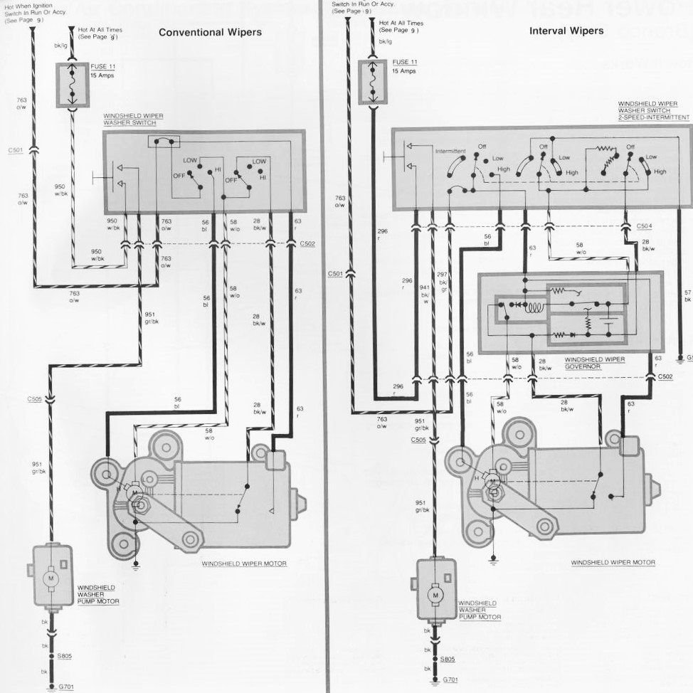

Simple wiring question

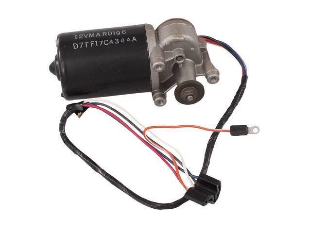

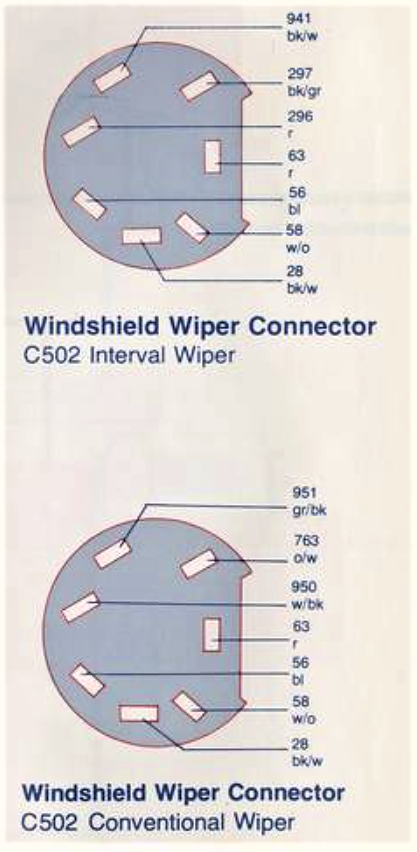

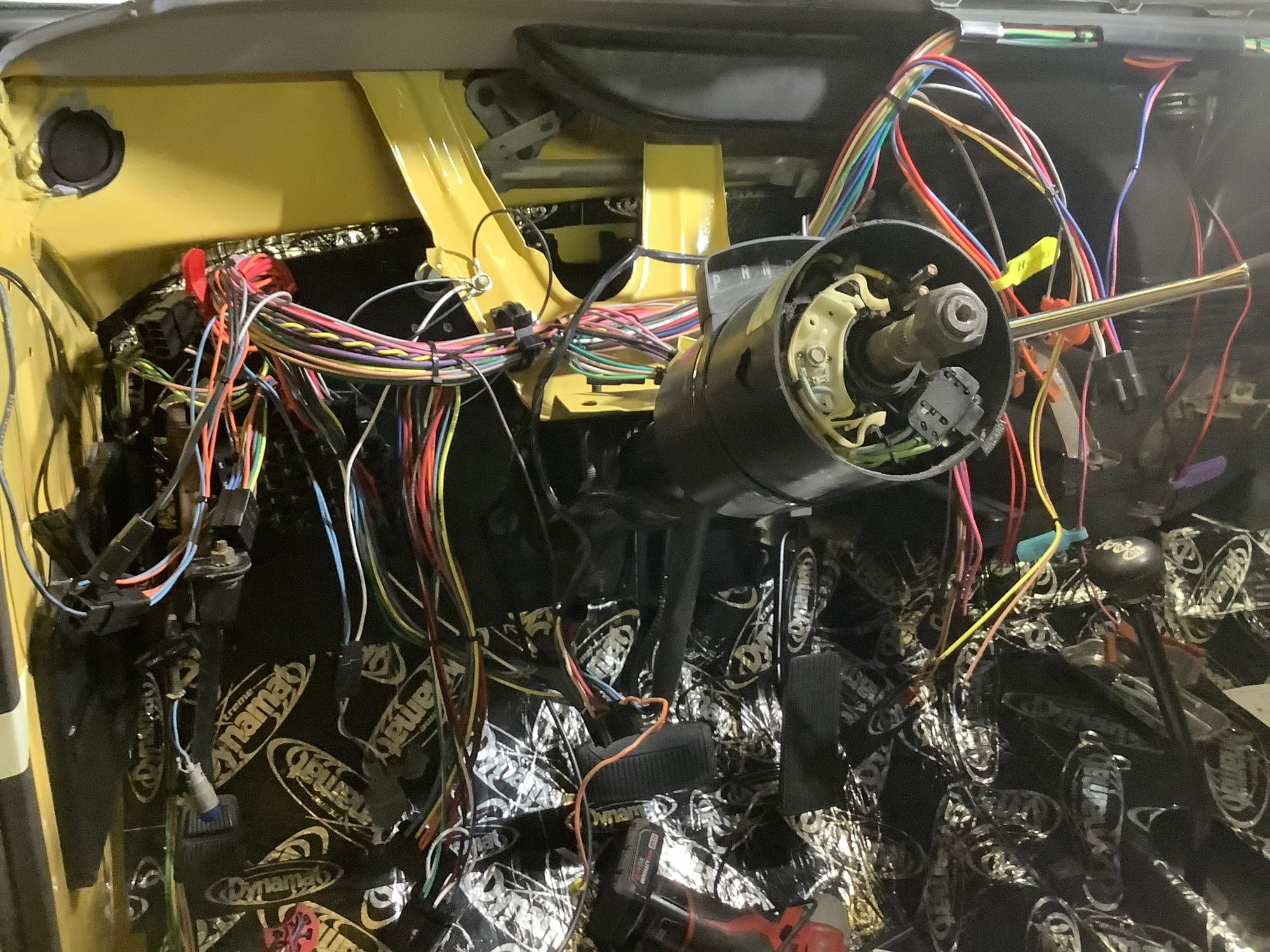

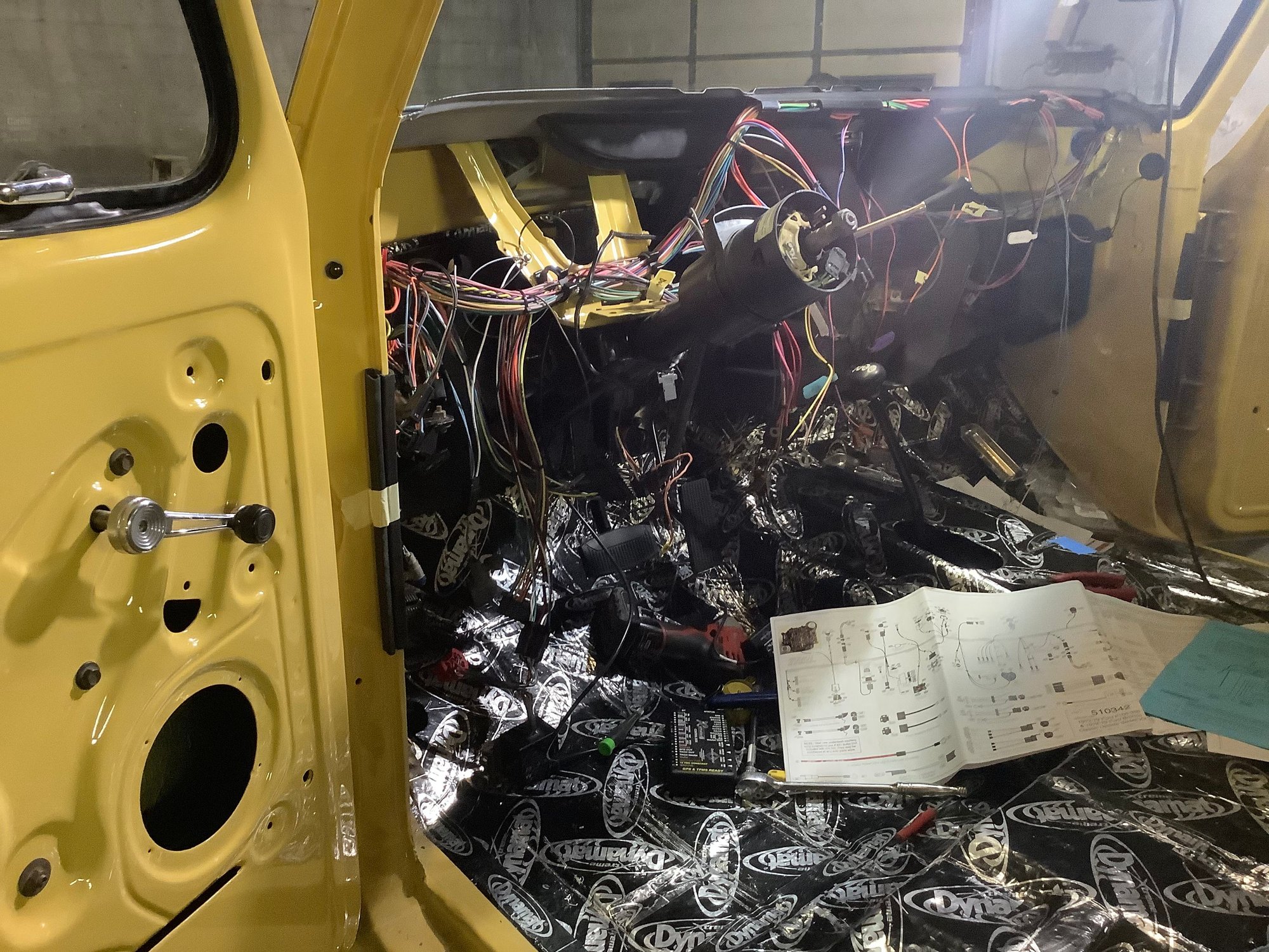

What is the orange wire for and what does the connector that powers look like? I don’t see a plug that looks like it fits it on my old harness and my orange wire has a bullet end on it and I don’t see where it would plug-in either.
Old Oct 22, 2022 | 05:05 PM
dlburch's Avatar
dlburch
Joined: Jul 2005
Posts: 2,313
Likes: 367
From: Kansas

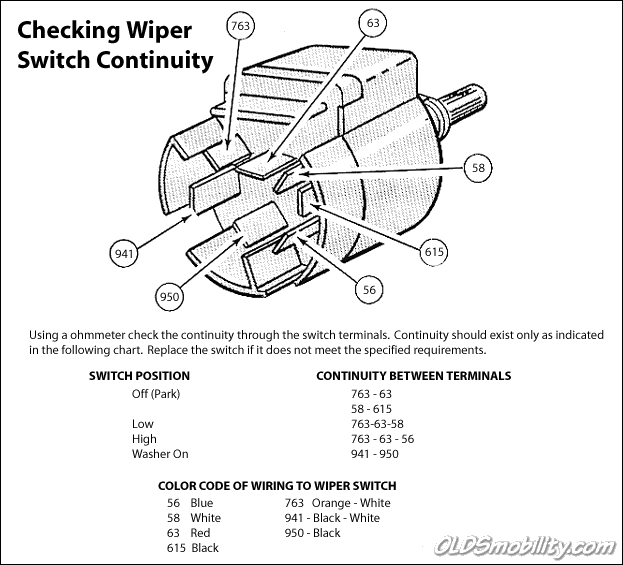

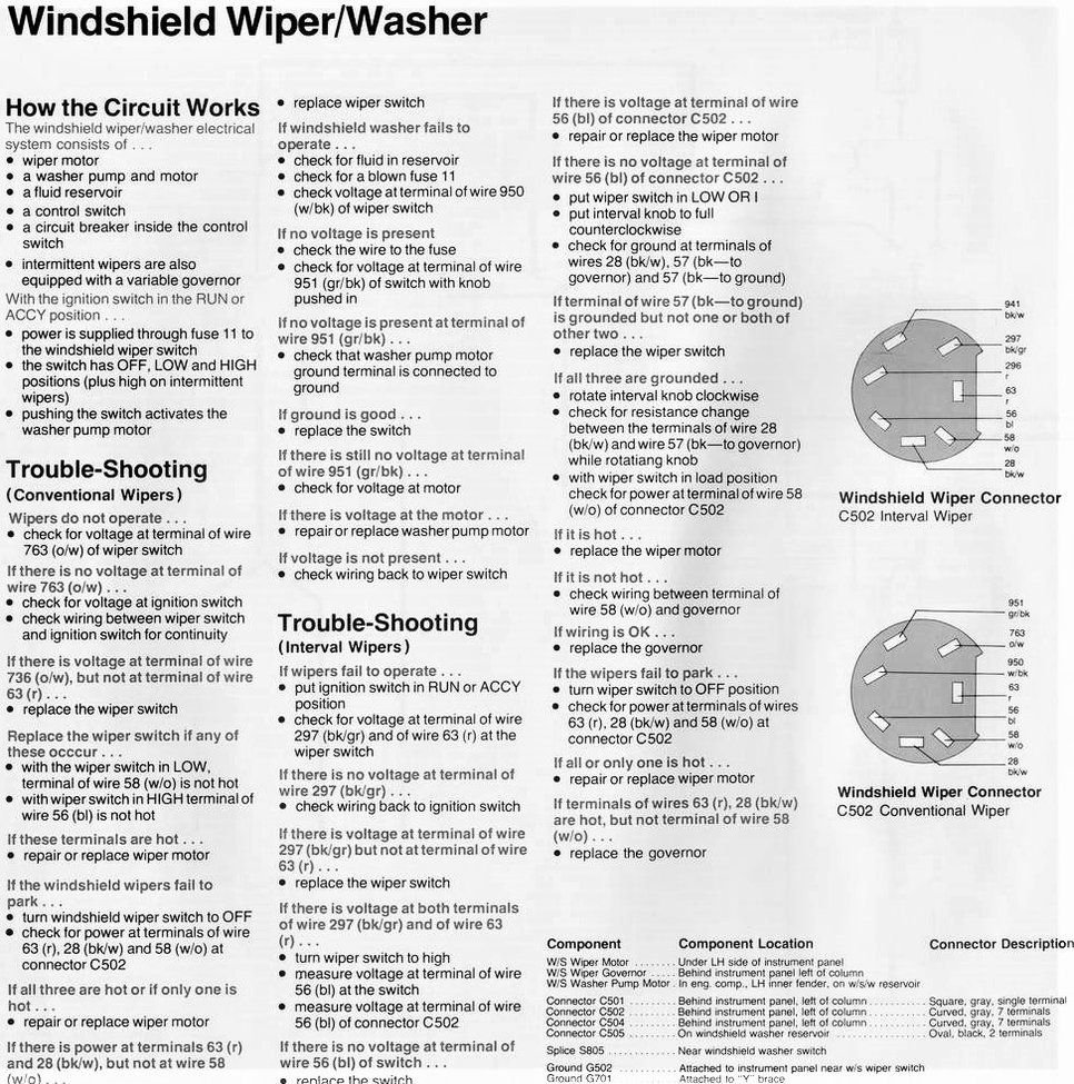

your bullet connector plugged into the yellow, three hole connector that provides switched 12v to the wiper...not sure why the new one has an eyelet.

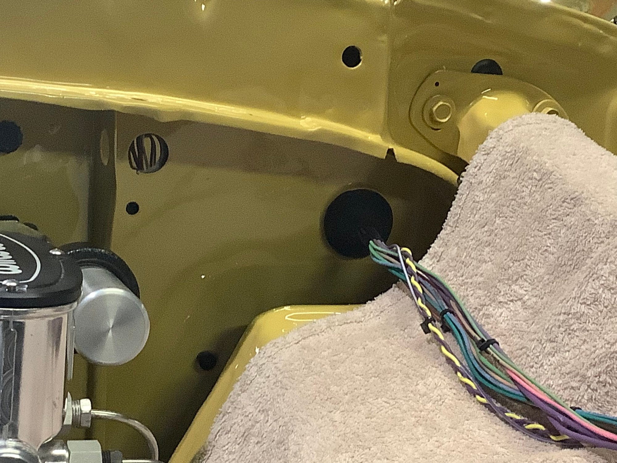

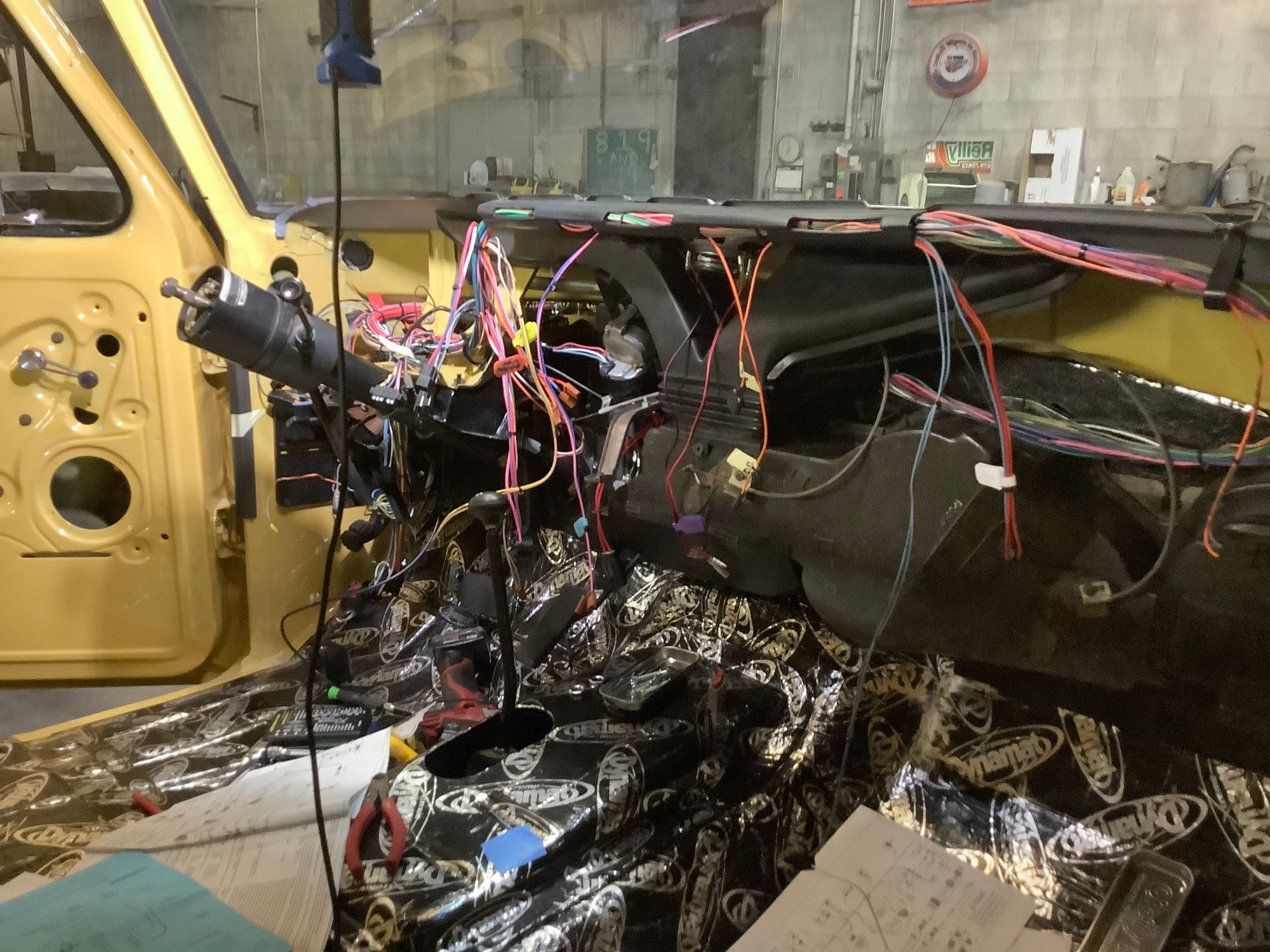

Putting in a new harness and it feels like I am at Olive Garden.
Old Oct 23, 2022 | 09:27 AM
nutter3's Avatar
nutter3
Joined: Jan 2014
Posts: 1,077
Likes: 500
From: Kenai

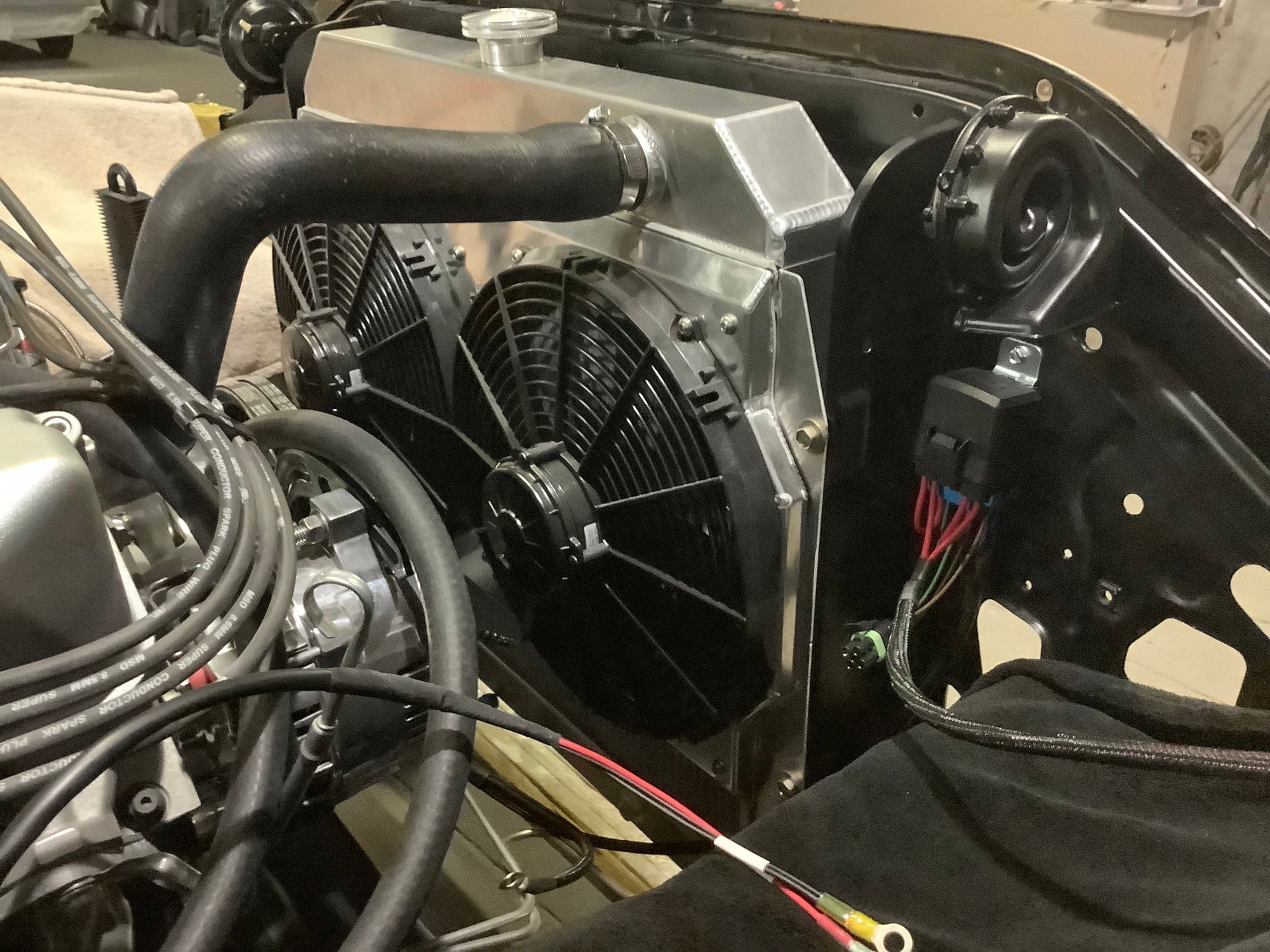

What brand of harness did you go with? Where are you installing the fuse block? This is an upcoming project for me with a centech harness I have purchased for my 75.
Old Oct 23, 2022 | 09:44 AM
73 hi-boy 428 fe's Avatar
73 hi-boy 428 fe
Joined: Jan 2005
Posts: 1,011
Likes: 232
I am using American Autowire, the fuse box goes in the exact location as the original. It even uses the same holes to mount. Have the Edelbrock pro flo 4 harness and the Dakota digital stiff to all merge together.
