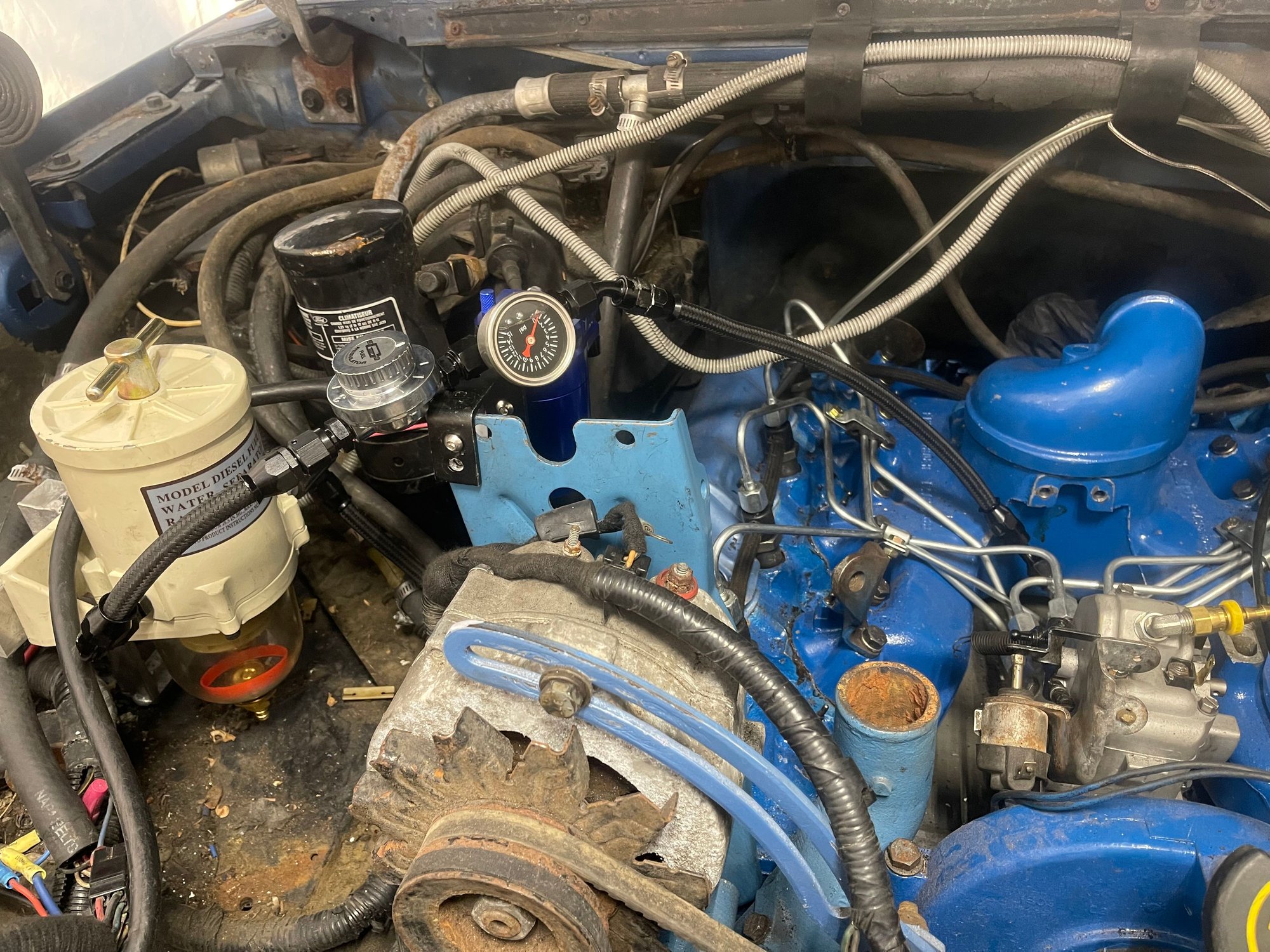

As mentioned before, I just replaced the valley pan.
Used new return line, seals, and caps, and used my own aftermarket screw hose clamps instead of those spring steel ones.
There's no fluid collecting on the pan, and only a couple very minor cap leaks.

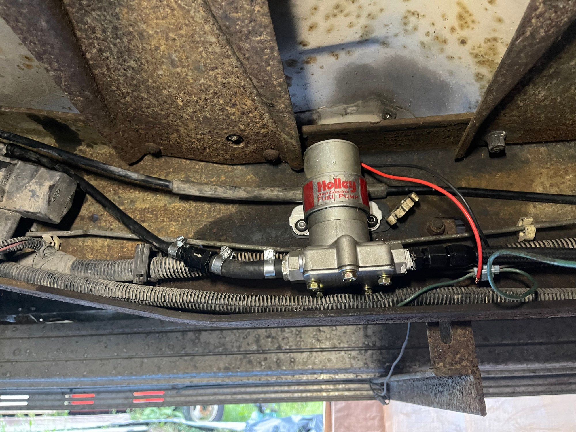

I had also deleted the mechanical fuel pump, put a Holley Red on the frame rail at the tank.

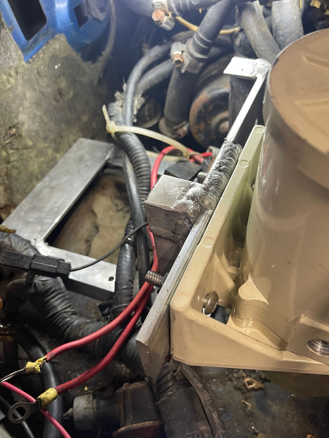

I then ran AN6 from the new pump to a Racor 500 clone I fabricated a mount bracket
Separator Bracket
Separator Bracket
Relays
Relays
Red Set
Red Set
Fuel pump and Diesel heater relays
where the OEM tire jack was to mount it, due to the water separator is plastic, and I didn't want to chance a rock breaking it if I located it on the rail.
I used the back side of the bracket for the power strip and relays.
Fuel supply Front
Fuel supply Front
I just realized I never touched or looked at the return line from engine to tank solenoid/valve.
I deleted that as they cut 1 1/2' off the frame to make a Bronco, and there's never going to be a 2nd tank.
(They pulled the tank switch out of the dash, tapped it to "rear" with cheap electrical tape, and stuffed it against the rear of the firewall).
I only found it because I had to swap the brake pedal assembly to a brake/clutch one for the ZF5.
