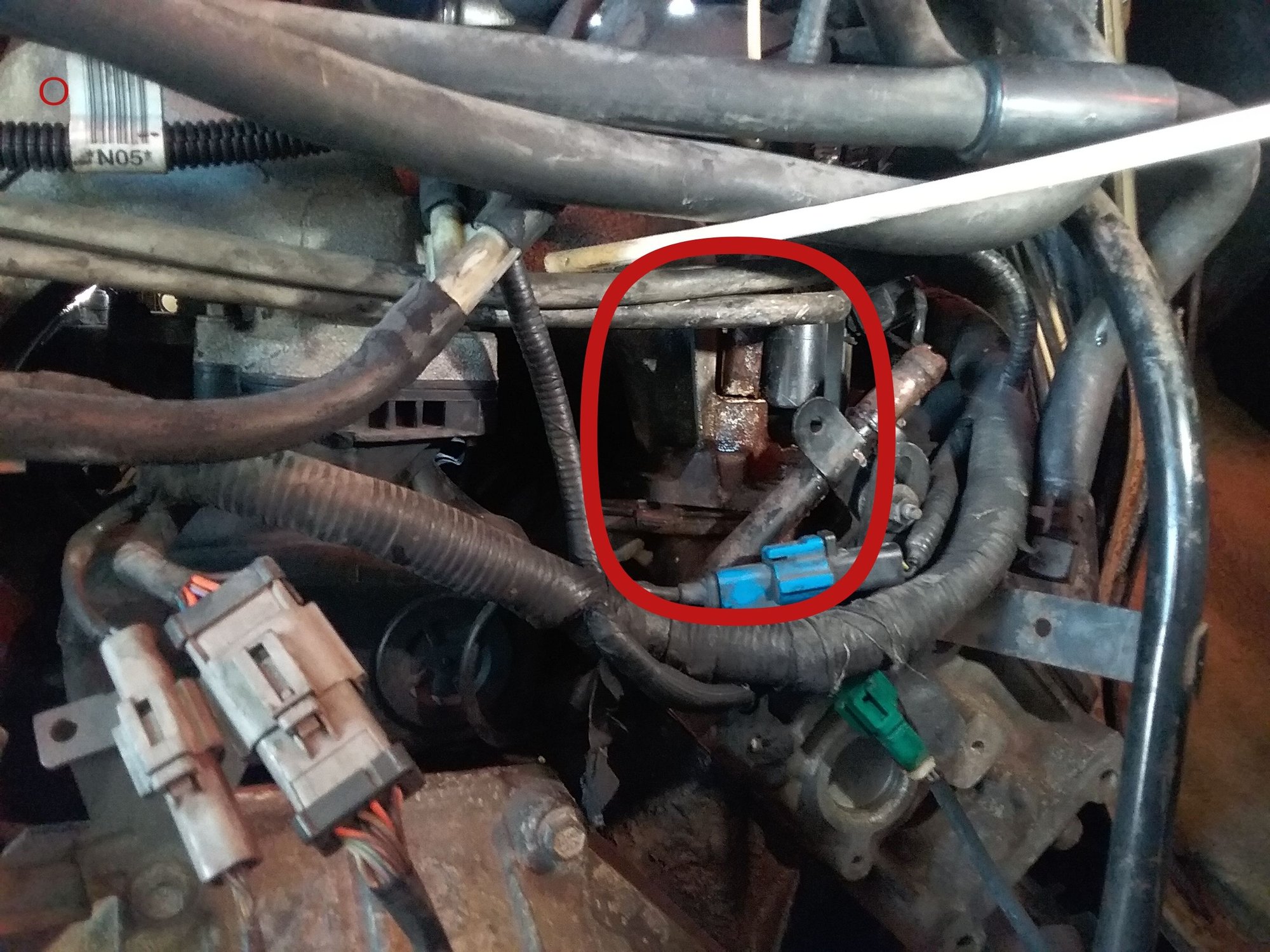

Originally Posted by JWA
See if any coolant can be seen leaking from the metal tube running from the heater core...
Well, that was it!
It let loose last night. Water just poured out.
Can someone tell me what this part is called? (Trying to post a photo here) And maybe how to remove it? I do have a manual, but I'm not home and I'm not finding it right away.
At the right rear of engine.
Well, that was it!

perhaps this is the heater tube to intake manifold? Looks like it clamps in one of the heater hoses and the other end slides into the intake with some O-Rings down inside that seal the tube. I am just guessing that there are O-Rings down inside the hole in the intake where the tube goes. Last year I helped my son with hit 94 regal and it had a tube that pressed into the water pump. There were 2 O-rings that had to be installed and then we had a heck of a time getting the pipe back in! Maybe yours is different, I don't know.
https://www.ebay.com/itm/Dorman-Heat...-/131257962350

It is press fit and sucks. You will probably have to cut off the old one and use a screwdriver and hammer to remove the remnants in the intake. Did the one on my expedition when I had the intake off. On a van it may not be as bad but its a pain to get out. Some gasket sealant and lots of force and cussing will reseat it. Be careful not to bend/break the pipe.

I can't see what these photos are supposed to show so can't offer any suggestions what to do etc.

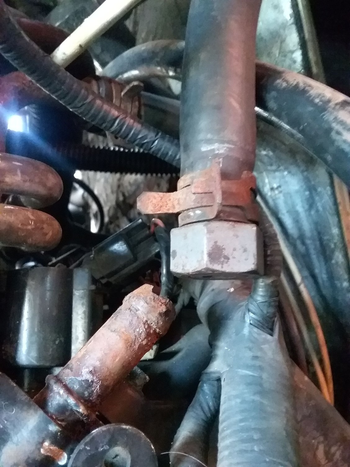

Trying to post 2 more pics.
I thought that tube was split, but apparently it has a crack at the bottom. It looks like someone tried to epoxy it previously. Scraped that stuff off, and I see this crack.
I'm not sure how that's held in there. Maybe a press-fit?

A better shot of that whole part/tube.

Is your intake manifold cast aluminum or the more typical standard plastic version?
It appears to be aluminum, if that's the case the cracked tube would have been pressed into place at the factory. Using an E-Z Out or similar the portion still in the manifold could be removed and a replacement tube inserted. The best bet would be a replacement part from Ford or if Annaleighs linked part is spec'd for your year, make, model and engine type it would be quicker to find I'm sure.
IF your manifold is plastic this might necessitate replacing it completely---never seen this sort of arrangement so can't say for certain. Given the age (if plastic) and this is a keeper truck you might consider that option.
No idea why that heater core hose is disconnected but its likely or reasonable the core or one of the connected hoses is leaking at their connection points on the core itself.
