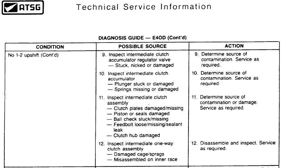

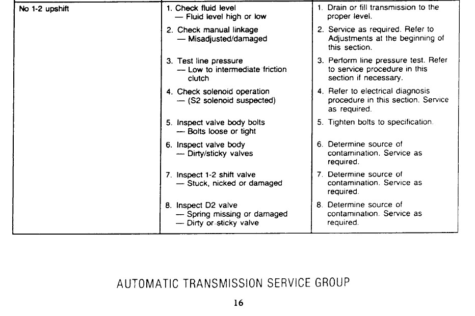

That sucks. So you only get a code telling you, what you already know; a 1-2 shift problem. This means you need to hunt down the problem manually.
You actually don't need a fancy device to see if your pcm is commanding the shift or not. I think it is of course, because it's doing so; just late. Why late, and why only when warm? Here's the list of a no 1-2 shift.

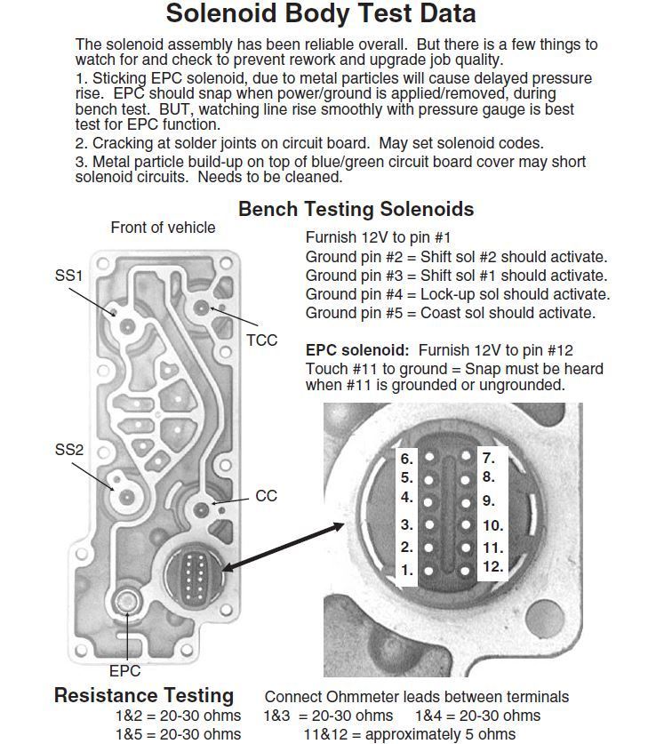

How to test solenoids:

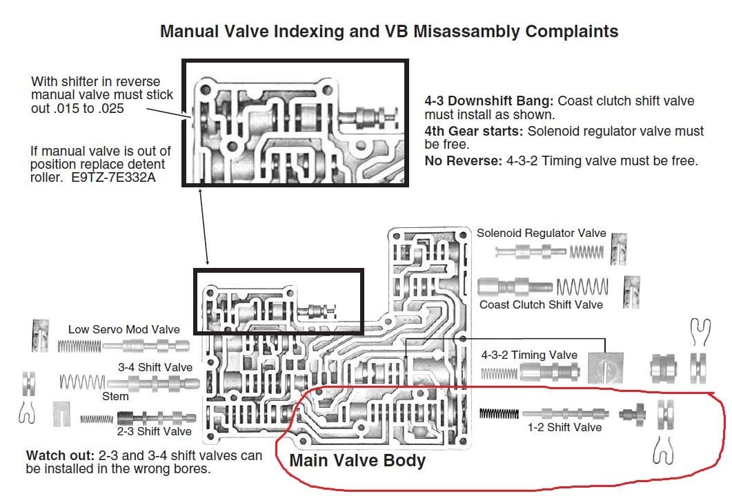

Here is the 1-2 shift valve location, if you want to pull it and inspect it for sticking.

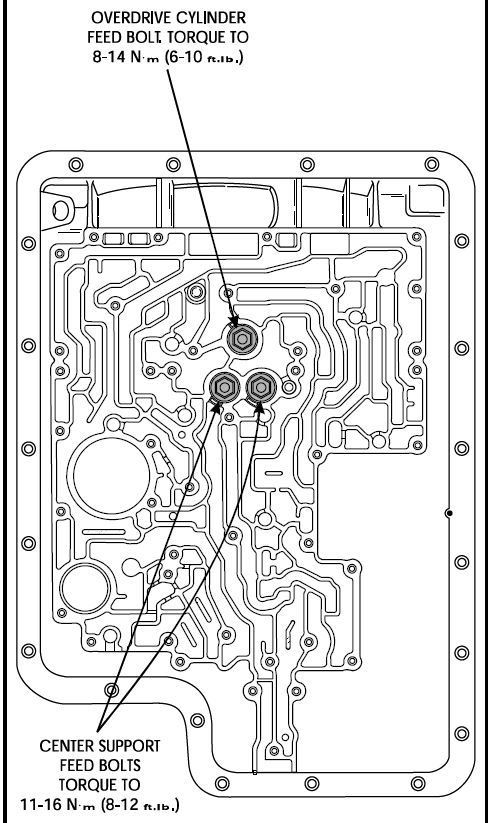

Feed bolts:
(You have to drop the valve bodies. Don't lose check *****!)
