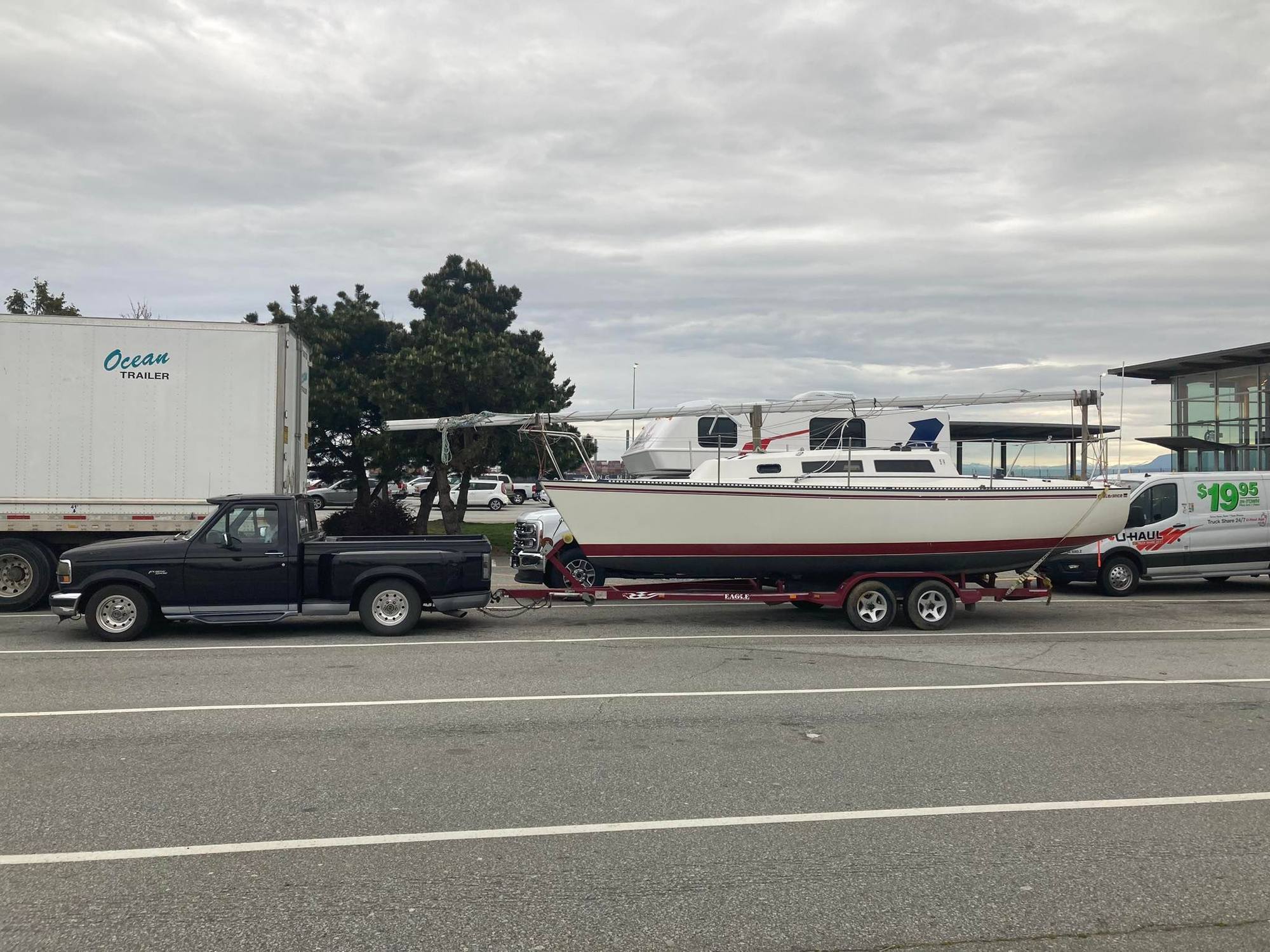

I tow all the time, stock rear tires, tow +4500lbs all day long, lowered.
My old truck had 6" lowering, stock tires, tow all day long, axle to frame bumpers were 1" with a 1/2 yard of gravel.
Truck GVWR 6800lbs, short box regular cab.
