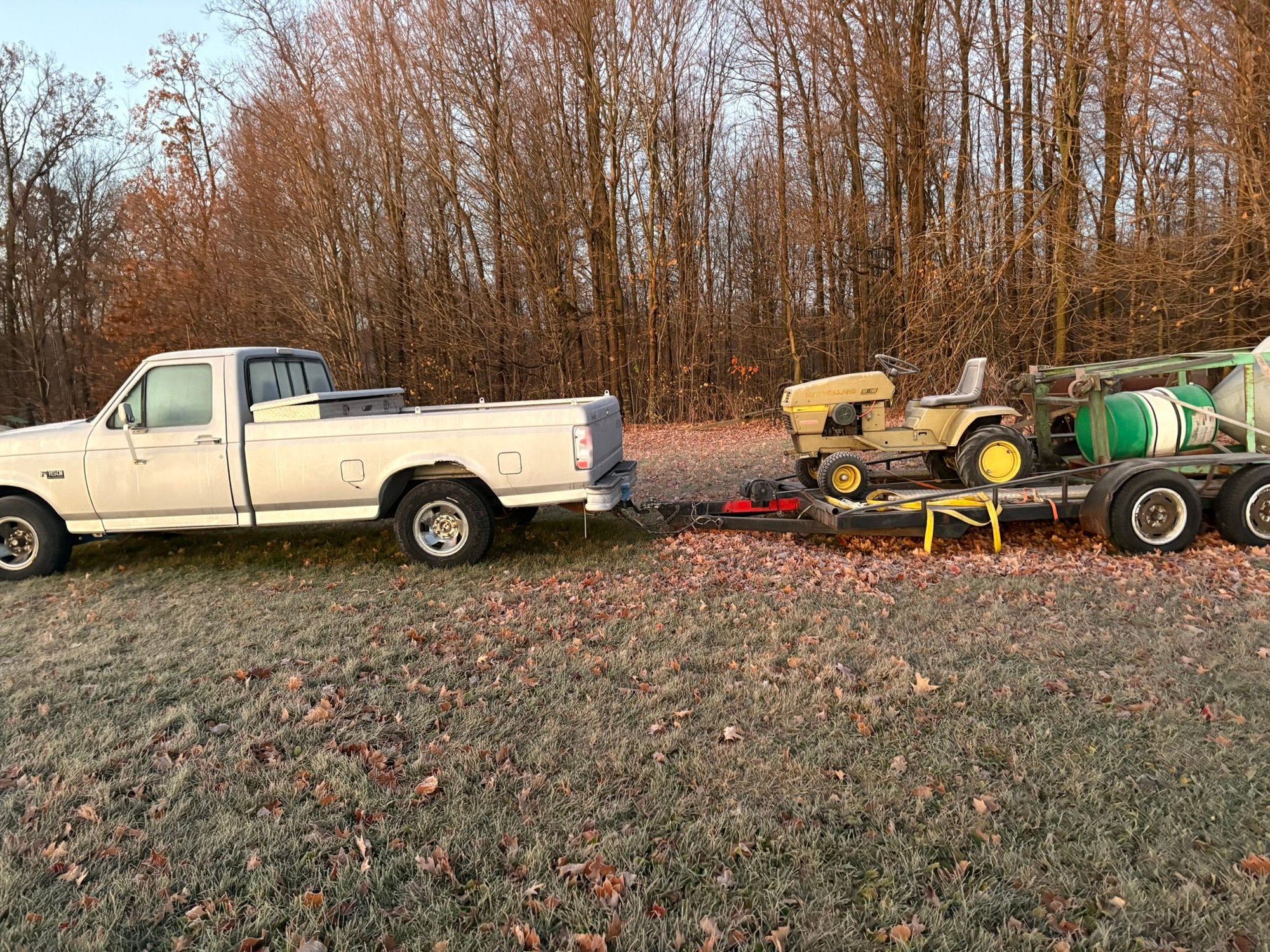

i was impressed at the fuel mileage my 300 inline 6 got while towing a fairly heavy load, against wind, at 70mph in hilly terrain with stock 235(whichever other numbers) tire size and 2wd and 3.08 rear ratio in late 2024

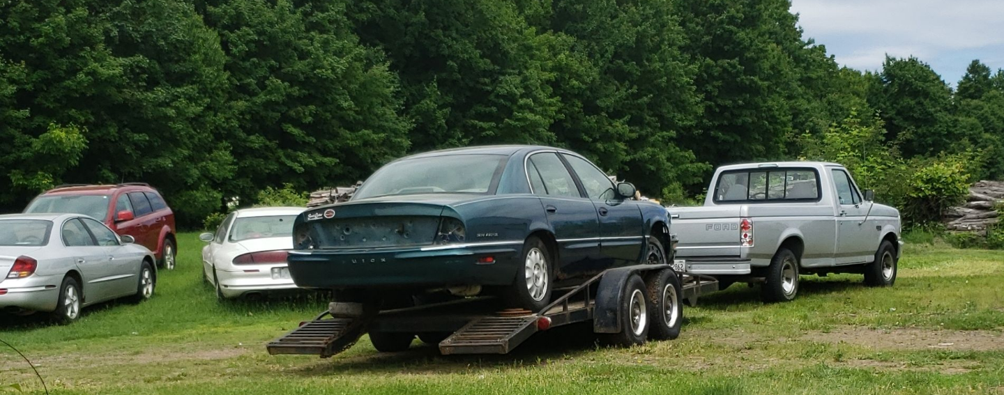

ive pulled 2 cars of this weight (4,000 pound cars, fairly aerodynamic because the front ends were below the height of the cab so air can slip over

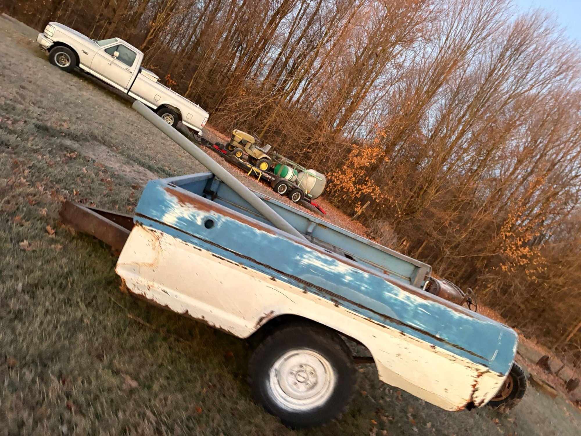

I had positioned this giant hopper thing backwards on the trailer (my dads suggestion) and this is what i pulled on the hilly terrain I mentioned
however, that 3.08 ratio really makes off the line painful for everyone nearby (either stuck behind me or me trying to get up to speed)
The exhaust of the inline 6 tho, sounds really nice when its loaded. doesnt complain but it performs without a fight. I would like to compare to a 3.55 ratio that i hope to some day swap in.

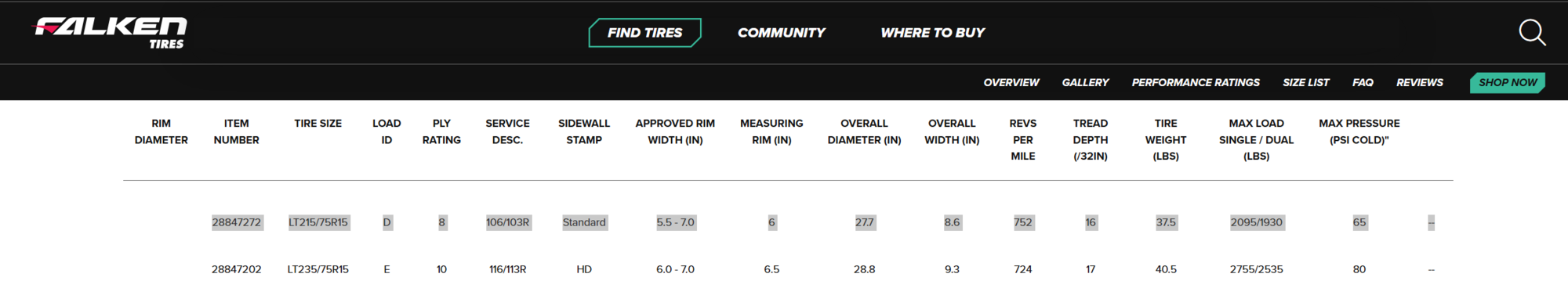

if you wanted to have the shorter of the 2 sizes, it looks like falken DOES sell a 215 in Load Range D This is only mentioned because as of like 2 years ago, Falken was the only one that I knew of that made a 10 ply 15 inch tire( the second one in this picture above )
