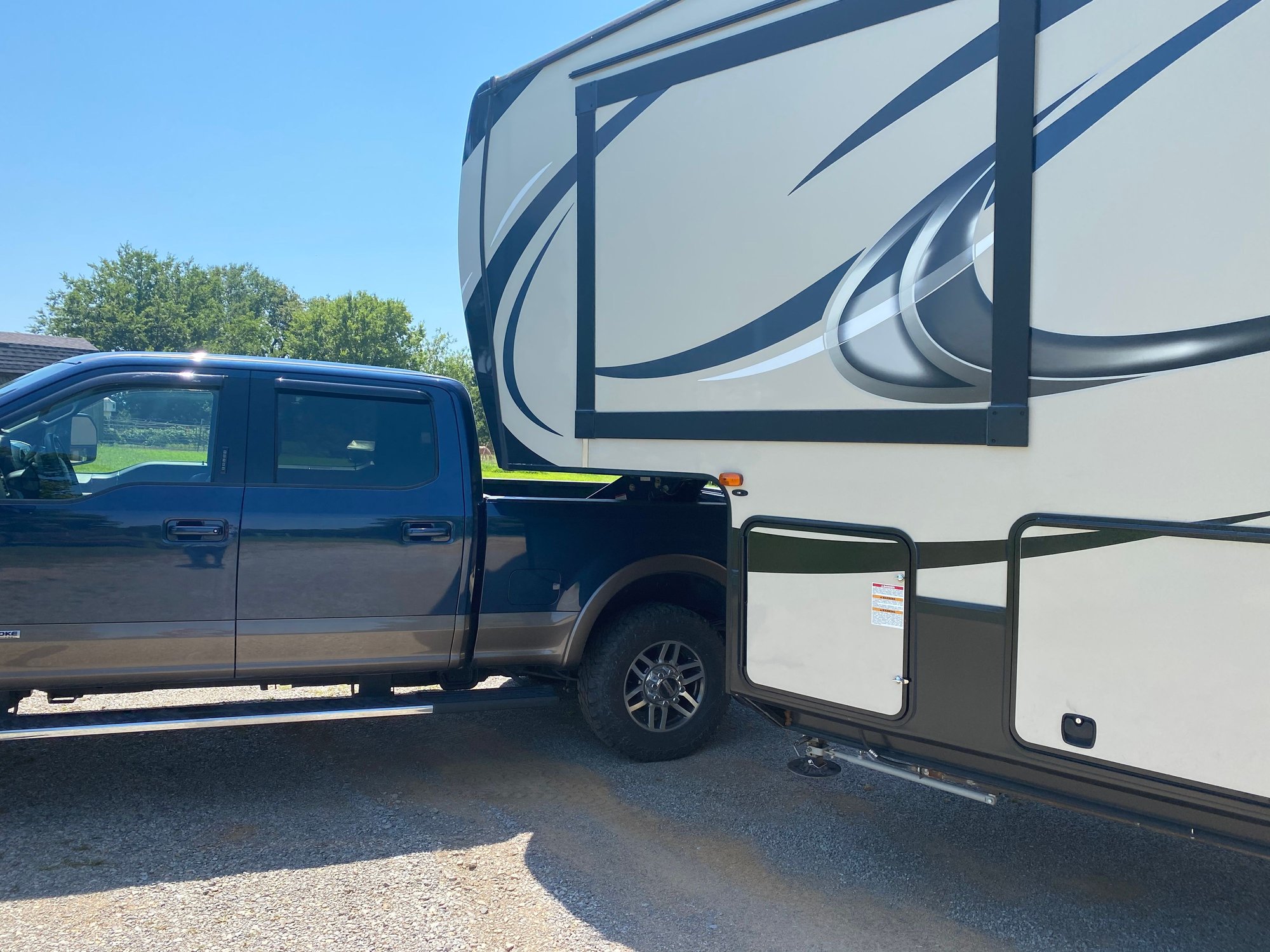

Looks like MORyde, Gen-Y and Reese all still make gooseneck adapters that are accepted by Lippert. I love my Goose Box and will never go back to 5th wheeling. I don't miss heavy hitches or lost bed space.

I believe it was actually 2 3/8" shorter, but I'd take anyone over a 5th wheel hitch. My Goose Box with my KZ, I could've turned tighter but I didn't have a spotter.
