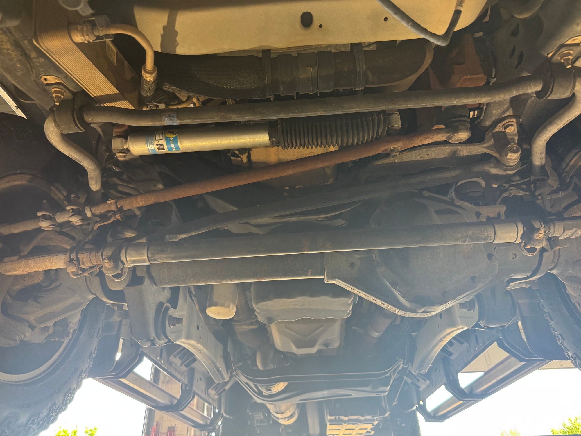

Front end worn out
2012 F250 Lariat - 158k miles
I had front end rebuilt by a shop at 80k miles. Now at 158k, my front end feels loose as hell, I hear clunking and i started getting death wobble when hitting seams on overpasses on the interstate.
I took it in and got new tires today and they put it up on alignment rack to check it. The alignment wasn't too bad but holy hell the lower tie rod (forgive my terminology) is so loose, i can move it freely with 2 fingers and it makes the sound i hear when driving and feel the clunking,.
I'm on a budget and looking for a part or kit to fix the problem. I have lifetime alignment so if i know what parts to replace, i can take it in and get aligned for free.
Am i dumb in thinking i can just replace the lower tie rod ends and be ok for awhile?
Thanks

Old Apr 11, 2026 | 10:03 AM
c0mm0's Avatar
c0mm0
Trailering
Joined: Dec 2014
Posts: 23
Crap alignment tech
So I went in and had the alignment checked. They said it was dead on (true) and said nothing was wrong with my front end which is bull**** because I can hear it slapping while I’m driving.
So I took a video underneath. Jacked up and had gf turn wheel back and forth. My tire rods are completely wore out. I didn’t see or feel much movement anywhere else, didnt see feel anything in drag link, track bar feels solid, it feels/looks like mostly the upper and lower tie rods.
https://streamable.com/oxucrl
What tools do I need to rent from AutoZone to press those ball joints out and pull the tire rods?
