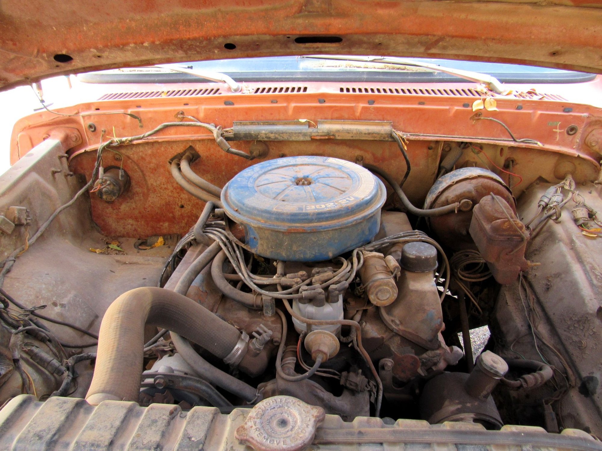

When I bought my '76 it had this 1966 390 2V out of a Mercury in and it was only running on 7 cyl.
And here's the culprit, a totally oil fouled sparkplug in the number 5 cylinder.
A fresh set of plugs, some timing and carb adjusting and it back running on all 8.
265 HP, 375lb/ft of torque and 9.5:1 compression.
It was actually pretty impressive with just how well it ran.
I took my friend that I bought the truck from and he was actually shocked at how good it ran.
The power was pretty impressive.
