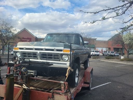

I have a 1976 F250 with a 390 that is whooped. i have a 460 out of a 1982 ford motorhome I'm planning on swapping into the truck. i have the mounts i got off of bronco grave yard and i have a bellhousing off a ford 400. my question is what flywheel and clutch should i use for this swap. I'm concerned about balancing and fitment or would it just be better to rebuild the engine? any help will be appreciated.
