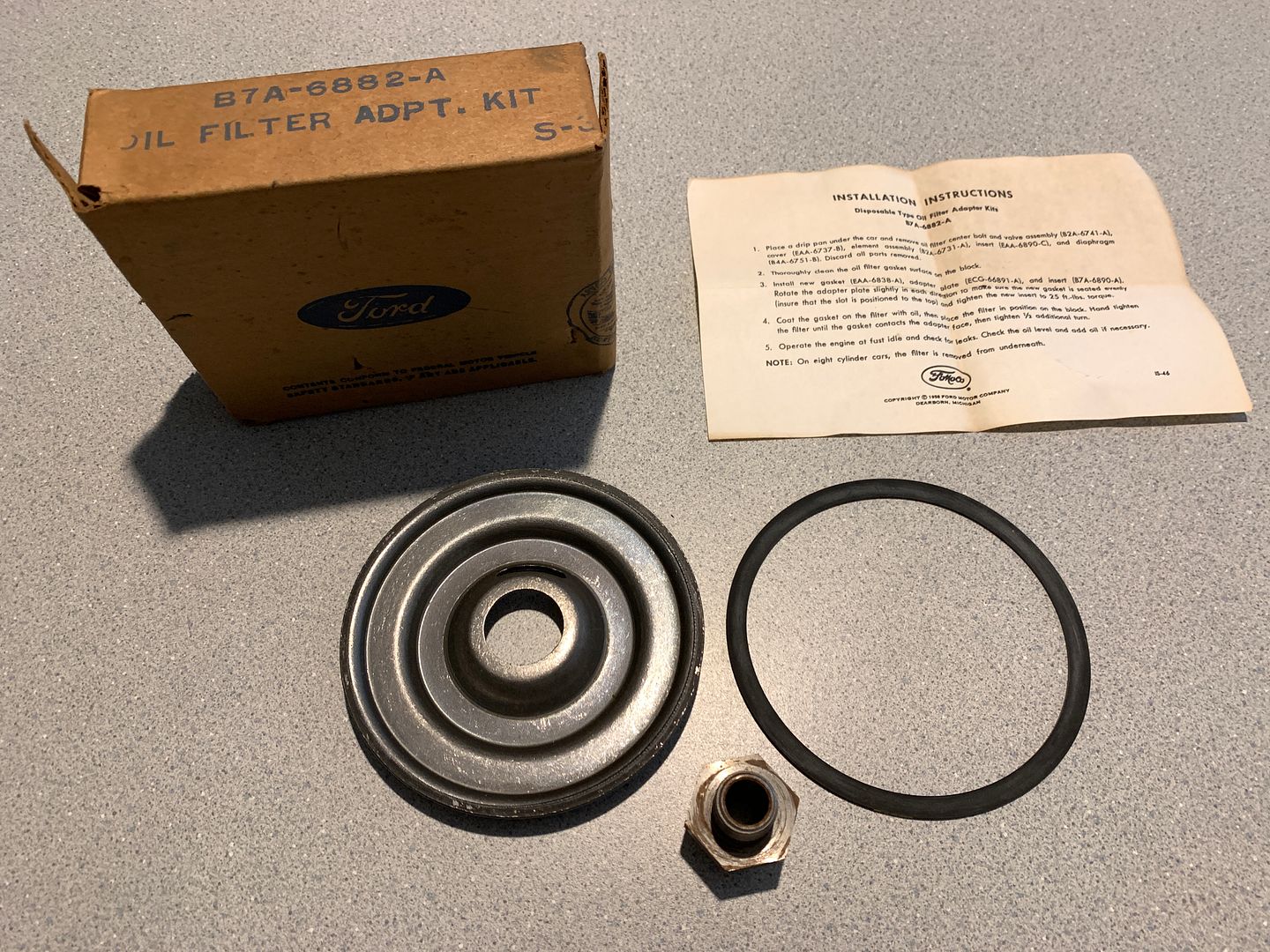

The thin gasket may be contributing to the problem. Another thing people often do it torque the adapter too tight. The directions provided with this kit says just 25 ft.-lbs. torque. It also talks about seating the gasket well by turning the plate. It's been a while since I held it, but it seems like the gasket was not all that thin. More of a black fibrous material. Is your new plate and gasket NOS or aftermarket?

If a non-orgional FORD KIT (NOS) (shown in ILL above) was not used and the kit was CHI-COM, the plate is of thinner gauge and will warp while tightening.
The plate has to be straightened and a quality gasket used, sealed as described above.

So…yes I torqued the nut to 25 ft pounds. Originally the oil was definitely coming from the bottom of the old plate. Now I see the drip running along the bottom side of the filter. What I now did…against my better judgement..was to go beyond hand tight on the filter..not crazy but maybe an inch. That seems to have helped but will keep an eye on it. It COULD be the seam of the filter housing..not sure. Will watch but I did order a different brand filter so if there continues to be a drip I will replace the filter.
