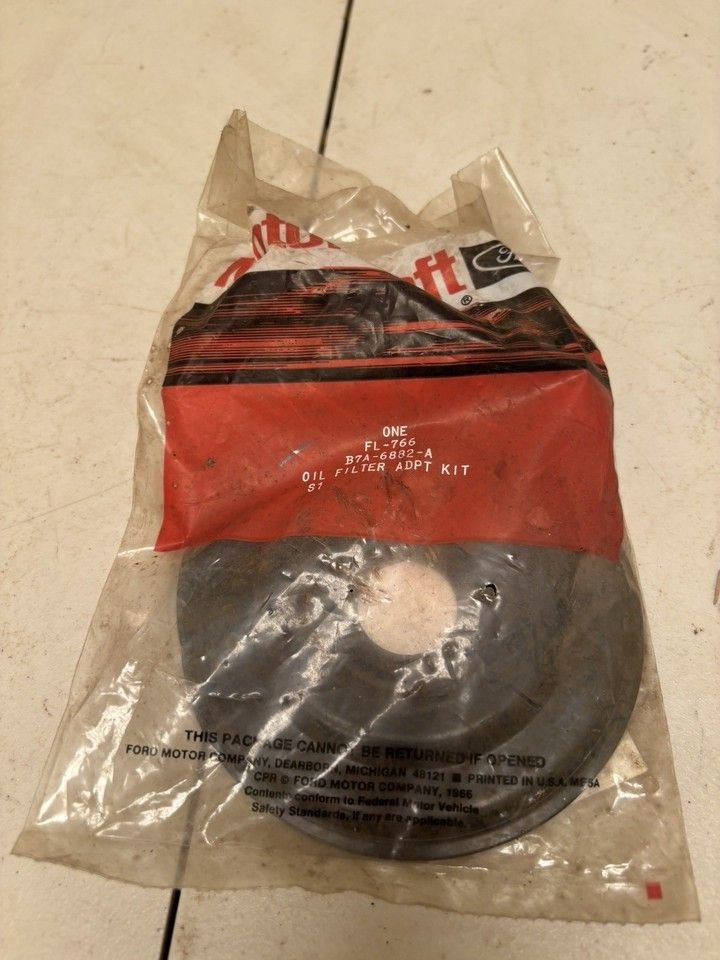

Unless the KIT is GENUINE FORD, it is off-shore junk. The plate warps very easily.
You may still find NOS (B7A 6882-A) on EvilBay.
CLICK HERE - Oil Filter
Also use a quality (FEL-PRO) mounting gasket.

That’s great info. I’ll take the adapter plate off (again) tomorrow and measure it and tap to the 1/16” clearance. My new plate undoubtedly was “offshore” with a chinsy rubber gasket. My old one looked better and will be the one I work with. I’m hoping I didn’t deform my Chinese rubber gasket. I couldn’t find a fel-pro gasket online. Any part numbers that you happen to know?

You can still but the gasket (EAA 6838-A) from a FORD (NEW HOLLAND) TRACTOR dealer. FEL-PRO must have dropped theirs as I cannot find it separately.
CLICK HERE - https://www.yesterdaystractors.com/F..._EAA6838A.html
