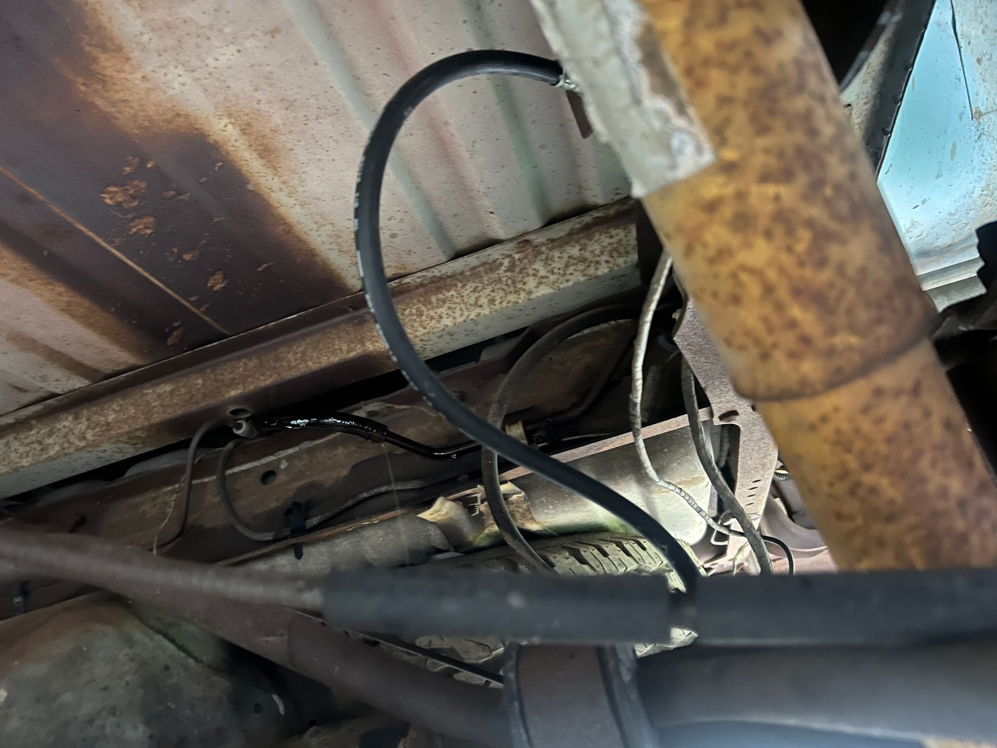

This is where it is leaking from. Running down the black fuel line and dripping off the clamp. Not sure if this black line is cracked or leaking from further up behind the frame support.

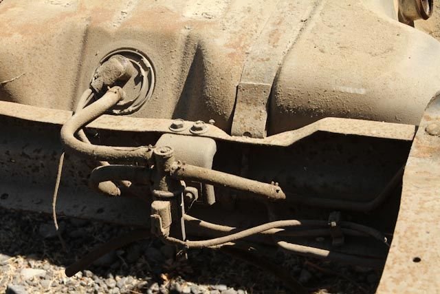

Yes siphon some out, how much.... enough to get it to stop. That looks like the rubber line that is attached to the sending unit and it goes from the hard line (right off the of the sending unit) to rubber then back to hard for the run up the frame rail.
Should have a spring or hose clamp on each end. They dry rot over time. Replace it with EFI rated fuel line, NOT the cheapest they have on hand.

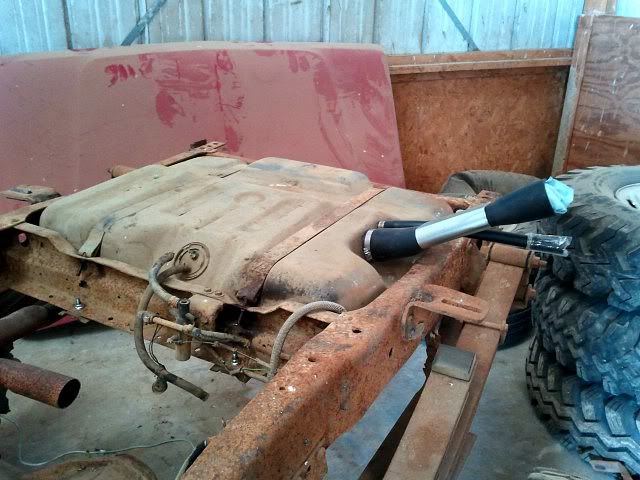

Ever see this self priming hand jiggler siphon hose? No more mouth full of gas...
https://www.harborfreight.com/self-p..._q=siphon+hose
BOTH duel gas tanks set up. But you can see the sending unit and the valve. With a single tank truck NO valve, just rubber from the sending unit tip and to the hard line start point.
