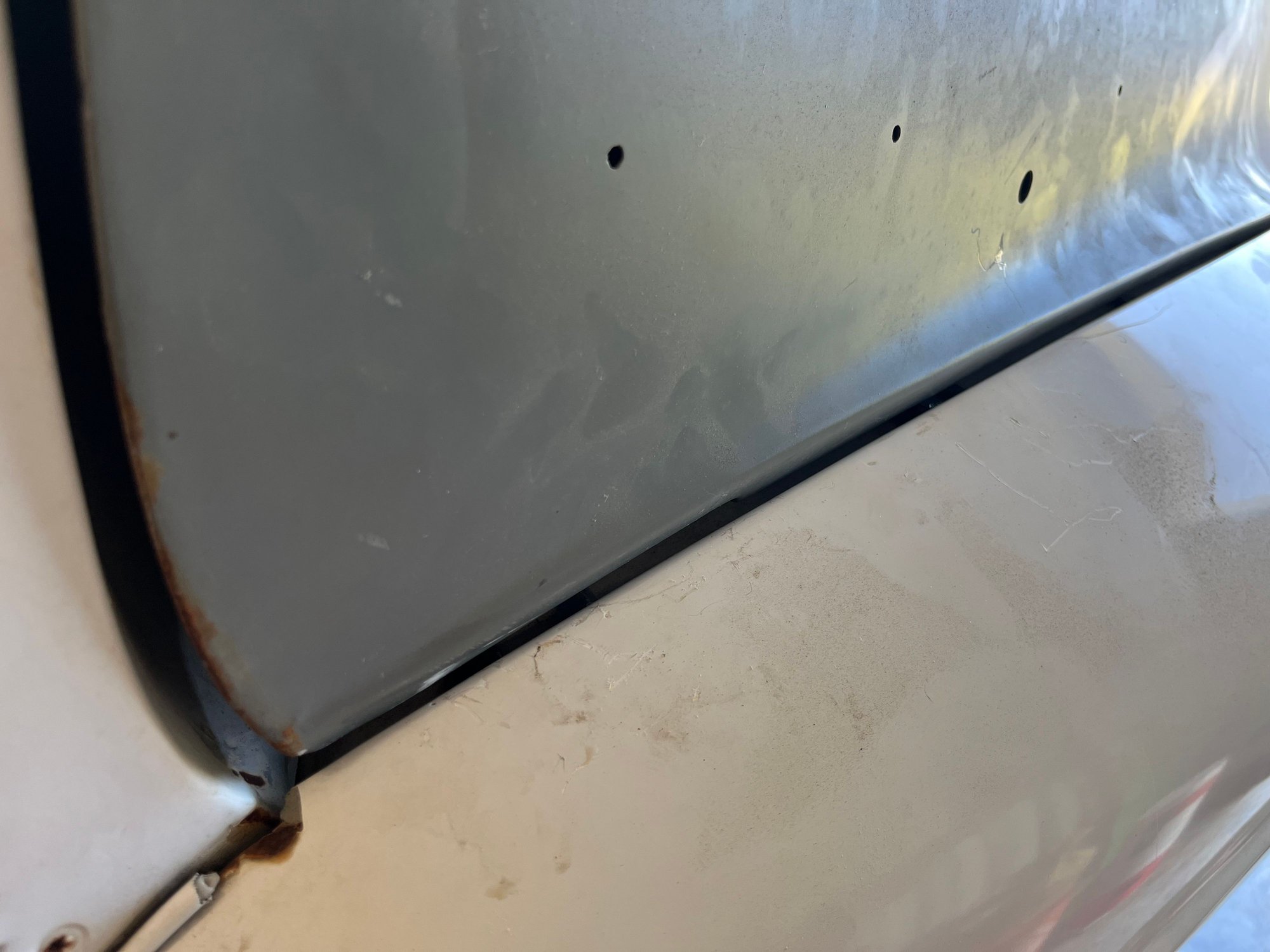

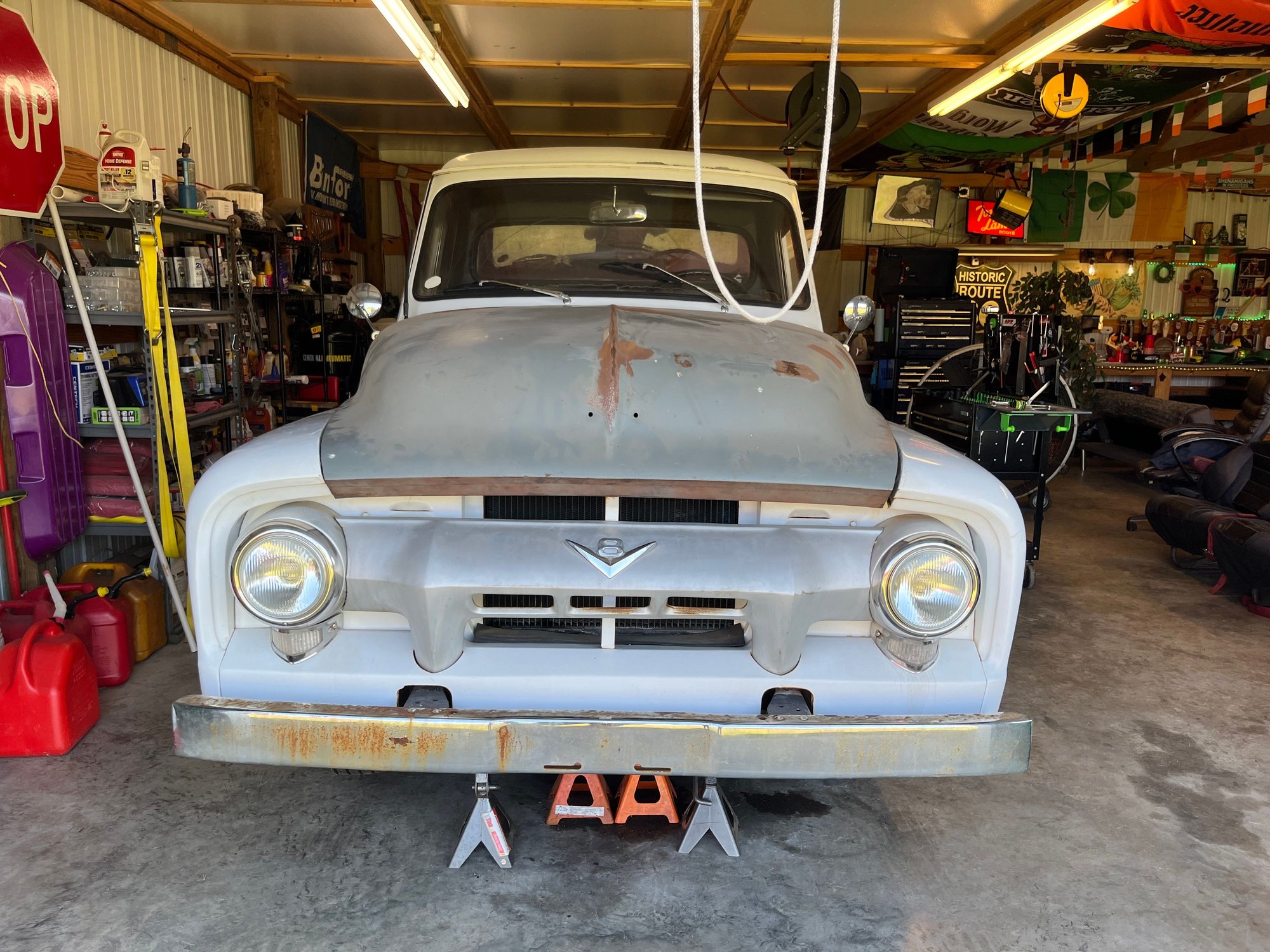

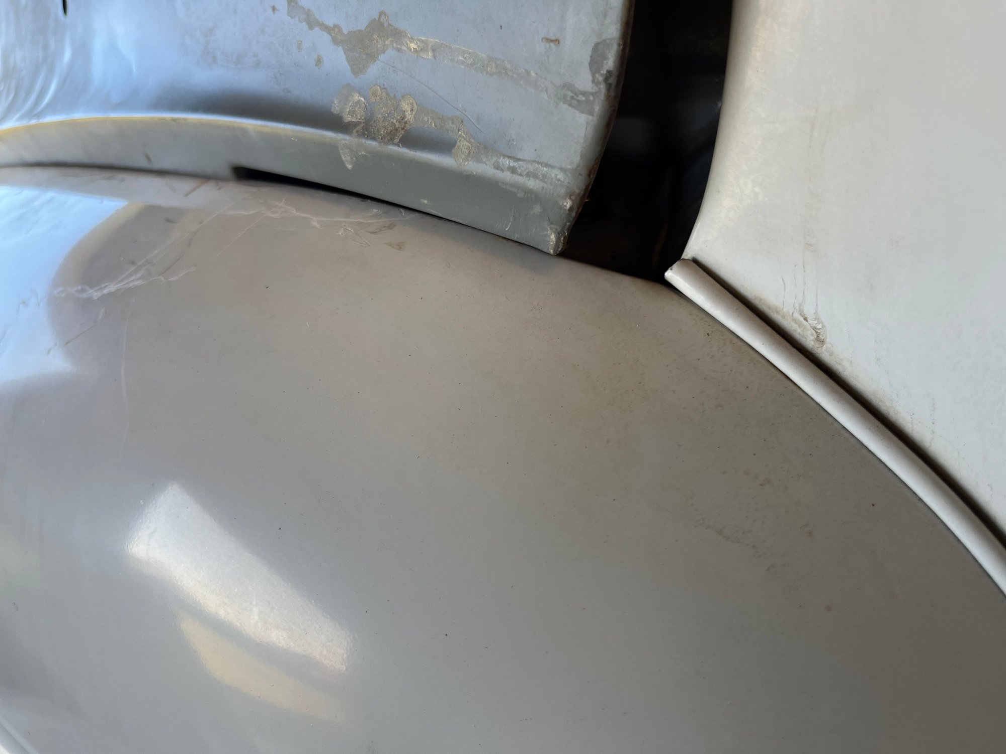

My hood is warped. I am replacing my fiberglass hood that fits with this metal one that does not. I measured them and the metal one is 3/4” wider. I put on a flip kit on today and it works great. There is still a little adjusting to do. But the drivers side roller will not line up and when I push it on the roller it still hits the fender.
thinking about running a adjustable style brace from the top hung hole to the center holes so o can pull it back in. If I do both sides separate I could dial in each side.
Anyone ever done this before?

before I started tweaking the hood I would remove the flip kit and sit the hood in place and see how it fits.
I ended up adjusting the fenders to the hood with the hood just sitting there. I used some cardboard spacers to get the gap and elevation where I wanted it then put the flip kit on.

is it 3/4" wider in the front and back or just the back?

Just the back. The front fits great, needs to go over a bit but not much.
I was thinking of rods with a center adjustment mounted on the bolt’s in the middle running to the top hinge hole. Not sure if that will pull it enough, might have to mount to the bottom holes with the roller.

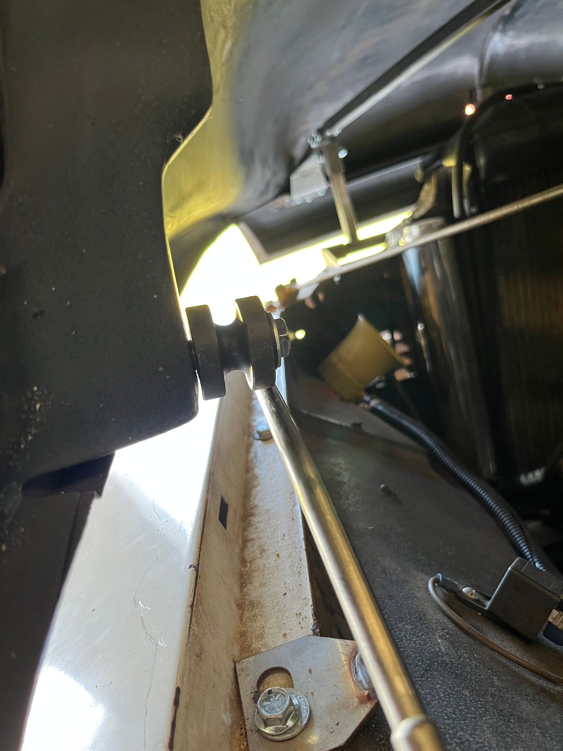

Mine was warped also. He is the set-up I used.
I like that, thank you!
Man that worked great! Mine is not as fancy as yours but it does the job great!
