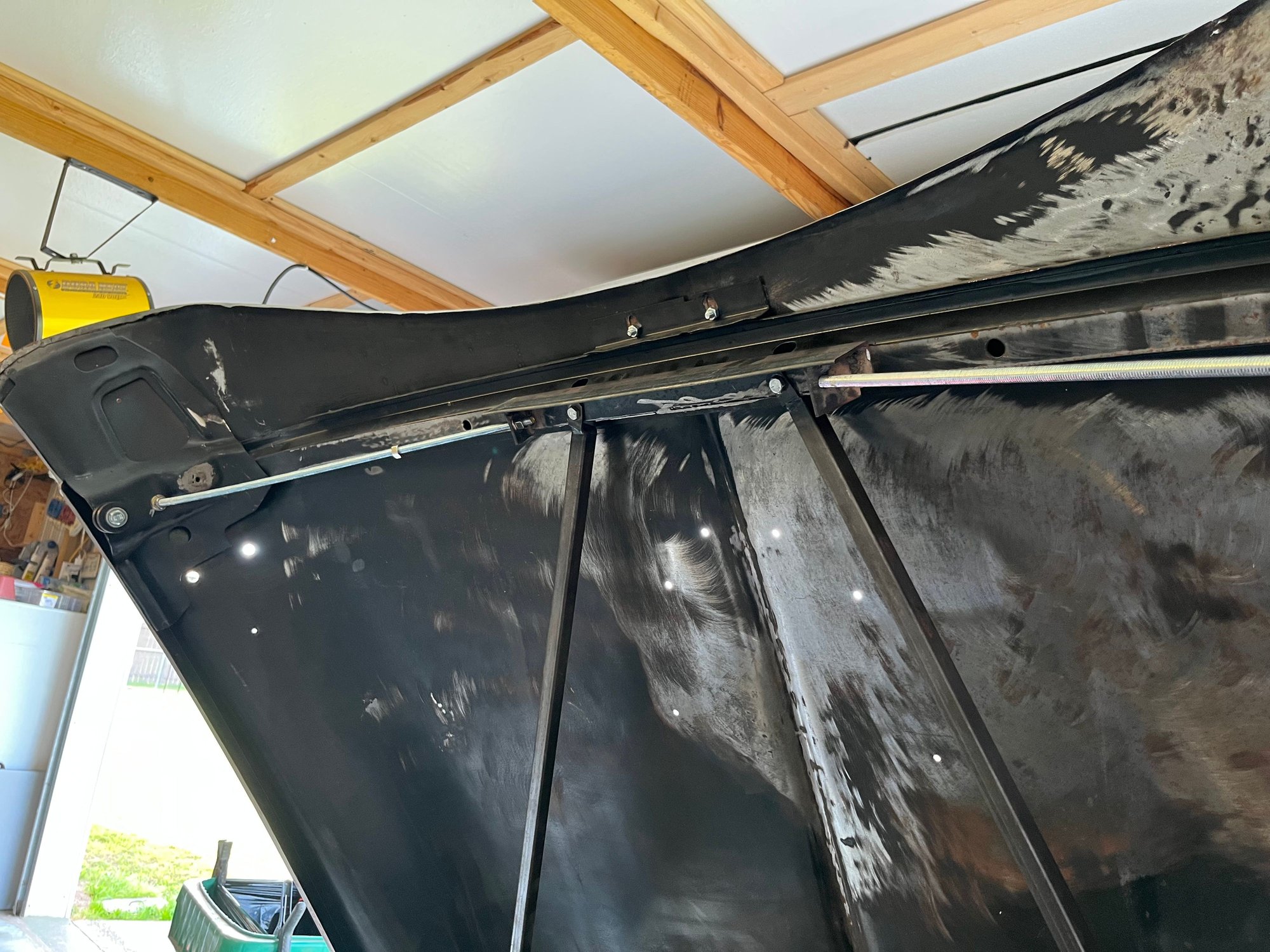

Cut the angle iron to the width of the rib, drilled the holes and welded tabs at angles for the treaded rods.
i was able to bend the rods into the holes after threading them into rivets.
Because the rods have nuts on the back of the tabs I was able to adjust each side of the hood independently.

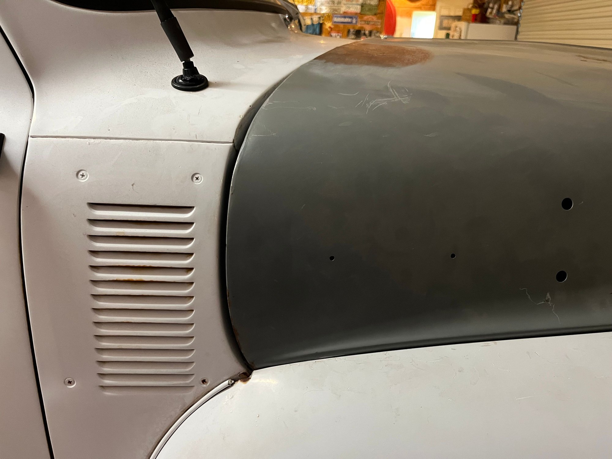

I may have to adjust the fenders a bit and notch the brace that is hitting the roller track on the passenger side.

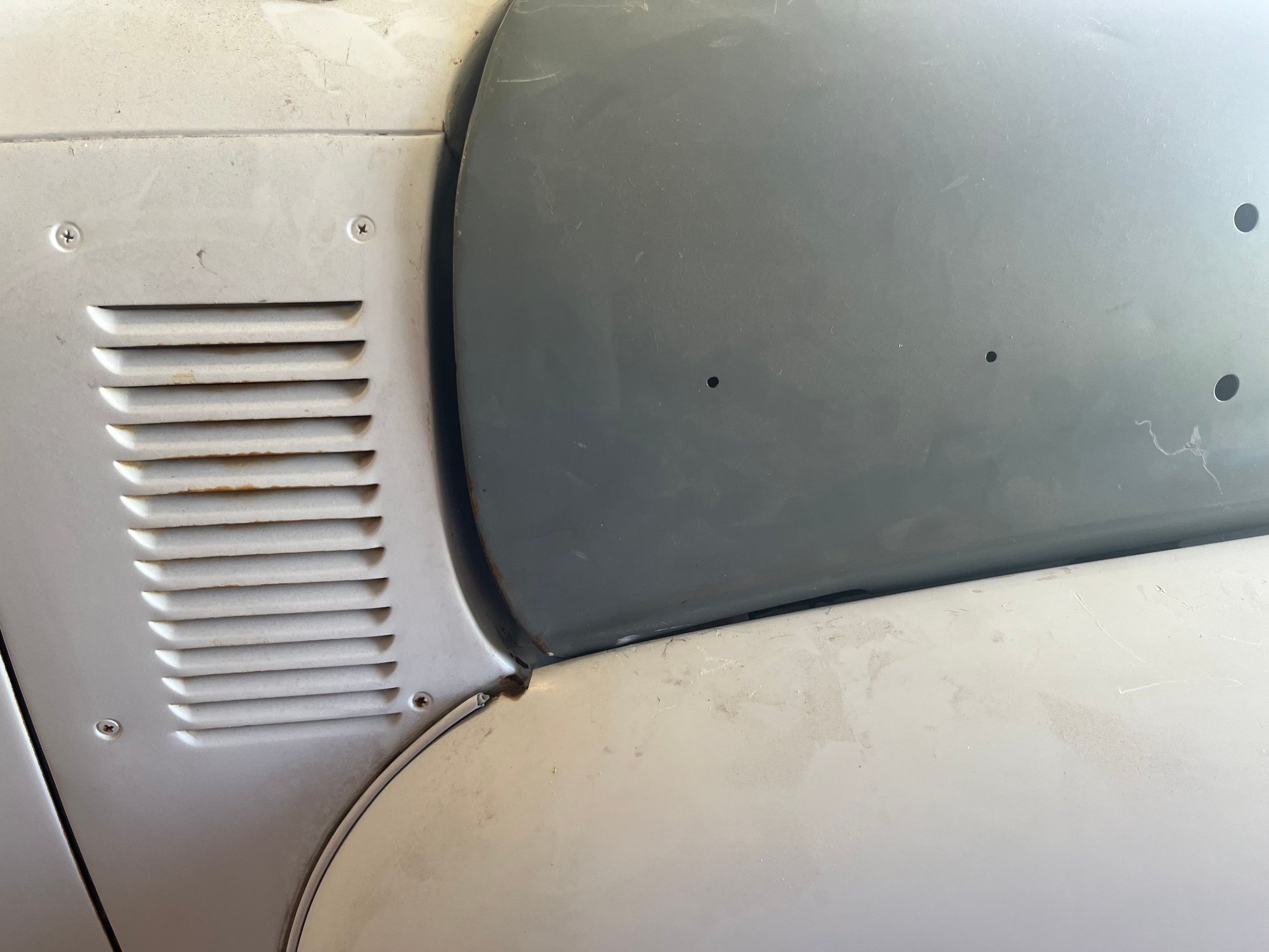

Over all I brought the hood independently 3/4” on the driver side and just over 1/4” on the drivers side. The fenders in the front have a gap one one side and almost hit in the other.

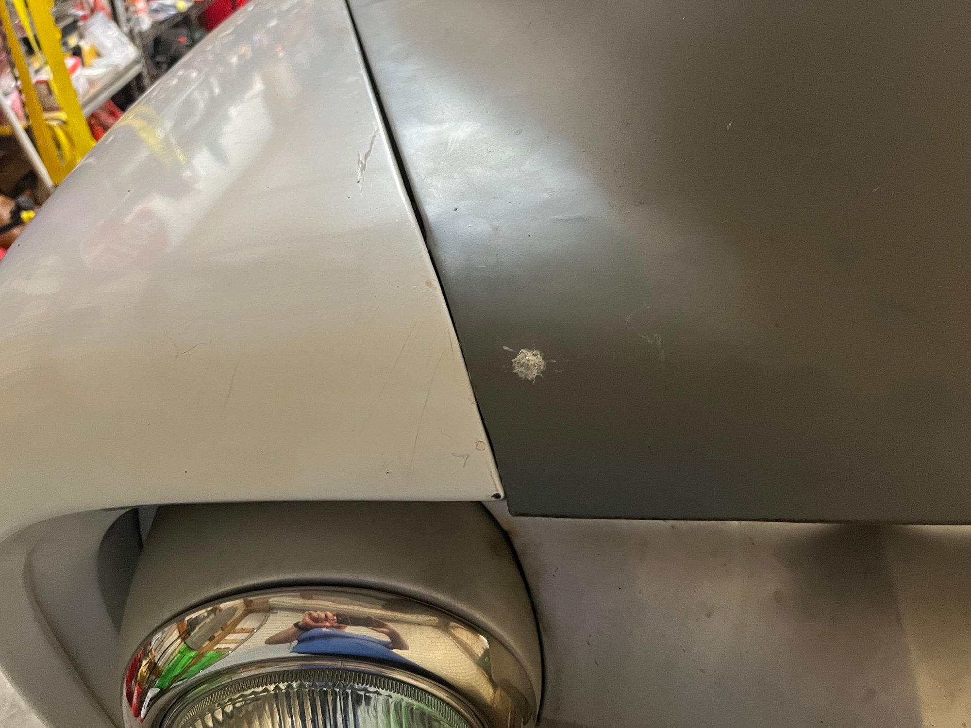

Passenger side before gap

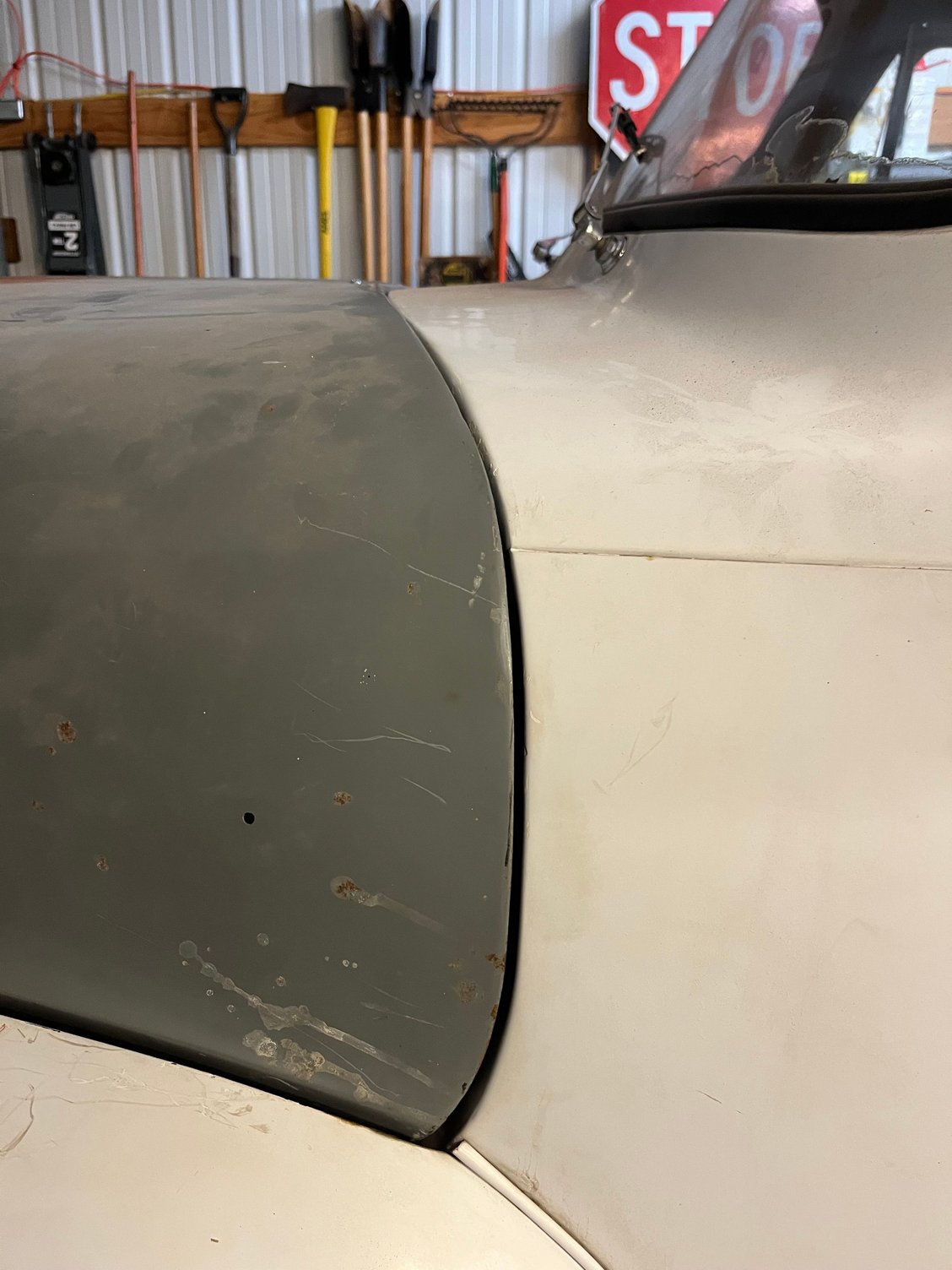

Hitting fender on driver side

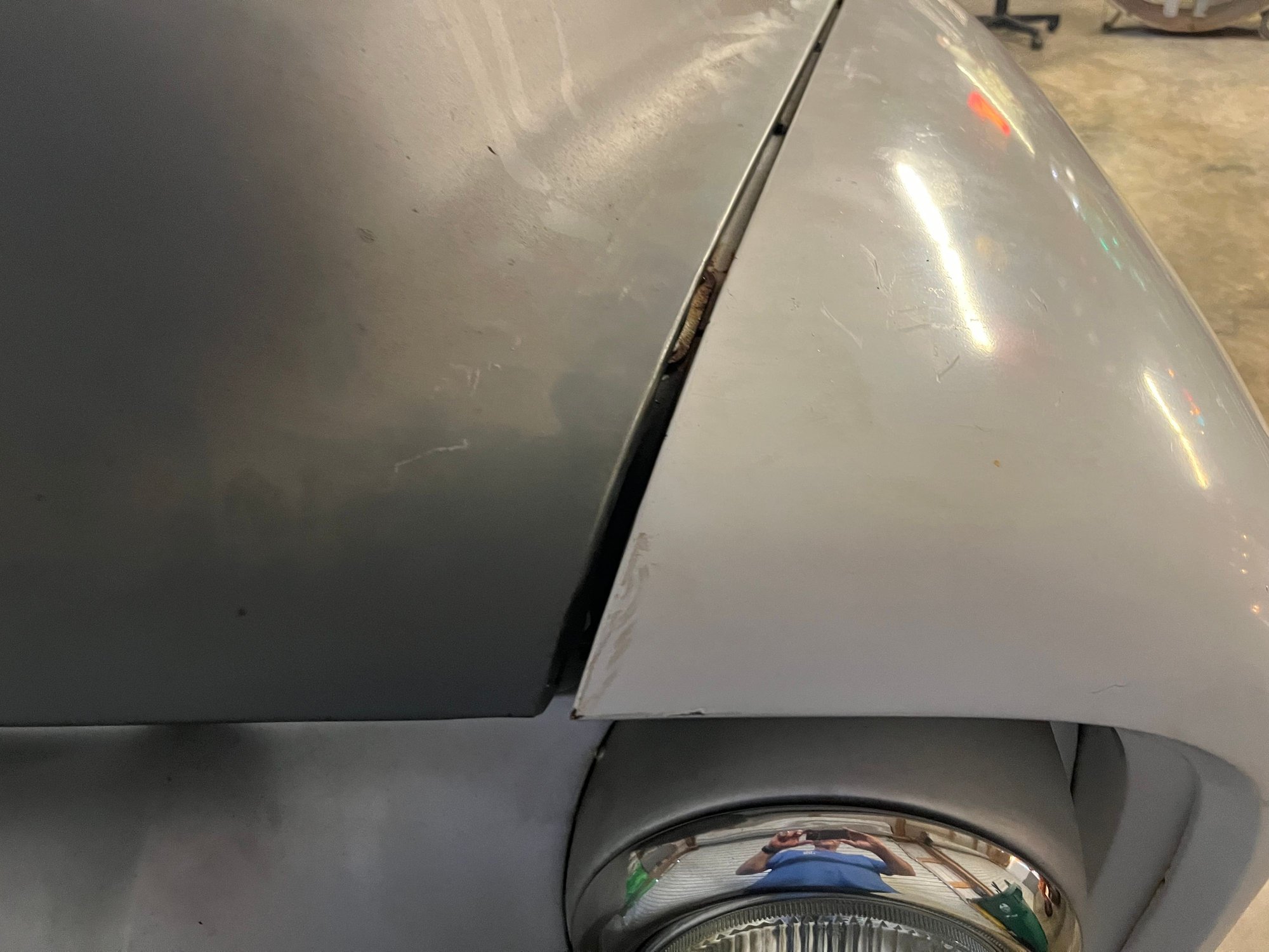

Roller will not stay in track

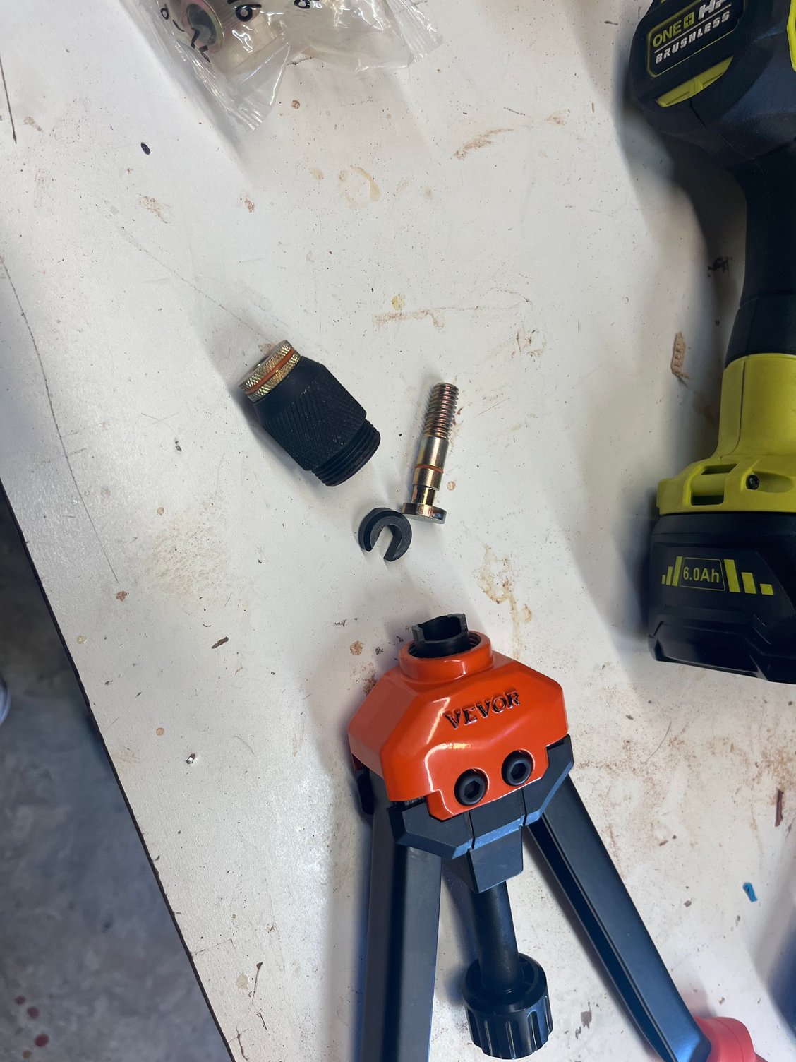

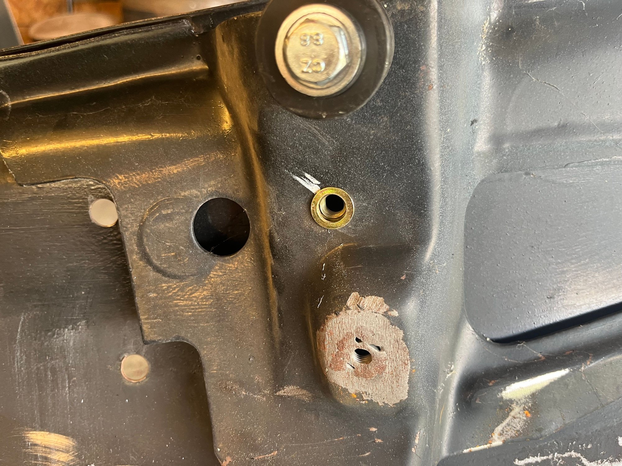

3/16 rivet
3/16 rivet
Tool casualty
Tool casualty
Angle iron on hood, fit flush after being trimmed to length

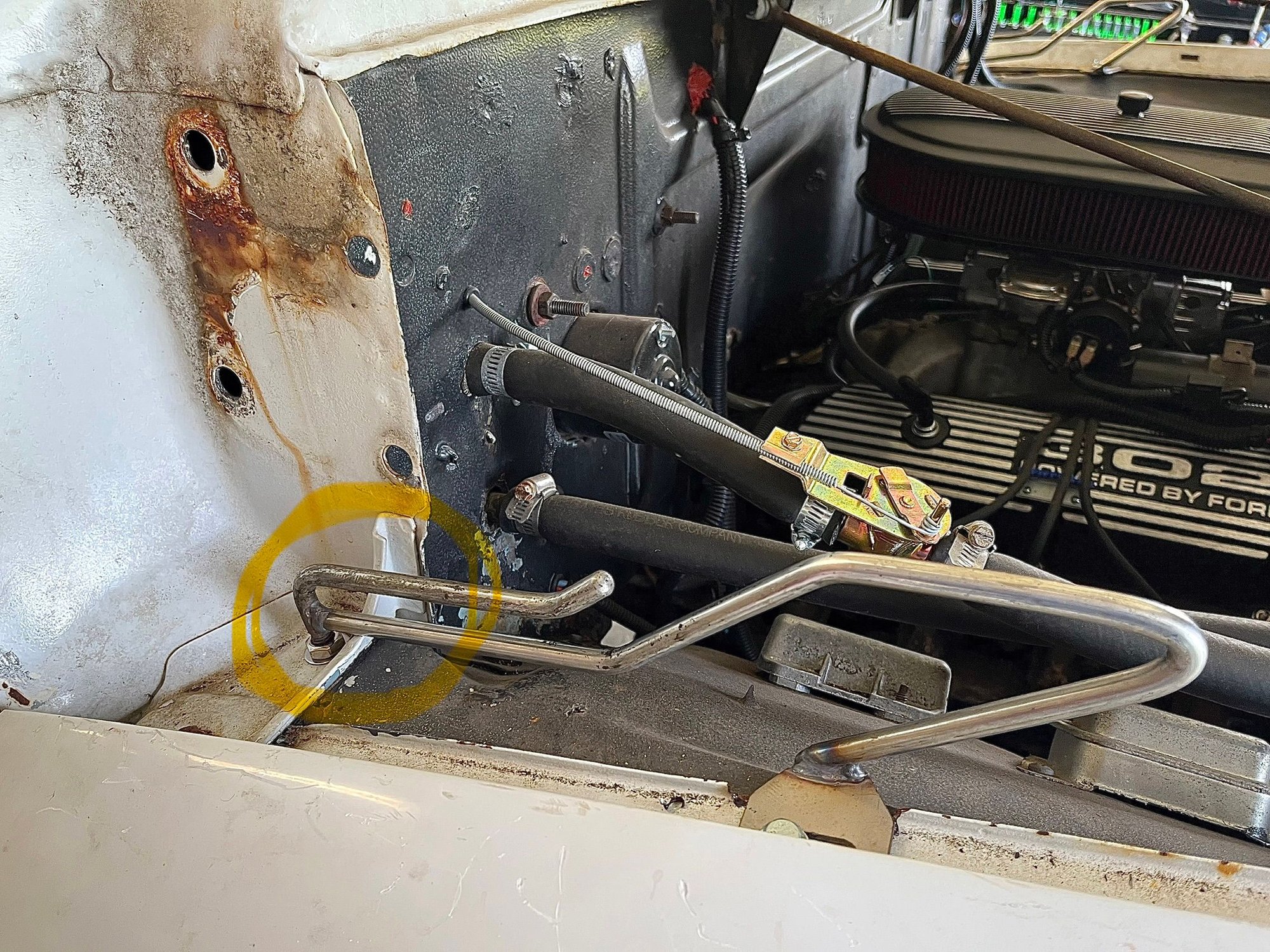

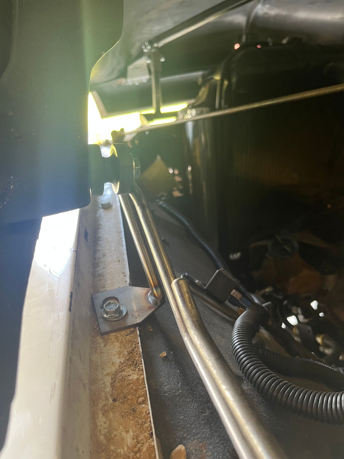

Attached bracket. The bolts on the inside allow to adjust each side of the hood.

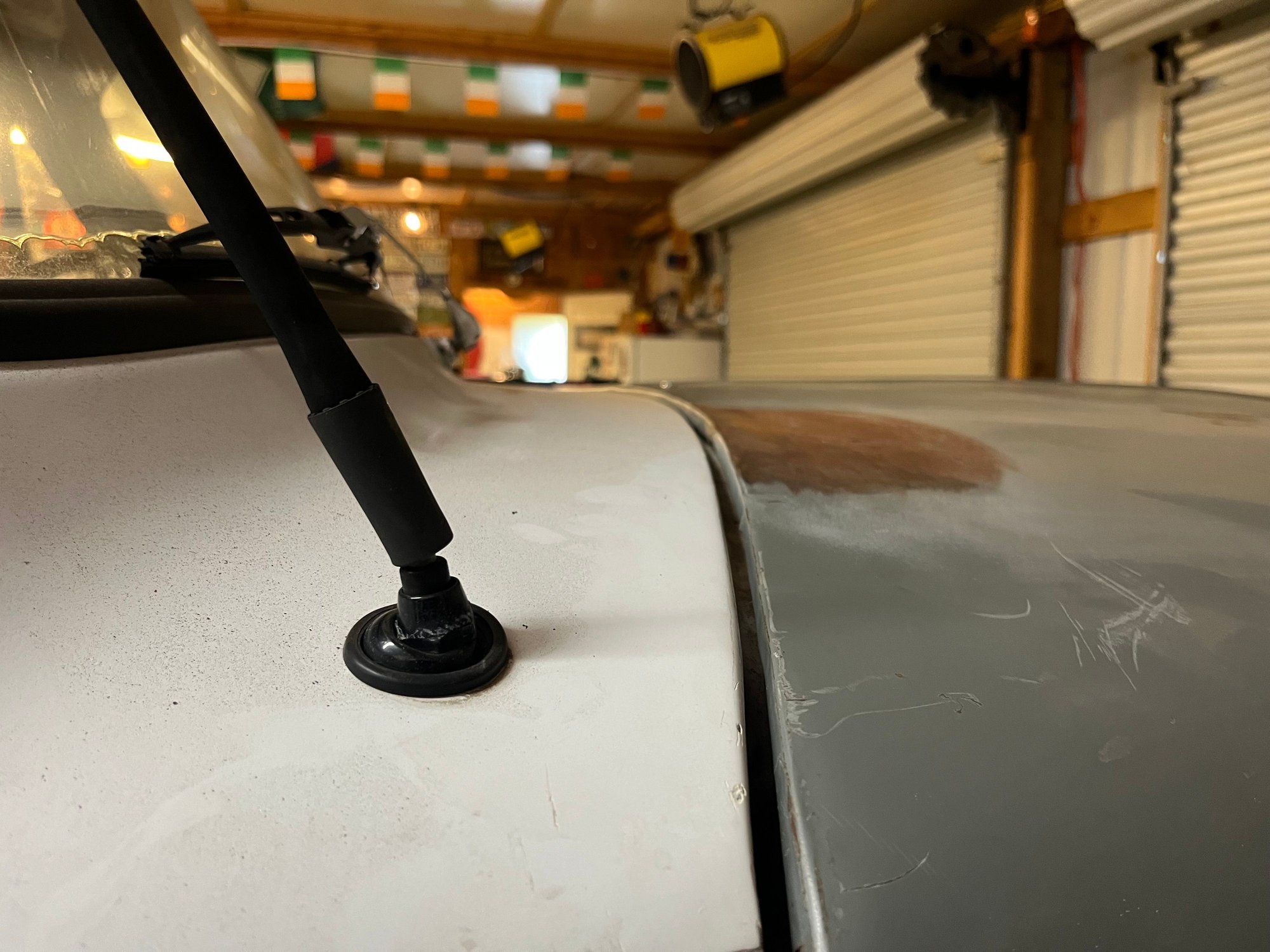

After hood a little high but not bad
