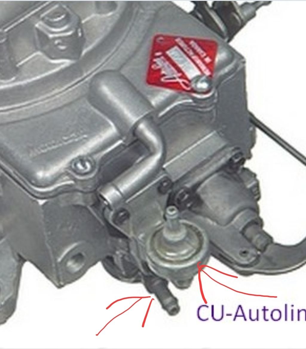

Hello Friends, Its been a while... Been Working on my Dads Truck, Installed a Carb Cheater and while its doing Good (19.417, 15.2, and 21.043 MPG Recently) looking at the Data Logs its Randomly going Rich to the Point even the Carb Cheater cannot trim it up, its especially bad at idle - 1200 rpm (with CC turned off it's trying to run at 10.5-11.2 AFR) and I feel there's something wrong but im unfamiliar with this Goofy Carb as im typically a Holley Guy but this is apparently my only option with this AOD

It generally idles 650-700 rpm in gear, with the Carb Cheater im able to watch the vacuum and AFR in real time and see how its responding, after 1200 rpm it leans back up appropriately, im thinking the issue is potentially related to these 2 ports, I don't have any information on what the purpose of these are as my older 2150s do not have them so I don't know if they need manifold, metered, or port vacuum like maybe I have them hooked up incorrectly

The top arrow goes to a added gizmo on your carb that lessens the accelerator shot when the engine is warm. Leave it disconnected, it does no harm.
If the lower arrow port is sucking air at idle or when you rev it, it needs a cap on it.
Thank You! We will cap those off and give it a try to see if it changes the issues we're having, Much Appreciated
UPDATE Your assessment was correct, lower port had failed and was filling vacuum line with gas , we capped the lines to both ports and the duty cycle on the Carb Cheater dropped from 80-100% at idle down to 0-22% and after idling around for 30 minutes with CC off and on never dropped below 12.5 (off) AFR and generally stayed in the 13-14 range, with CC on it kept between 13.8-14.5 THANK YOU Franklin
