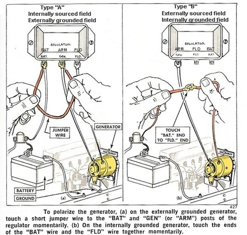

Here is some documentation on testing generators - Ford used Type "B":
https://www.delcoremyhistory.com/ima...rators%204.pdf
I would also not be afraid to contact the shop and ask their advice - if they are reputable, they should stand by their work.

I read it as they polarized the generator per type "B" instructions and then all was good:
Old Mar 24, 2026 | 02:36 PM
hooler1's Avatar
hooler1
Joined: Sep 2010
Posts: 1,834
Likes: 467
From: Mason City, Iowa
Thanks Brian!
My reading comprehension could be failing me.
Maybe the OP could clarify that his charging system is now working as it should.
