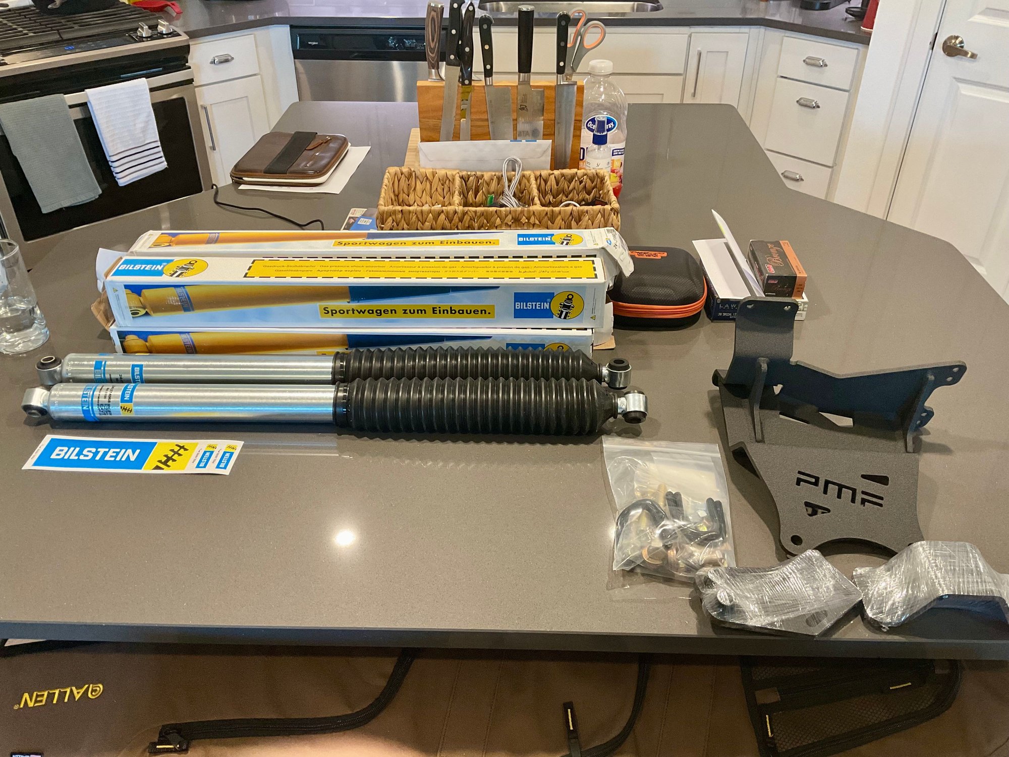

Bilstein’s & PMF Arrived Today
Bilstein 5100’s and PMF dual shock steering stabilizer showed up today for the F350, install on Tuesday……

...and ammo, too! Sweet!

Nice workshop 😂

Nice. The rears are pretty easy, the front's were a pain. IIRC, a ratcheting 18mm wrench would have been very helpful... I put 5100's on mine pretty early on and it made a nice difference. I put the 5100 steering stabilizer on the front too. Just curious though, why the dual stabilizer? I stuck with the single and I haven't had any issues.

Dual stabilizers, mean you can run more pressure in the shock, but it wont cause the steering to pull in one direction.
A shock rod that completely passes through, will have the same effect. Like a Fox ATS damper.

looks like the dual stabilizer center mounts are an improved version....they have stress reinforcements welded into them...a good thing.
