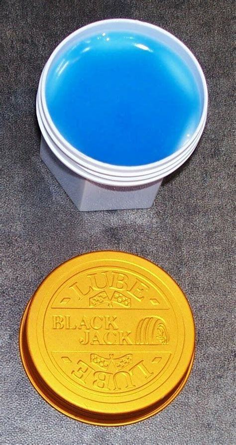

I use a Black Jack Tire Repair Kit for tire plug system. It has a lube that helps get the plug in these heavy duty tires.
I was thinking maybe those screw type might not work because the angle of entry of the damage. They would be a lot easier for straight in so it would not hurt to have both.
