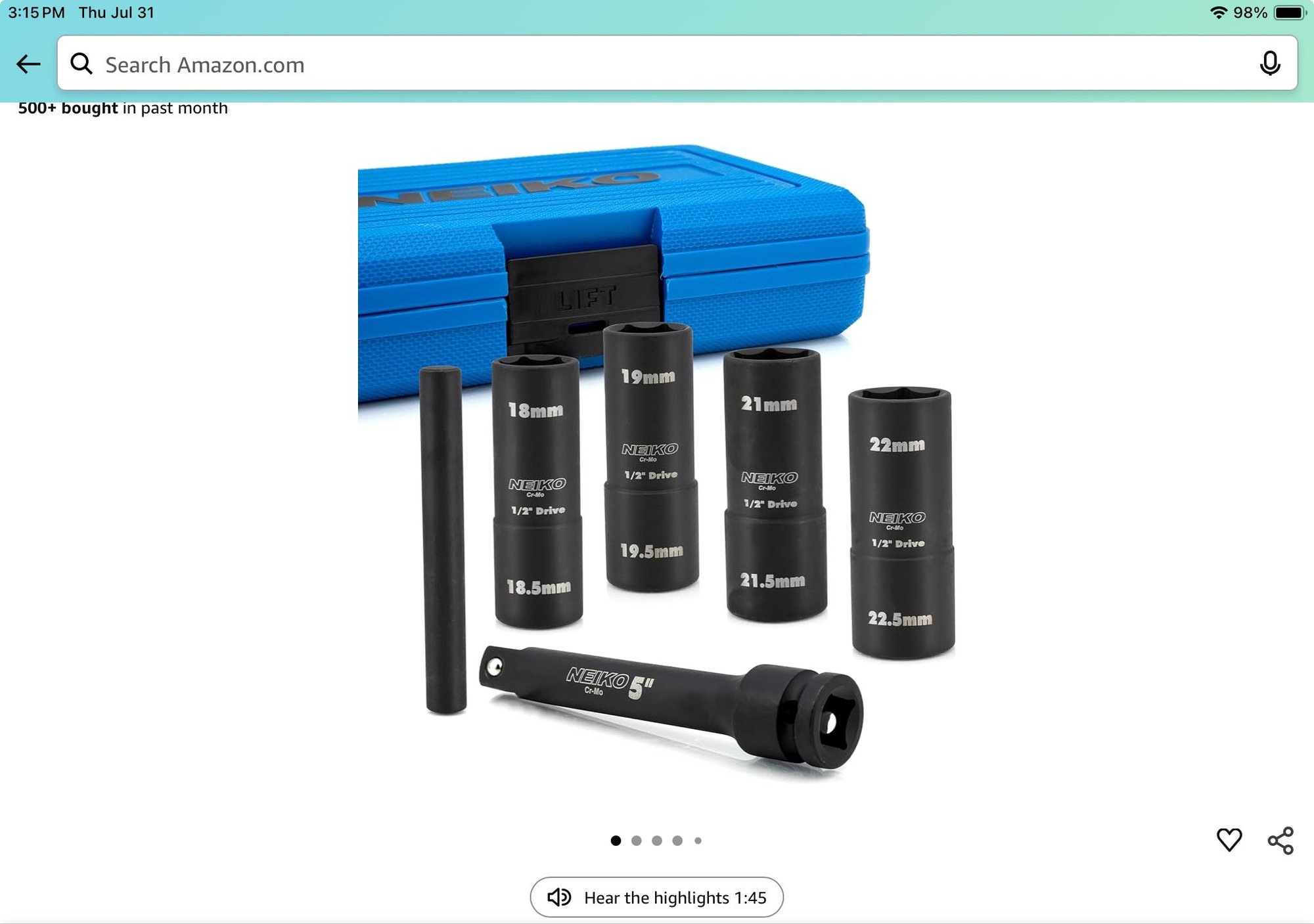

Yep, age-old enough that you can buy 20.5mm impact socket so that you have something that fits what's left after you have chiseled off the chrome cap!

Very common problem. They make a socket set specifically to solve the issue.
Bob

BINGO! Back in the 90's they didn't have one, but we requested one to Snap-On, looks like they finally made it.
