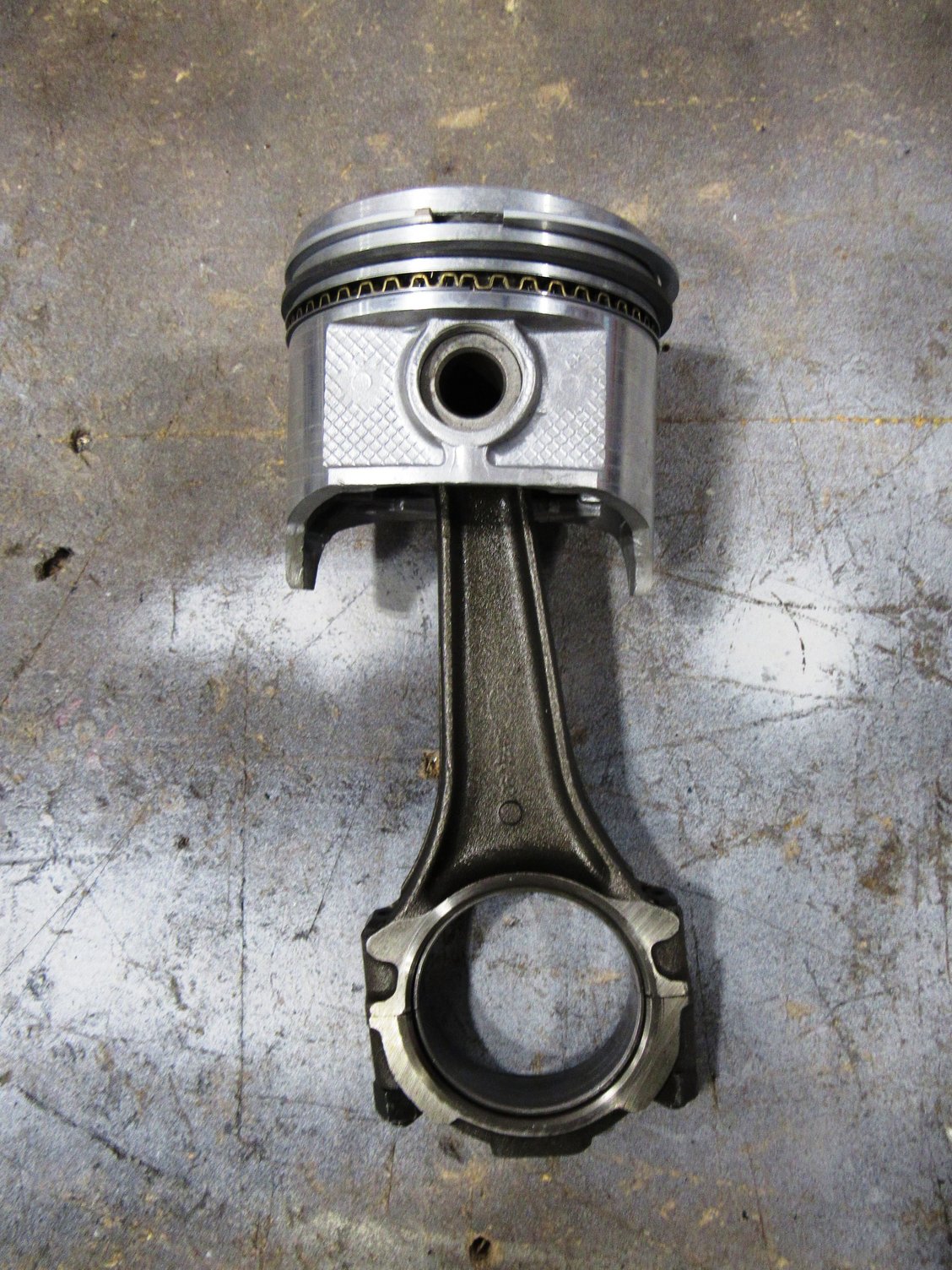

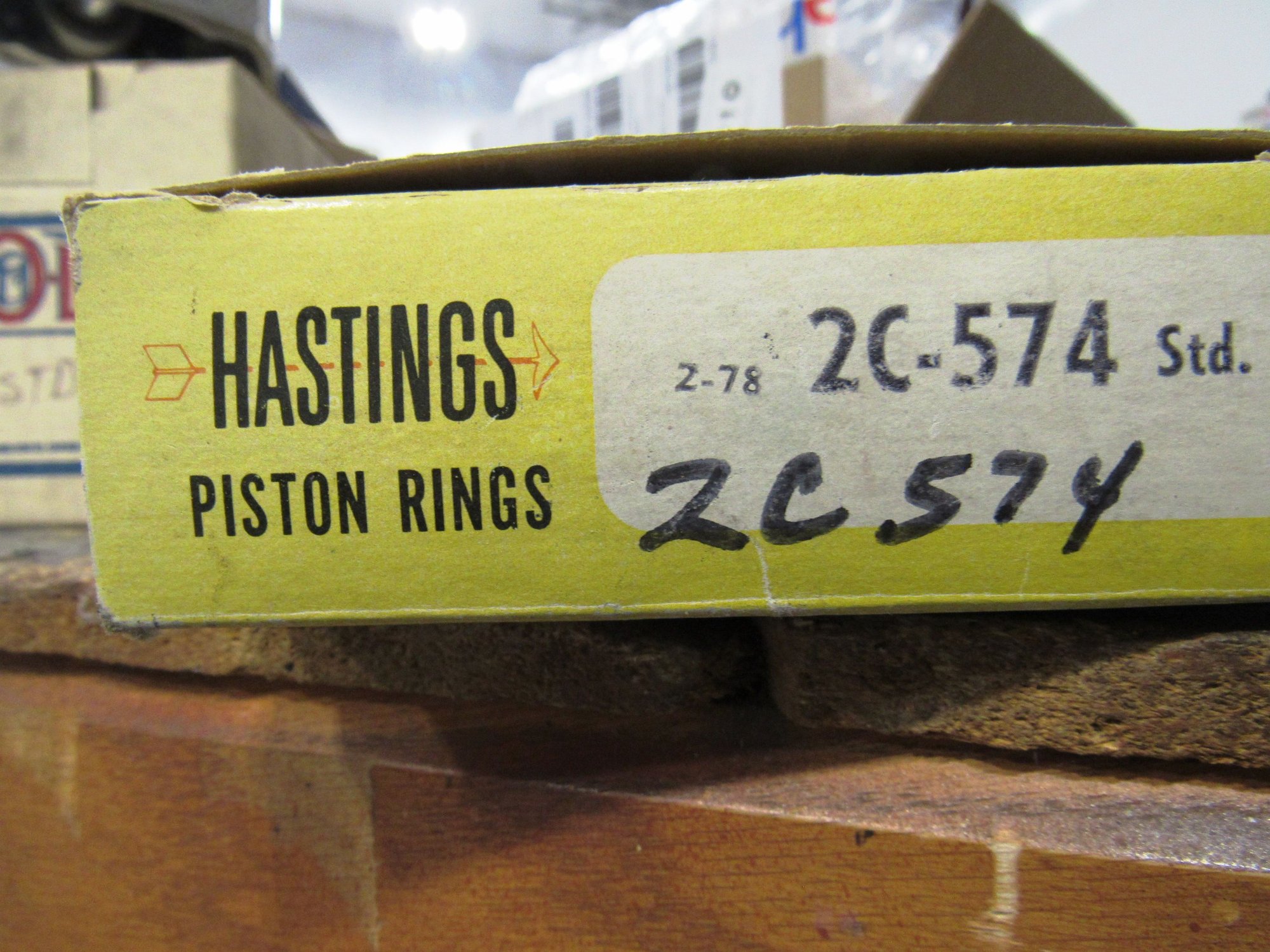

The engine I bought for my truck was rebuilt a long time ago and never started.
The person who rebuilt it bought it out of a 6 year old low mileage Mercury and had the pistons knurled to try and compensate for some cylinder wear.
I have been told the knurling the pistons was quite common back in the '70s and earlier and could make up for about 0.002" cylinder wear.
The pistons were the factory standard pistons.
I found a new standard piston on eBay.
I also found these rings on eBay too.
The production date, 1978. That was 2 years after my engine was rebuilt.
I bought cast rings because as far as i could tell that's what he used.
I lucked out and did not have to adjust the ring end gap.
If I had I would have done it exactly like 440 sixpack suggested.
It all went back together quite well and runs great.
