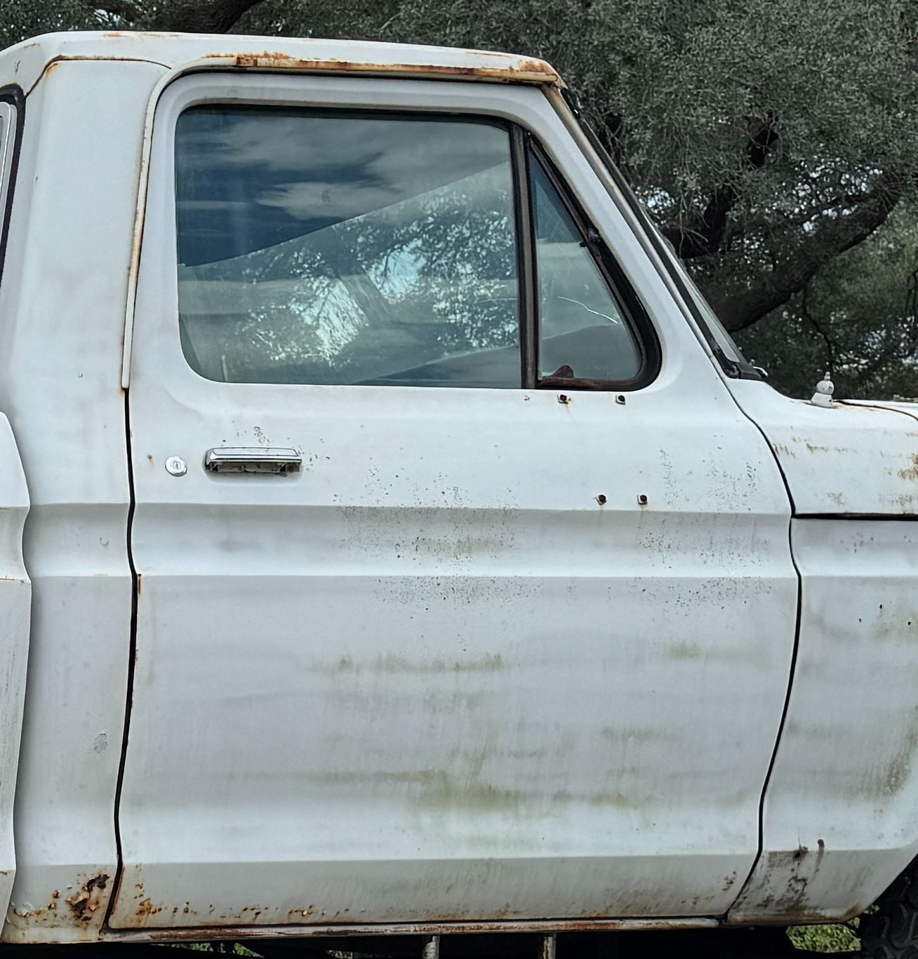

How do you know what mirrors ore the correct mirrors for the 1975 Highboy? The mounting screw locations on mine are certainly
different than the mirror screw locations for the 1975 F100 we have (yellow).

White one's holes look more right.

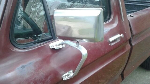

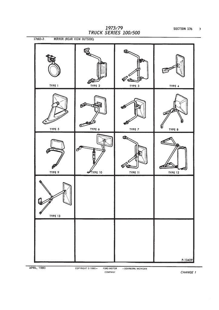

The white truck bolt holes look like it needs 73-79 type 9's. IMO the ones on the yellow truck are not for a 73-79. They look to be off a 80's or newer.
Genuine Ford Parts:D6TZ-17696-A .. TYPE 9 Low Mount Swing-Lock Mirror dealer installed kit / Obsolete

6x9 bigger head.
Not flat back like the 6x9, so these are the 5 1/4 x 8 1/4. Not matter what, the top bar should be parallel to the ground and the bottom mount above the "dent" line.

The mirror on the tan - yellow door is off of a later truck, like 87 & up.
