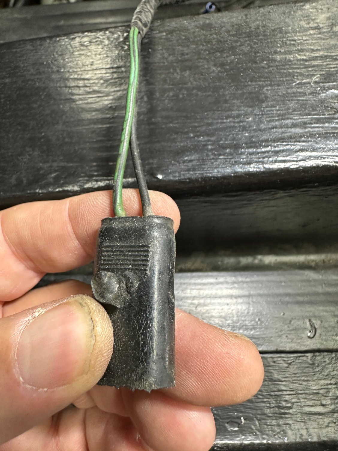

Here another quiz Wiring ?
I have this hang off the driver side inner fender it’s a plug BUT I don’t know where or what it’s for.

Do you have the windshield wiper pump/tank assembly in?
Nope. That maybe exactly what it is.

Not sure on this but the chart shows the green wire with the black tracer to be for the head lamp dimmer switch to the high beams.

He said this in under the hood, inner finder location. NOT under the dash.

Figured it out it is the windshield washer pump wiring. Had the wifey it in the truck and turned the ignition on and told her to push the windshield wiper **** and I had a test light and BINGO it lite up everytime she pushed the button. Now I just need to get all the stuff to make it work. My truck doesn’t even have the squirters or the water bag.

My 68 has a washer tank with the pump mounted in it. 3 screws hold it to the inner finder.
