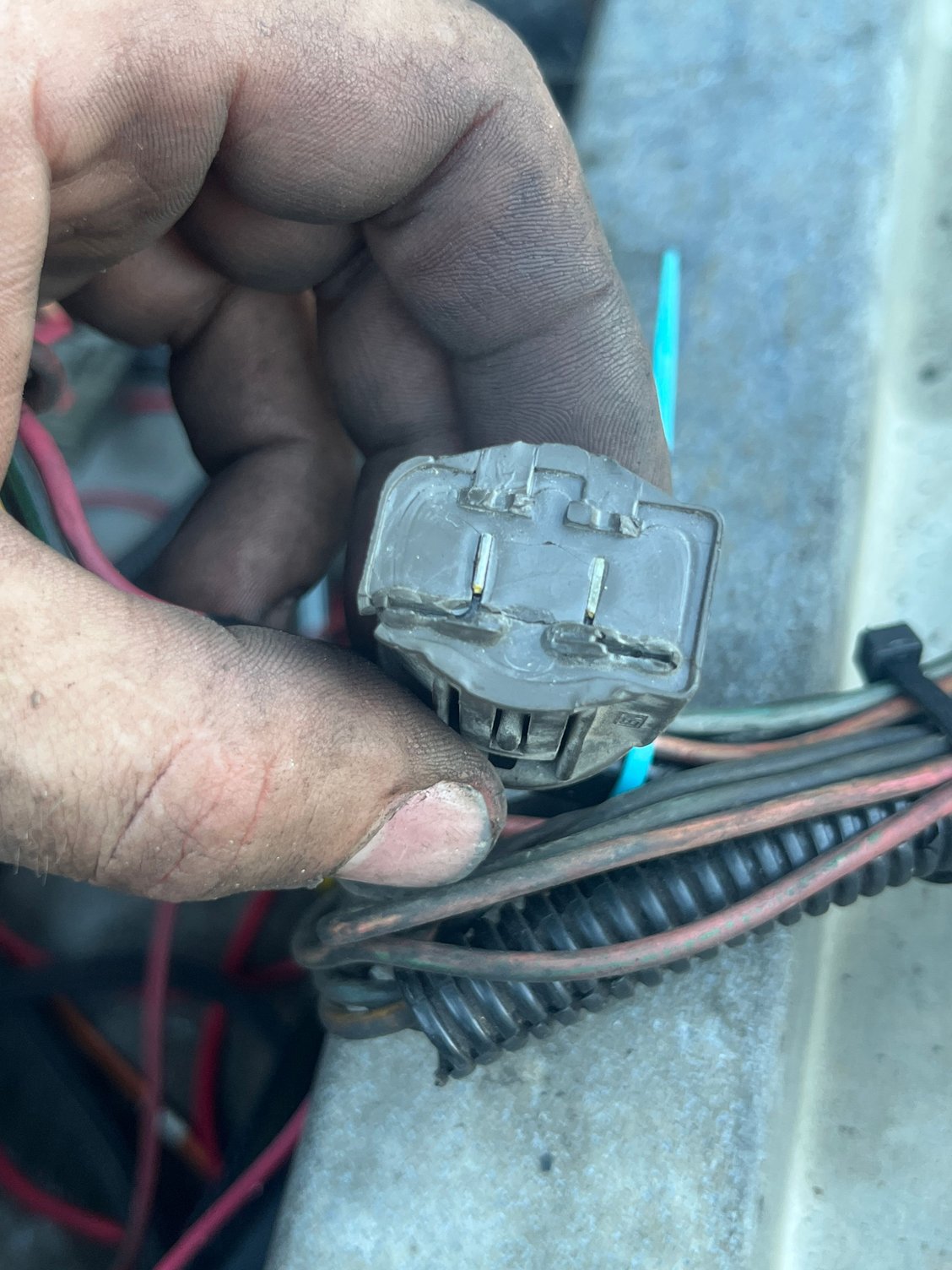

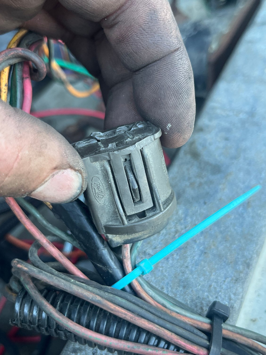

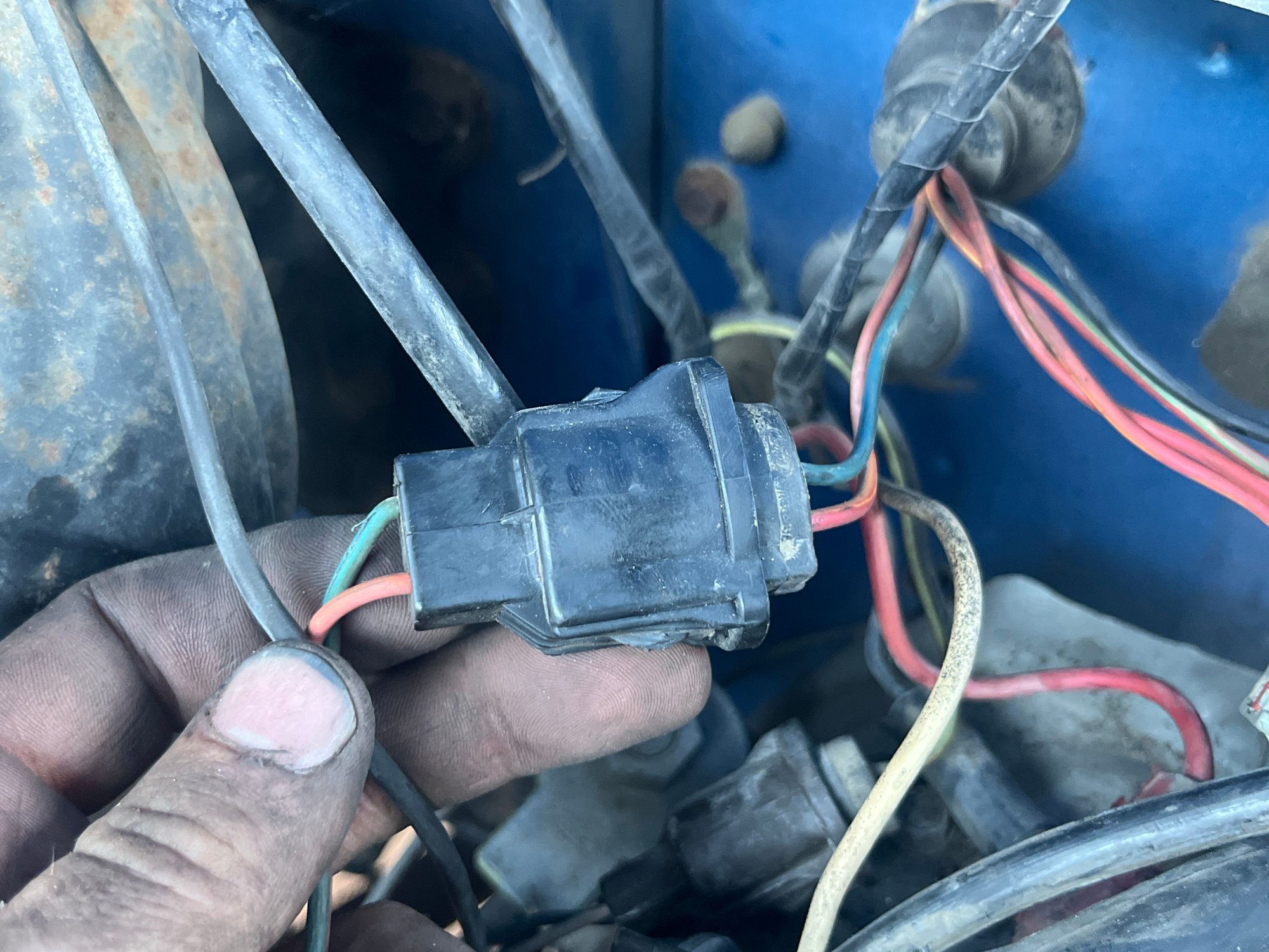

Can anyone tell me what this harness is for and why it is plugged/capped off? Last picture is where it traces back to at the firewall.

Hard to say with only the close up of the plug .
You might be able to figure it out through the color code in the wiring diagram.

I looked at a 78 wiring diagram. It looks like egr vacuum solenoid.
https://www.fordification.net/tech/i...ster_4of10.png
Connector C-330 and or c-331 appears to have same shape and wire colors. You can see what the connectors look like on the bottom and sides of the diagram. It is in the wiring diagram upper right.
