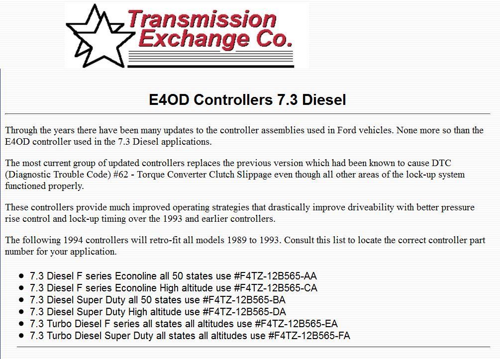

If you leave that fuse out, you should have 2nd gear in both the manual 1/2 positions and then once the truck is up to speed, let it rev a bit extra cus there will be no 3rd, it will shift to OD when you shift to D position, where you could have driven it home.... If there's no mechanical issue with the trans, which it doesn't sound like. I'd inform you about the '94 IDI trans control units in case you end up needing one, but you've already got a '94. Just be sure if you need one to replace it with another '94 unit.
Well this wont hurt to post here so you'll have the part numbers.
