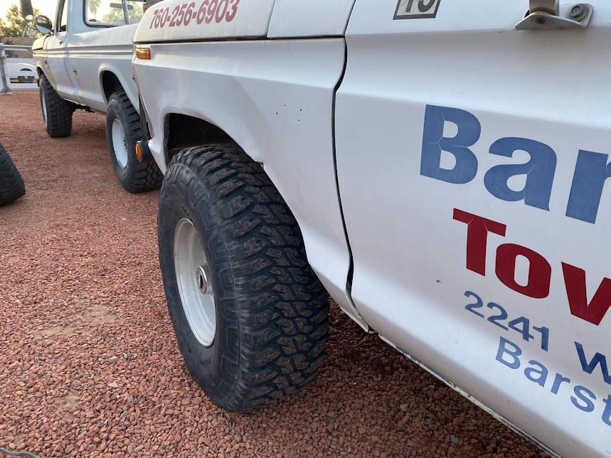

My wrecker is going to be a offroad wrecker so you think the MT/R is going to be my best "performance" tire out of the bunch?
I dont care which versions I get or how noisy they are for the wrecker as I dont plan to put a ton of miles on the road since it gets 3 mpg.
Im going to throw an IDI into the wrecker may not make a ton of power however it should be more effcient than the worn out 460 its got.
Another plus with the IDI in my opinion is its injected so no floats so offroading it wont care or least thats what I understand.

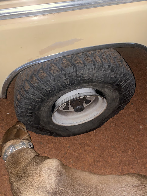

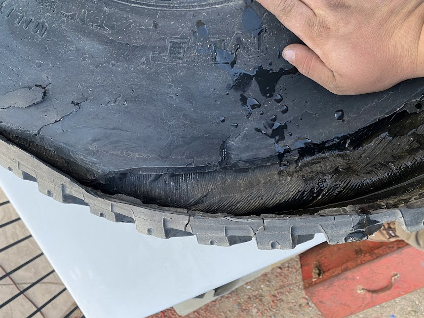

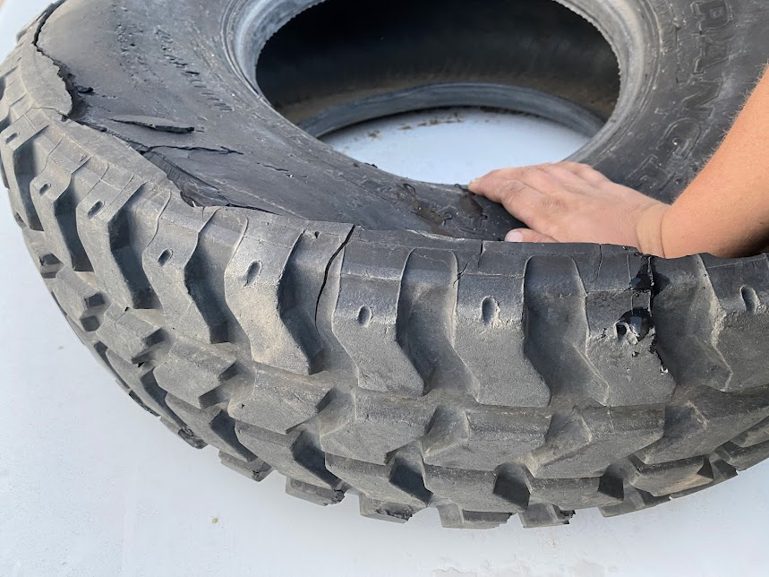

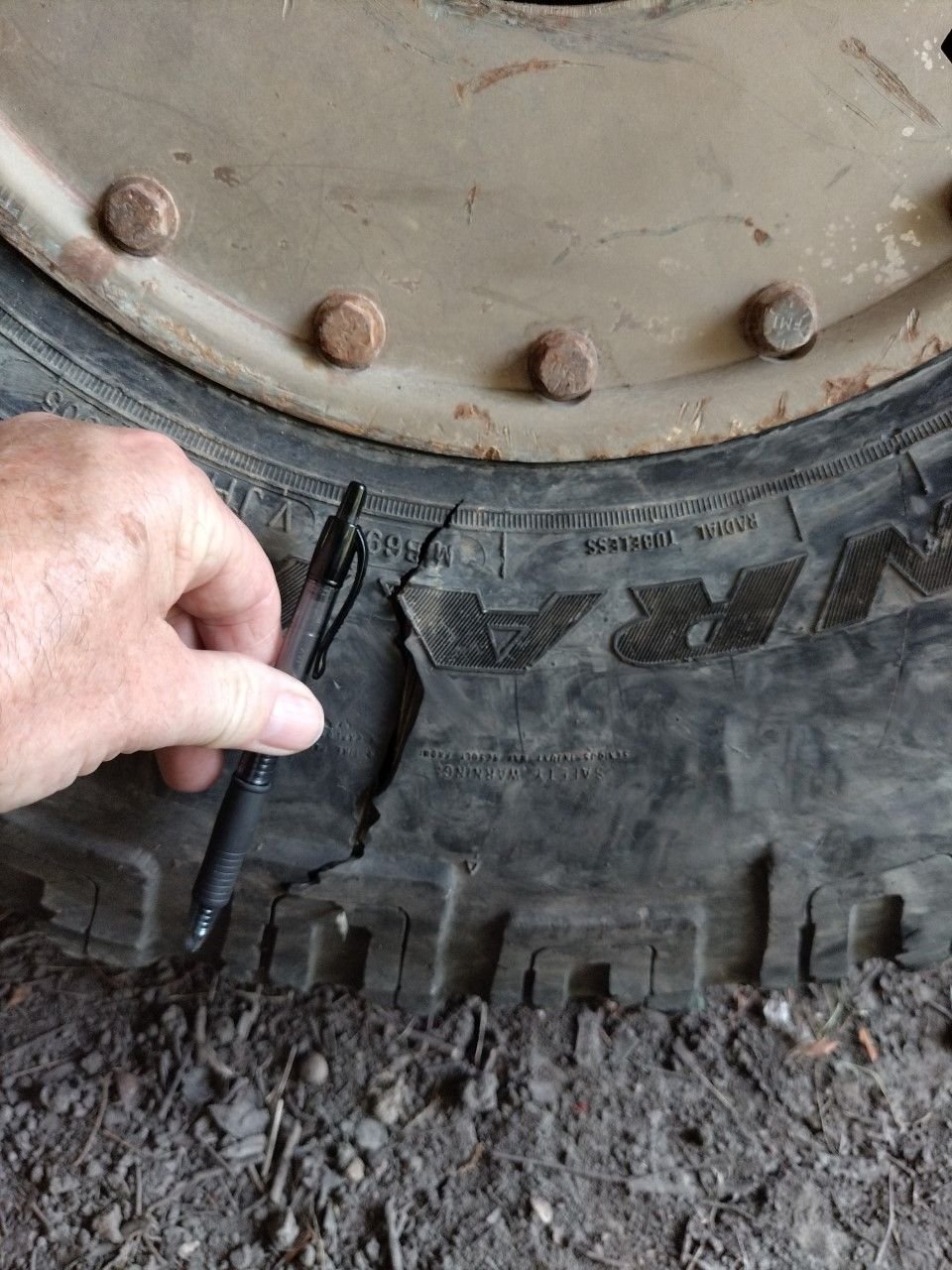

My wrecker was able to kill 1 of them M/T's while ive owned it.. It was a few years old when it died though.
I cant remember if this is the MT/R that split on me or not but it was a split very much similar to this that caused one of the MT/R's of mine togo flat.
I remounted it on one of the 24 double bolt humvee wheels to see how much they squatted with no air pressure and ive got 2 that I did that on and
dont remember which one was the bad tire.

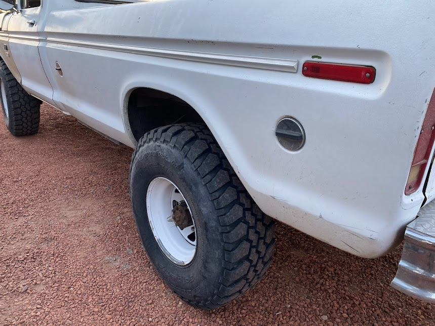

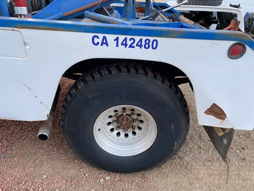

Ive currently got the mis match setup on the wrecker due to that 1 MT dying. The spare on the wrecker is a MT but its pre 00's date code so im not going to run it on the truck.
Ive liked the BFG's so far but theyre also 10 years newer than the newest Goodyear I have.

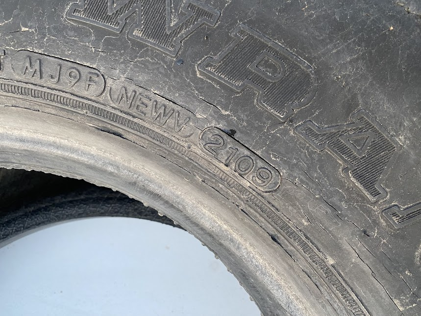

Likes: 5,826
I just got a smoking trade deal on four like new Treadwright LT | MT GUARD DOG - 37x12.5R16.5 8 PLY REMOLD USA... with five 16.5 chrome spoke rims. Those are going on the red truck next. https://www.treadwright.com/collecti...37-12-5-r16-5#

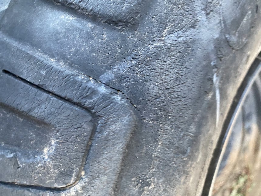

I feel your pain on a good tire gone bad. I had a bad trail cut on a ol Sketchy one time, I could put 4 fingers up to my palm in it. My tire repair/vulcanizing guy did a heck of a job repairing it though. Even after vulcanizing it, it still got a inner rubber boot, and a dump truck inner tube. But it holds air (I normally run 8 to 10 psi anyway) and I wheel it as is. Off road use only, of course I do not take it on pavement, I am not crazy.
1605....old tires for sure.

Thats a pretty nasty slash thats for sure. Thats interesting never seen a repair like that is that melted rubber burned into that or what is that.
Yeah your tires a few years older than some of the ones I have but if your running tubes in them the tire age doesnt matter as much since I run tubeless its more of an issue.

Just Google vulcanizing, it is cool machine that get hot enough to melt rubber and it has a duel clamp spoon like set up to do both sides of the repair, at the same time. Also works on large tractor tires, dump trucks, large construction vehicle tires. The guy said my tire might be TOO SMALL to get the tool in there. Lol

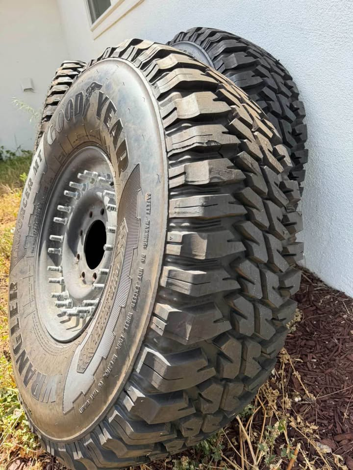

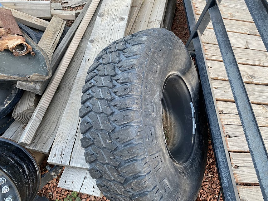

Came across this slightly different MT/R humvee tire on facebook today.
Never seen this version before to bad theyre down in san diego otherwise id go pick them up since theyre 500$ for the set of 4 and look to be pretty new.

MAKE THAT DRIVE!!! $500 for those tires PLUS rims is a steal. Those are Goodyear Wrangler Enforcer's. $800 + a piece.

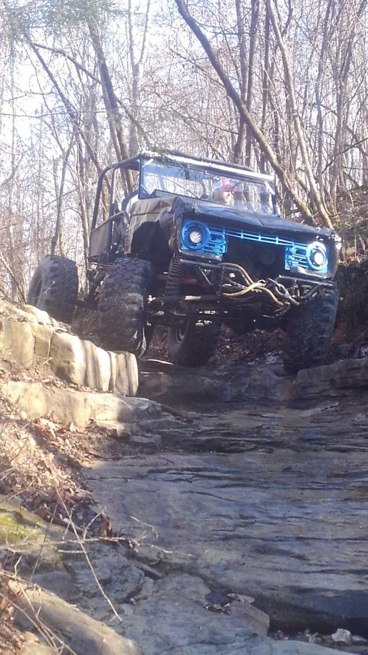

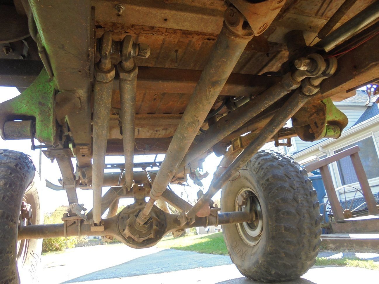

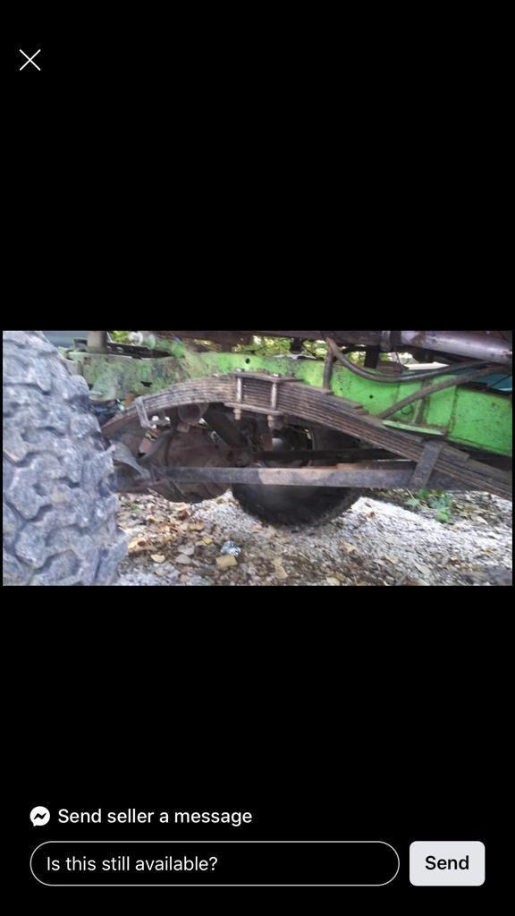

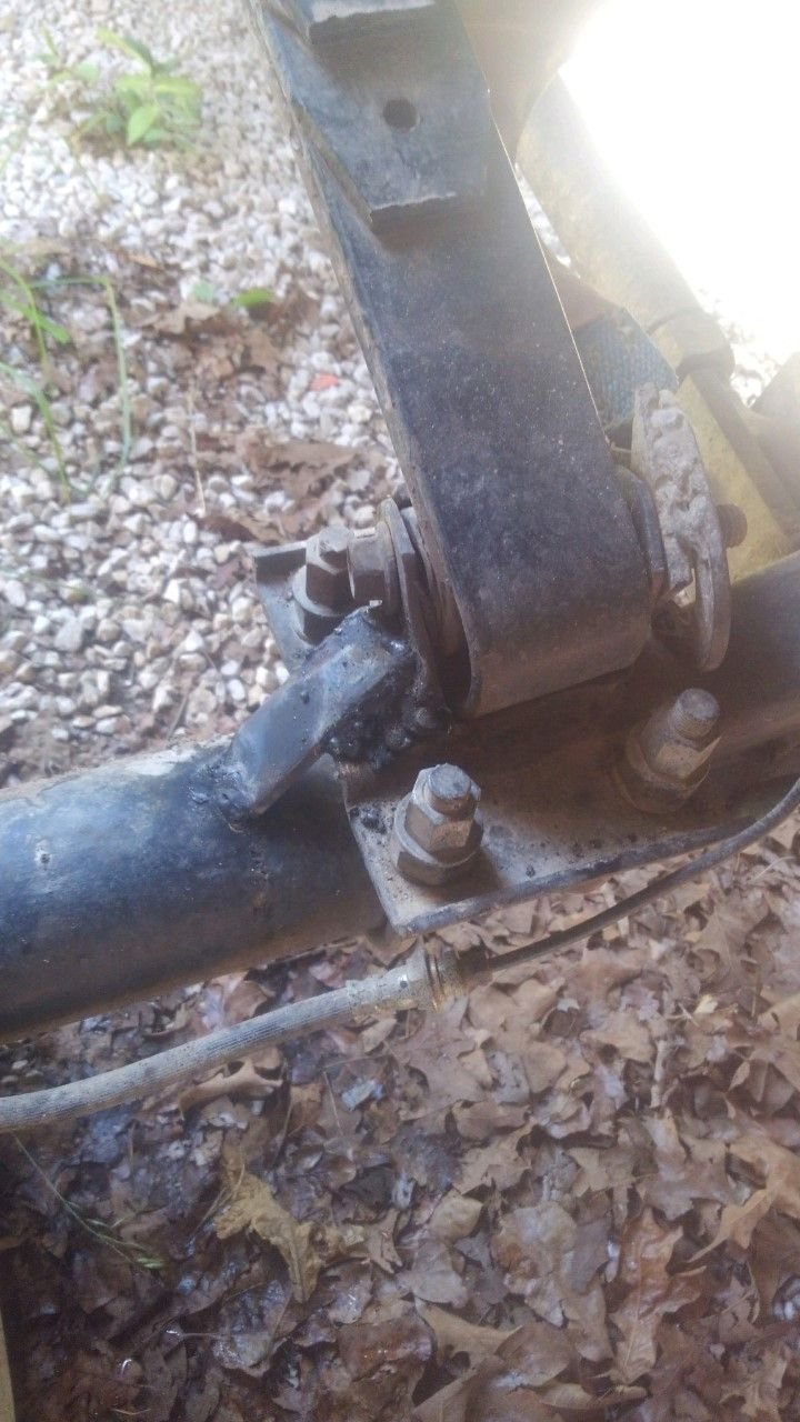

Man I aint seen 1/4 elipticals in a MINUTE (or whatever that variant of it is called)

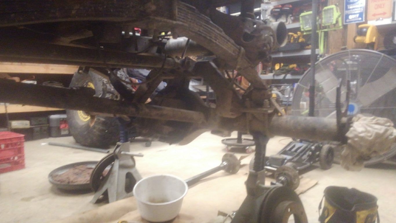

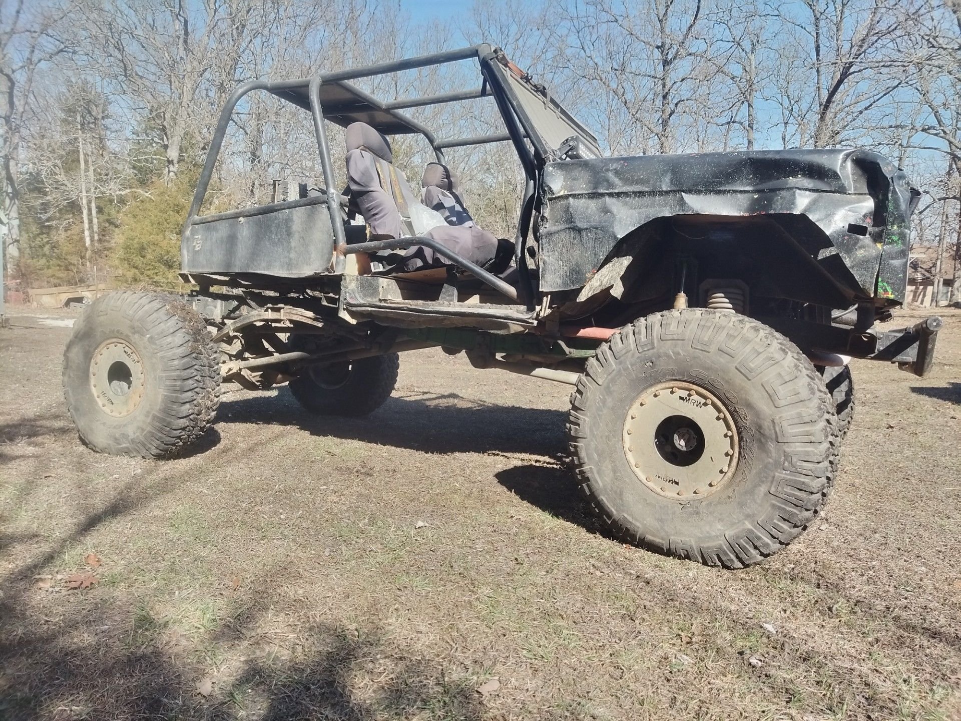

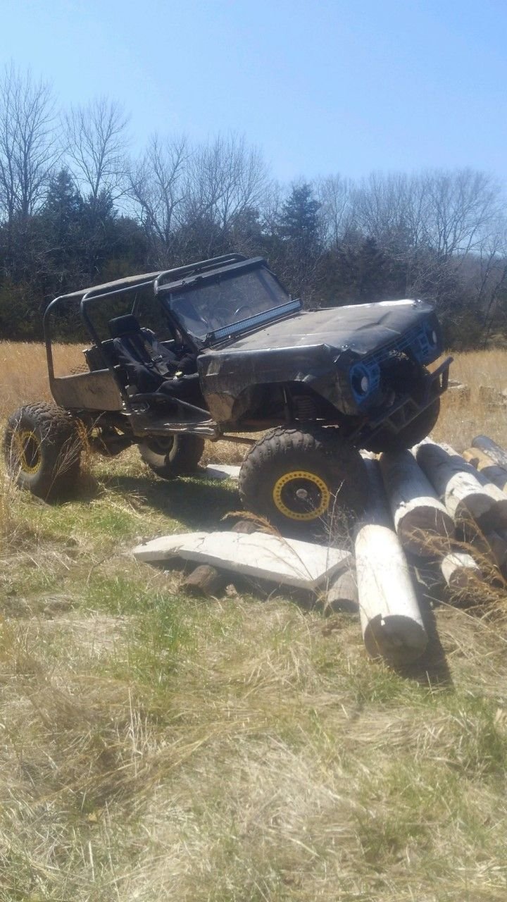

Yes why do you think we call it "Sketchy"...I know I know I can not believe I am showing you my undercarriage. SIL went to Oklahoma and bought it WITH OUT ME WITH HIM....and this is what he got stuck with.

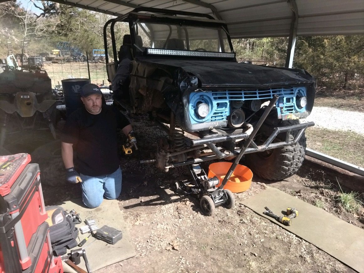

Here I am pulling the 3rd member. ALONE.

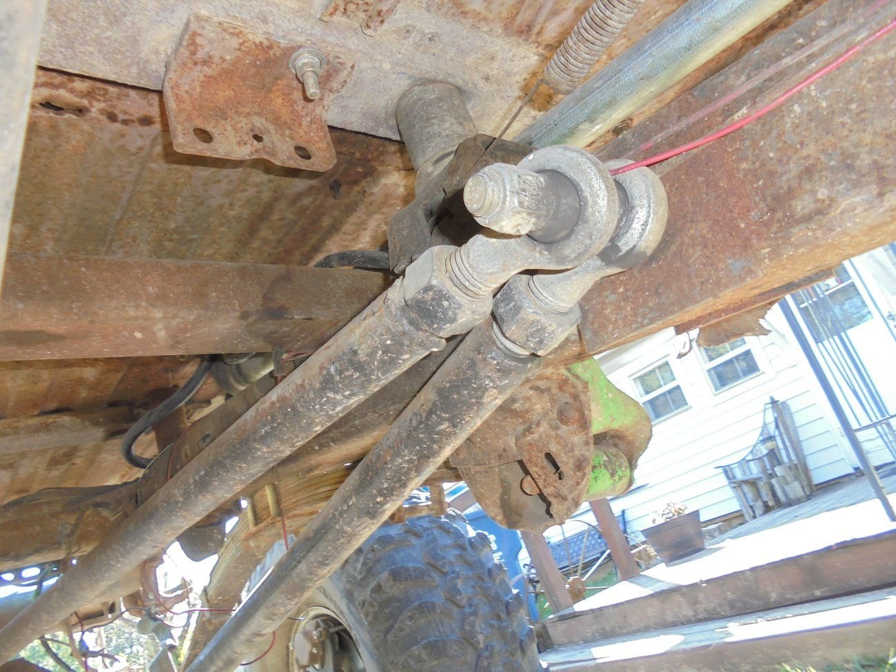

I know 2 links on ONE anchor point. Way wrong anchor set up on the axle. Its like what ever they could find in a scrap bucket and get it to stick.
Houston we have a problem.
NOT suppose to be that way.

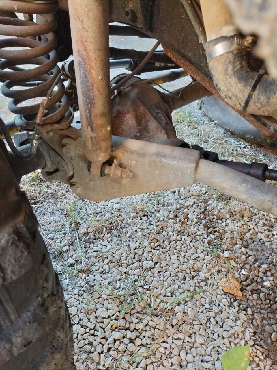

Do not even get me started on the front axle...76 F250 low pinion with a 5 lug outer swap. But they had to leave the drs side leaf spring pad (that was cast into the pumpkin). So lets just off set the axle that complete amount to the passenger side. But attach it to some high dollar raidus arms. Some peoples kids...I swear.

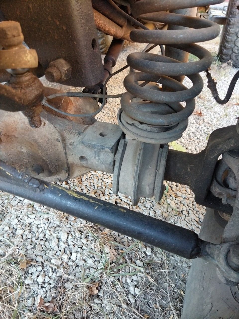

Holy sht, single shear link mounts too! and that front axle

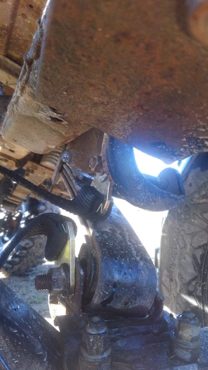

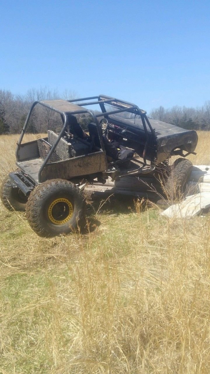

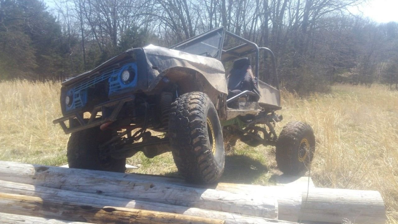

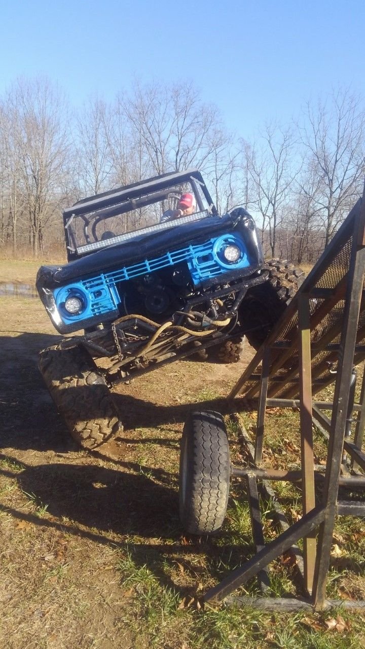

FTE post # 50,001. I know SUPER sketchy, and here is the crazy front axle set up, with some Duffs long travle extended radius T-Rex arms.

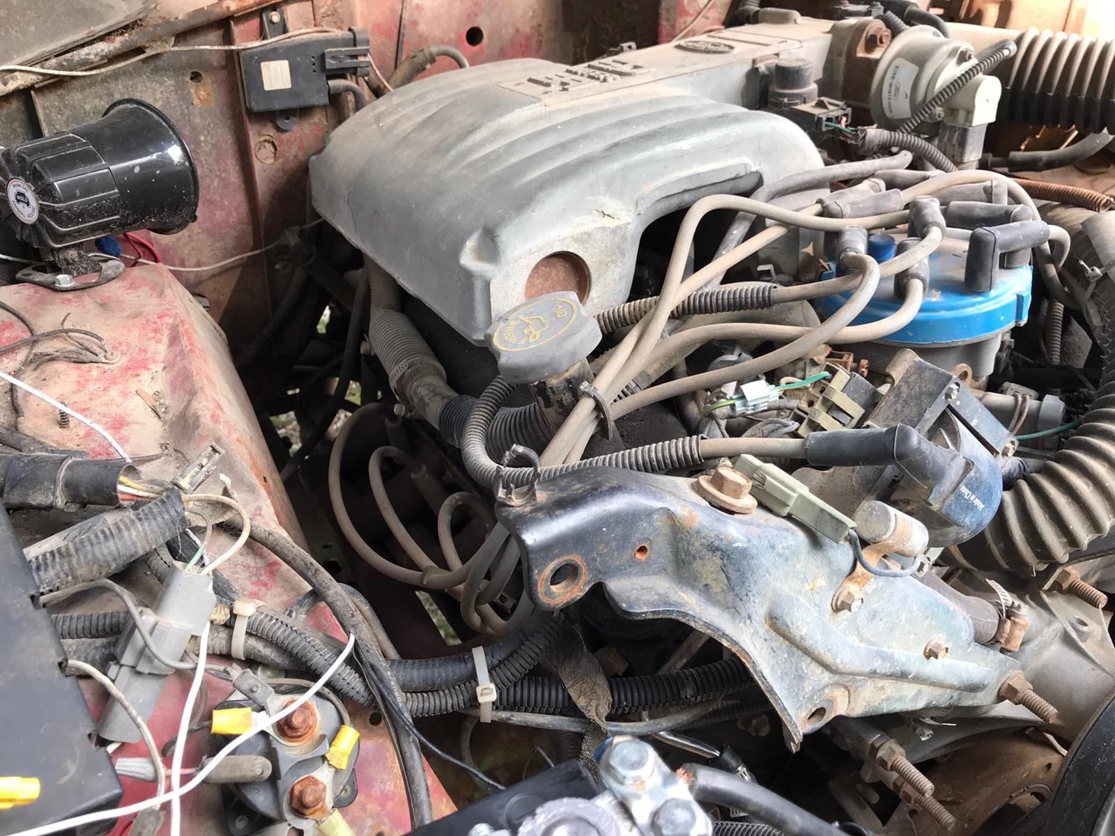

A tossed in EFI 5.0
Ziptie to the rescue. How about that PS pump reservoir.
Milk shake anyone?
I know I know, I have plans to upgrade/fix all the sketchyness, I just need some time off work and some parts....yes that jam nut is LOOSE as a goose.
DO NOT LET THE SON IN LAW GO ROCK CRAWLER SHOPPING IN OKLAHOMA..... BY HIMSELF.

Yeah ive thought about doing the drive. Its 354 miles from my place to encanto (city in san diego) and back and at 13mpg would be around 27-30 gallons at average of 5.50 a gallon for 87 would be around 150-165$ in gas alone.
Im kinda tapped out on money right now as well since I have a Jamboree I want togo to at the end of May and I dont exactly have an income at the moment. Im a backyard mechanic with no projects at the moment.

That is a very interesting setup never seen something like that.
What dont you use something like a heim joint welded to a shackled on the axle so itll flex without tension on the leaf but also be able to stretch when it goes up/down.
